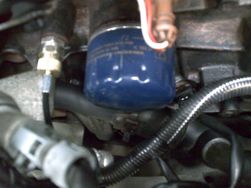

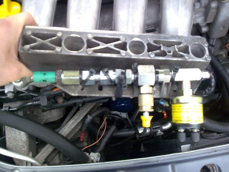

Heres my setup at the moment which needs tidied up a bit and ideally located somewhere else if i can reduce the size a bit..

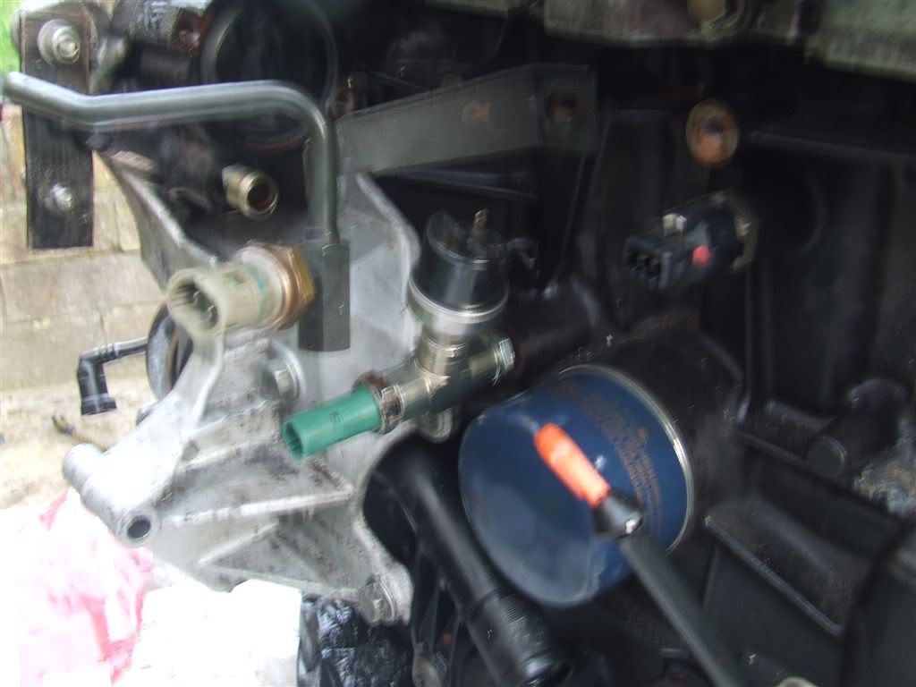

are you after something like this:
apologies for the blurred photo
Yeah Matteh, its something like that i'm after :)
I remember you posted a reply with that pic the last time i was asking about oil pressure gauges a few months back.

from pirtek, all m12x1.5 i think (or whatever the standard size is)
engine is in and doing well, theres a fair bit of clearance even in the mk1 bay - probably got about 2 inches between the end of the plug and the fan
not sure if the mk2 aux setup would get in the way though :S
the oil pressure switch isnt connected to the ecu, so it will be fine from that point of view

Sorry to crash the thread but you're first pic (Image025-1.jpg), what is that metal thing you're holding? I've seen it in a few pics... I dont have one in my engine bay. 😧
And yeah its the fuel rail guard

Any reason bar the extra cost these aren't used as a simple/easy solution? Any problems running them inline with the filter?
should be fine... only reason I used a t-piece off the pressure switch was because I was using a valver pressure sender
tempting then as an easier way to do it. That pic of D1cky's with all that stuff chained together is enough to put me off :p
