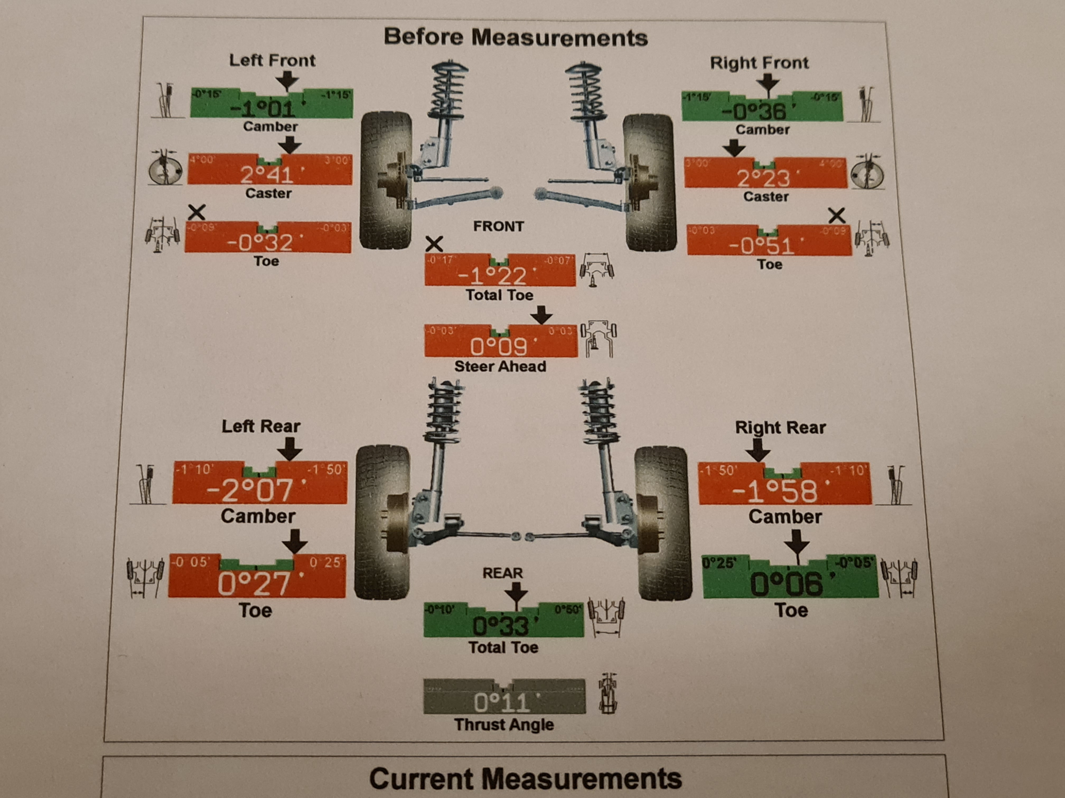

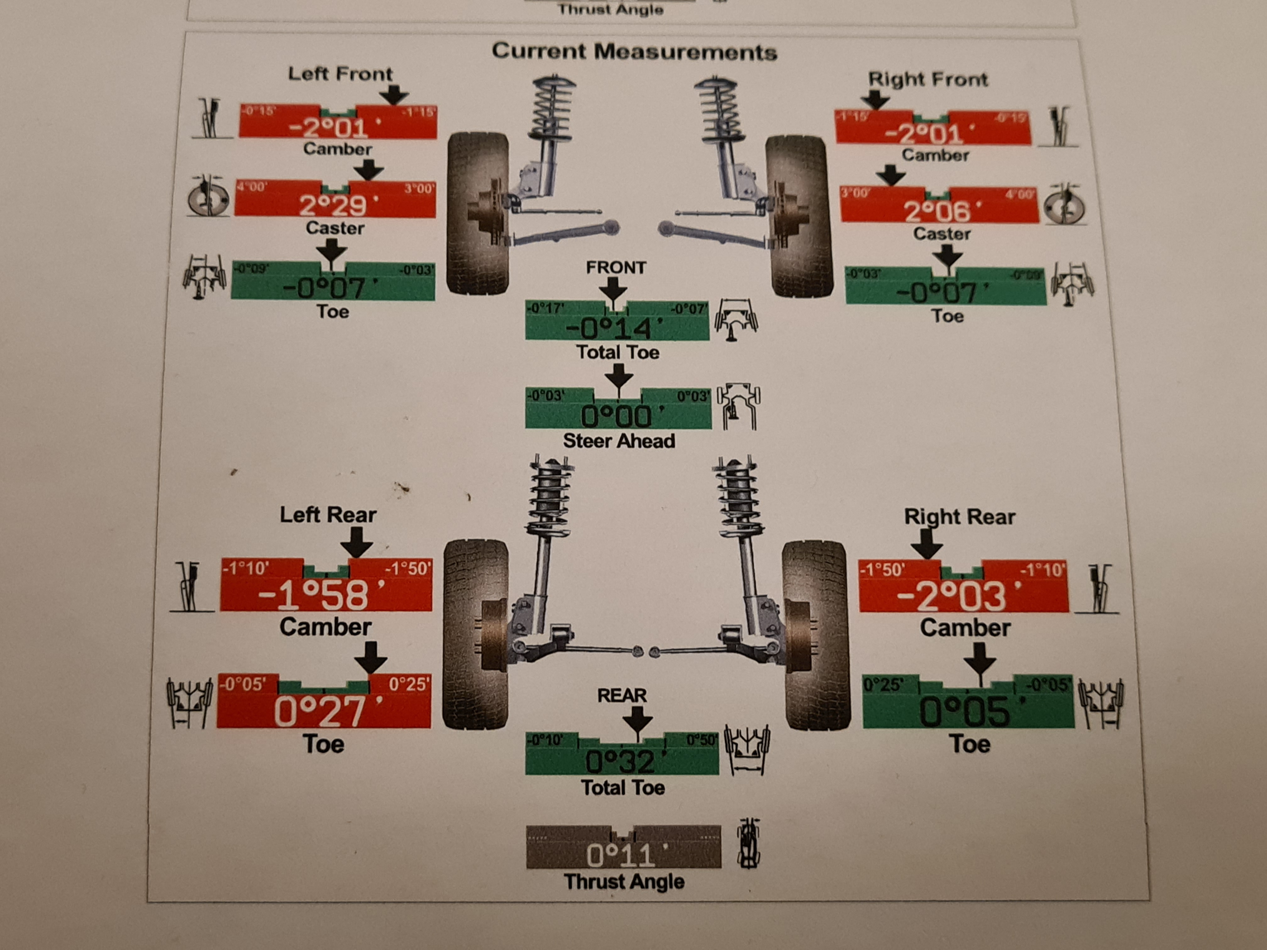

Well I've got a track day on Monday and needed to get the tracking sorted today after new track rods/end and camber bolts.
To be fair, Demon Tweeks booked me in within two hours and the guy doing the tracking seemed thorough and knew what he was doing.
£62 for just camber though, thought that was quite steep, but all sorted and it drives like a different car now.
Don't look at the NSR toe, that's a 10' shim fitted the wrong way, sorted that when I got home, should be around 0°9' now.
Before
After
