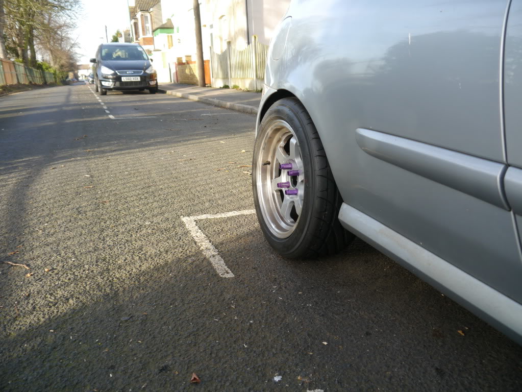

just fitted my rear bolts, just went for a drive and all seems fine, loads of loctite in holes and left for 2/3 hours to harden

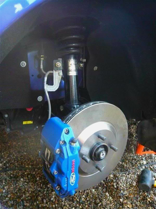

Ive had issues with the nuts coming undone when used in anger on the ebay/RD ones, so I swapped to harry hockley studs instead of the cheapy rally designs type ones, 3 times the price but never had a problem again since.
The hockley ones have a flange that butts up against the hub so you can tighten them upto it better, they have a wider section that the wheel locates on more positively and they have a lead on them to allow the nuts to go on better.
Only worth doing if you are going to be running slicks or really trying hard on semi slicks though.
Edit, found an image of the hockley ones:
