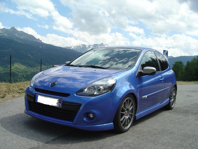

im an OEM kinda guy and have never owned a set of aftermarket wheels, however im looking for something for the GT as 1. its under wheeled and 2. its needing tyres soon!
ive pretty much set myself on OZ superleggeras as i seen this and like it...
what i dont understand is all the ins and outs with offset etc, now to me that car above needs spacers, but im assuming i could get a slightly different fitment of wheel that would save me needing to buy spacers in the first place? or am i wrong?

if you want to get the wheels stick out more you have 2 options:
spacers
or
a wheel with a smaller offset. For example a clio 182 wheel is 16" in diameter and 7" wide with an offset of 45 (ET 45 that is). a clio 172 cup has an offset of ET 38, so this wheel will stick 7 mm out more.
The car in the pic could do with a 10 mm smaller offset for example, or some 10 mm spacers. I recommend to gets some smaller offset wheels instead of spacers though
