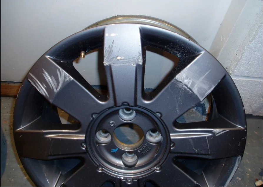

does anyone know any good filler or paint/ to do a DIY wheel refurb?

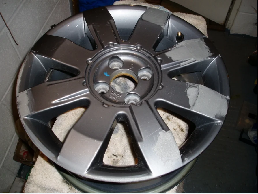

thanks, what filler would be best from paints4u and what grade wet n dry did u use on the filler?
thanks alot
Upol D Metallic filler . Halfords sell it in smaller tins , about £5.00 .

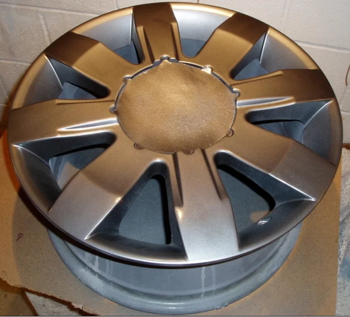

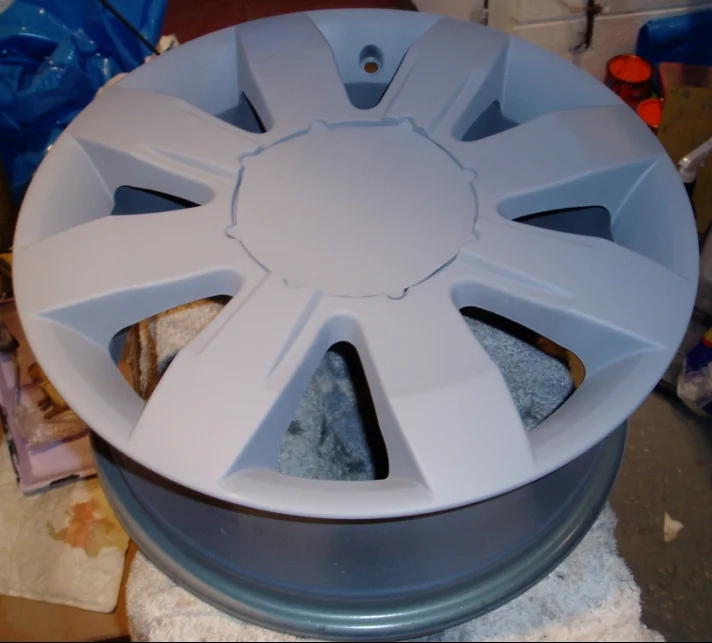

I used 320 grit , then primed it , sanded it , primed it until i was happy then about 3 or 4 coats of colour until it looked good , then 2 - 3 coats of lacquer .
Your better off getting your paint in rattle cans from a local body shop supplier or motor spares place where they will mix the paint for you . The nozzles on their cans spray better than the off the shelf ones from Halfords .
It probably cost me about £25 - £30 , can't remember exactly now . You'll have loads of filler left even from a small tin , so plenty left for future refurbs .
Its alot easier than you think . One of the main things is to keep the wheel clean after each sanding , wash and dry it well before applying more primer / top coat .
You don't need to sand the top coat . But if the lacquer is a little rough you can sand it with very fine wet n dry , 2000 grit , then use Megs scratch X and i will come up really good :)

The edges are easy to fix, get some filler, then paint them properly. But always remember to do all the prep work the right way and with patience. The first time i did it, I didnt feel like waiting, and ended up having the start all over again.
