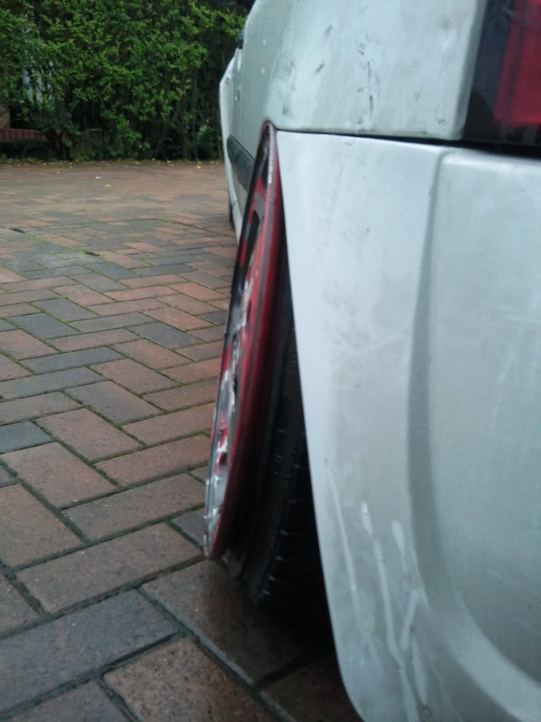

Hehe stu they had to be 40's otherwise the inside of the wheels would hit the coilover. And looking at that pic seems you had yours wound down quite a but more than mine ;)
yeah the 30s on mine just cleared! and my coilies were as low as theyd go! only vmaxx though! so ule have plenty room on the fks ;) haha
^^ lol maybe it will go lower in the future, but it's low enough for now I'll see when I get my soft rubber splitter ;)
And with those front tyres it's lower now at the front then when it was on 15's lol.

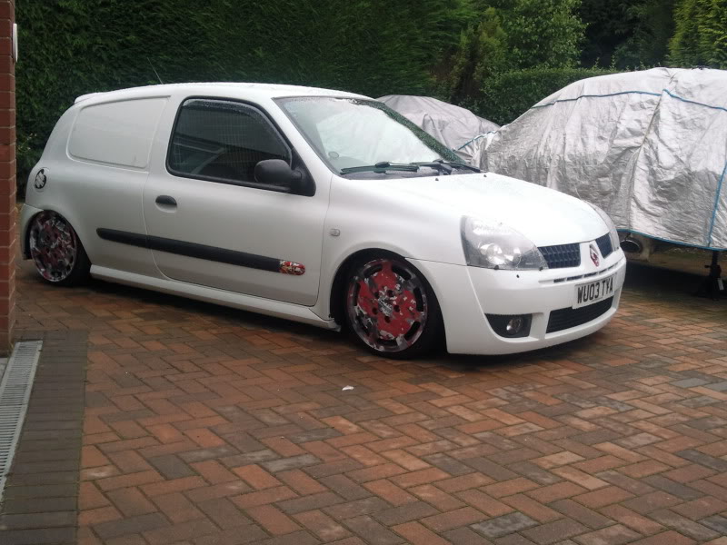

Btw wheel specs are
Porsche 928 s4 wheels
Fronts 16x7 et 65, with 40mm adapters, with 165,40,R16 nankangs.
Rears 16x8 et 52.3 with 20mm adapters, with 195,45R16 (can't remember brand)
