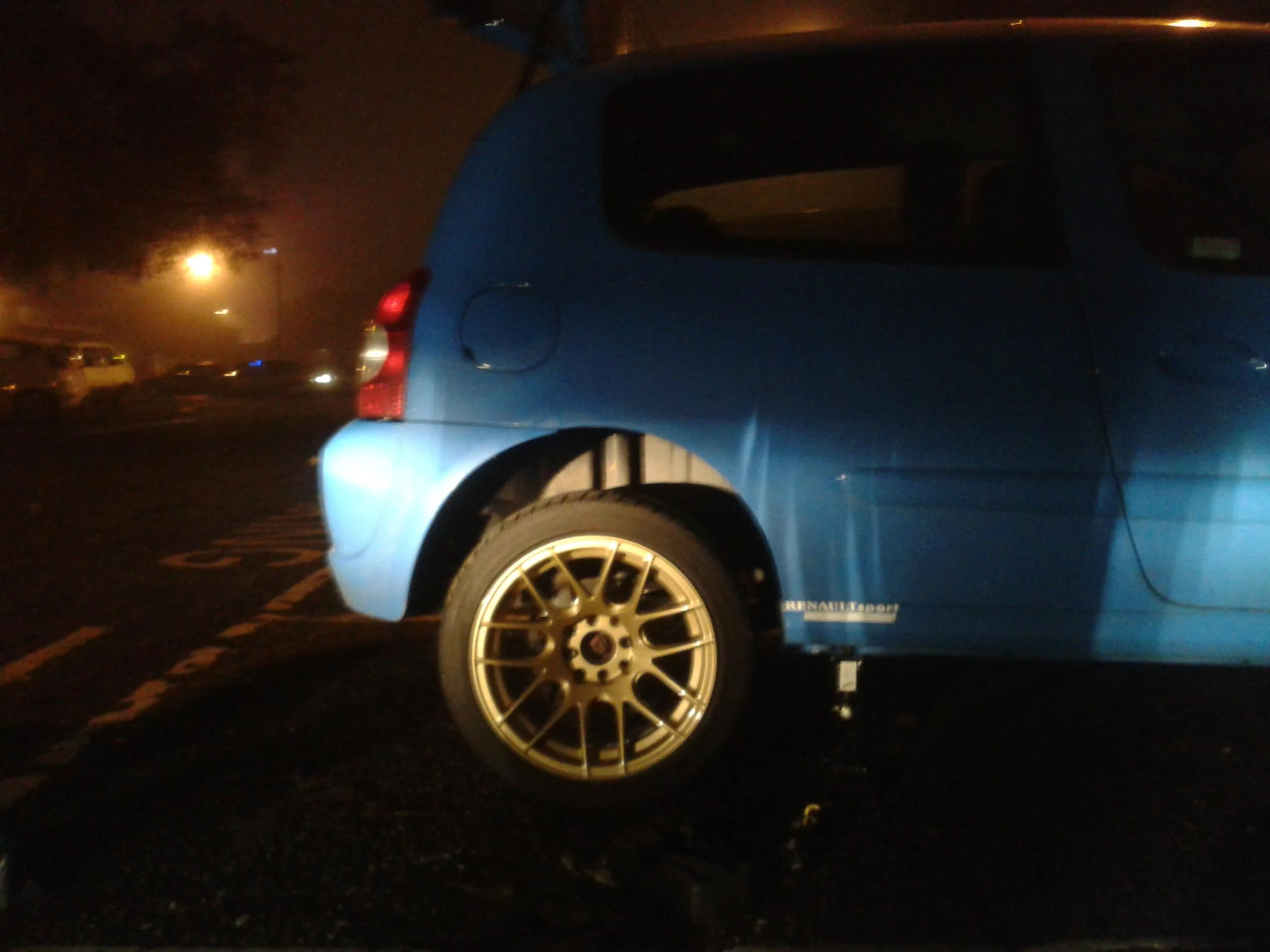

what do ya think then? these are the ET0 ones but this was a trial fit on a jack to see what they would look like
