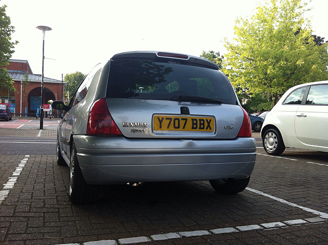

Am I right in saying your 10mm blocks are fitted between the Hub and the beam axle - hence you can use standard wheel bolts ?
Jekyll
It looks like I run camber on that pic, but I don't.
You can also see the front wheel spacers at that angle which are spot on IMO. Spaced out but just a little tuck into the front arch is just right. In line with the arch looks too much unless you run camber.
