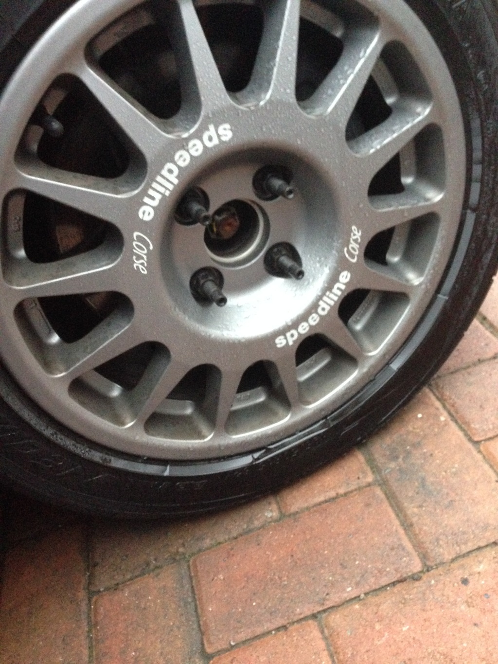

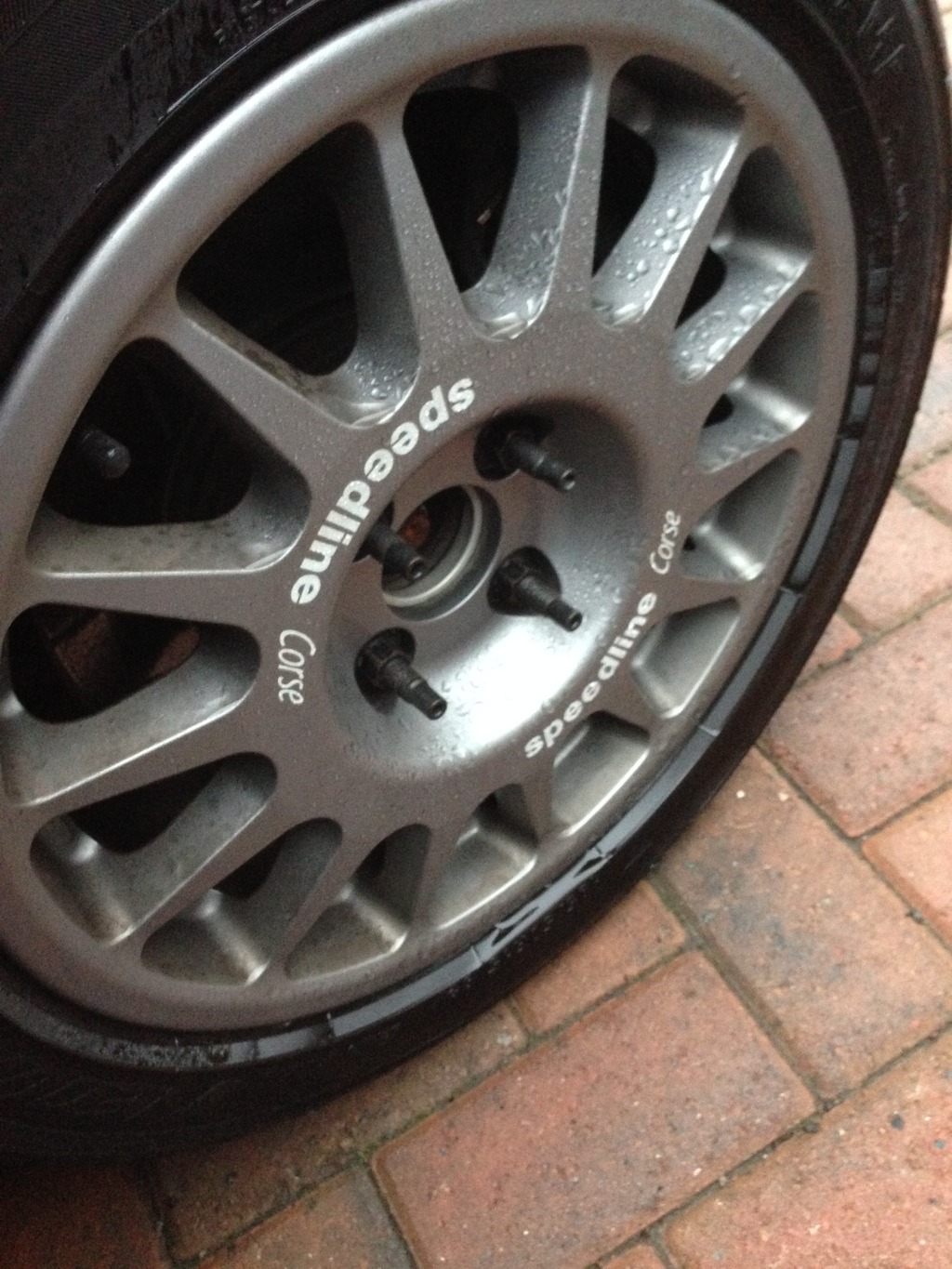

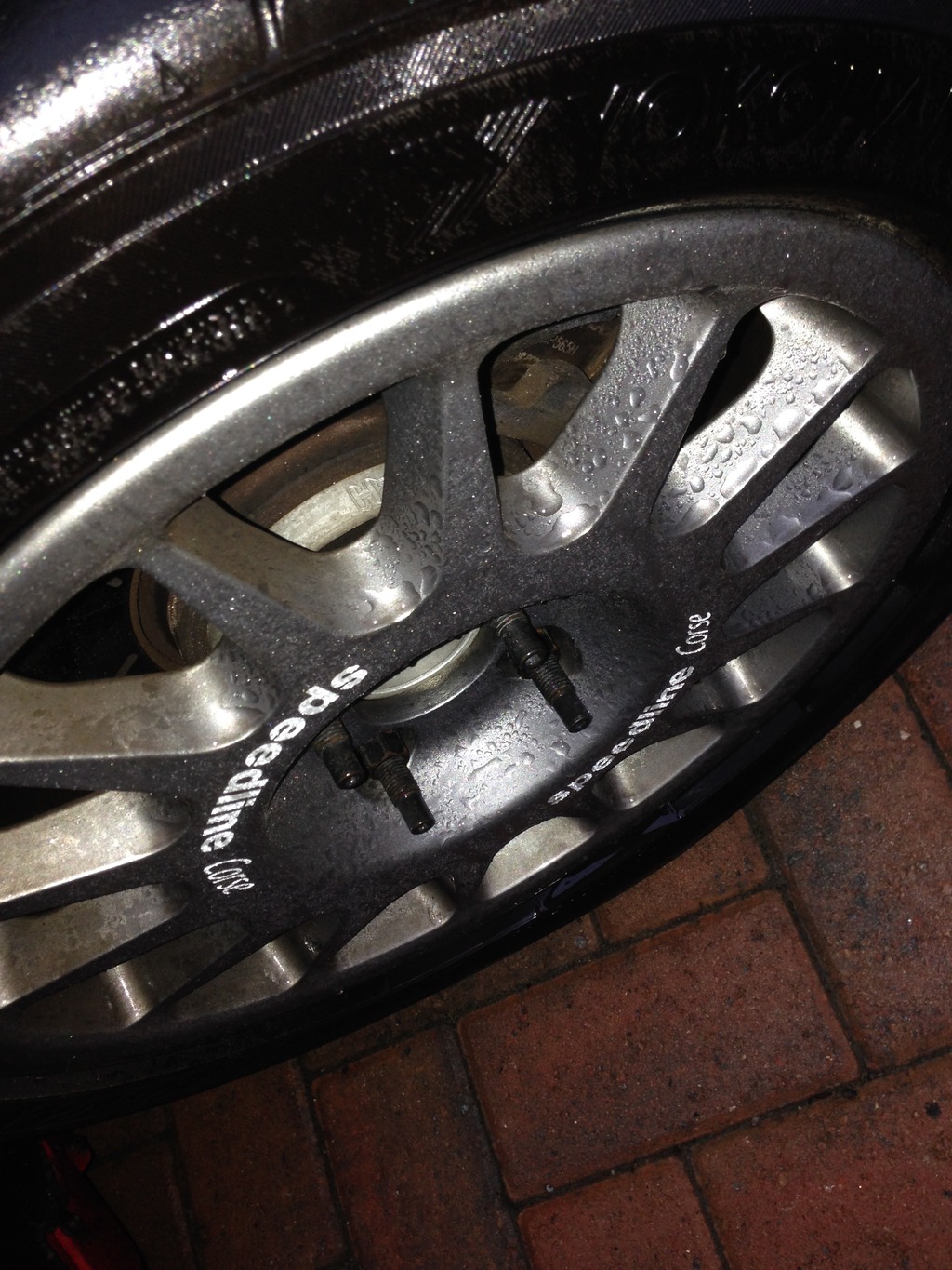

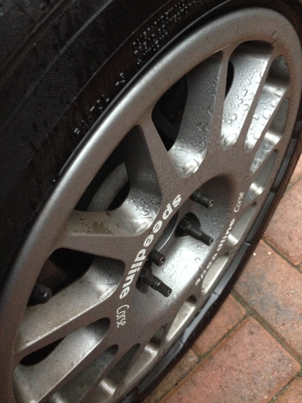

Have a look at my old PH1 as I had H&R 20mm bolt to hub type hubcentric spacers. Excellent bit of kit, perfect size, great quality and didn't look ott. Intact I wouldn't buy any other. Intact I'll be purchasing them again when I get another Clio.
Yep - 20mm bolt to hub spacers here, with a PMS stud kit attached.
Perfect! That's what I want to hear! Can you PM me a few pics when you get a mo please Tim?
Tim.
I grabbed these quickly before I left for work this morning:
Jekyll
Thank you kindly Tim. I can see that you have H&R spacers and as you mentioned earlier, they are the bolt to hub/dra type. That's exactly what I'm wanting to do so that's perfect :smile:
