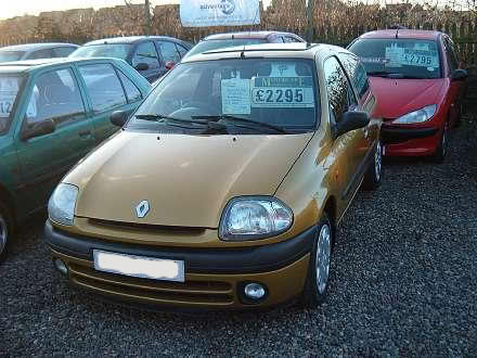

Just picked up a clio this evening:
1.4 RT
Just wanting to know what wheel sizes can fit this model/mk
the PCD and offset
and how far it can be dropped over these sizes!
also...
What higher models of the same mk have sportier bumpers that would be a direct replacement?
more the rear bumper really and lower front splitter
{and pics of the above if any-body has some please}
Thanks, Kol!
