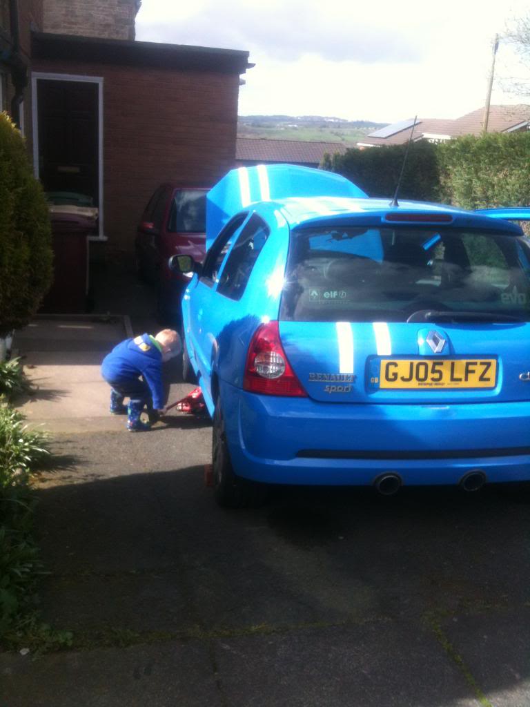

It's had a few niggles since, it's shed it's cat to centre section bolts twice in two weeks which is a little strange, the exhaust tips need a bit of a tweak to get them protruding beyond the bumper to the same level and the oil warning light came on once despite the level being perfect. Think it may need a new pressure switch. There's not too many plans with this car other than improving on its already good condition. The stripes need re-doing as they're peeling a little, I'd take them off but the wife likes them, so I've got a pal who does tints and vinyl wraps sorting that (These guys if it's of interest: https://www.facebook.com/WrapsAndTints). It could do with an alloy refurbing and I'm going to try to pick a FF rear bench up. Beyond that it'll get a K&N filter in the standard airbox, a good paint correction and all's good for now.
This is my 3 year old jacking it up for me to fix the exhaust again, might as well start em young:

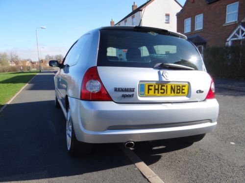

So, onto Clio #2.
I saw this car on eBay last week and it was around the budget I wanted to spend. It's got a lot of miles, nearly 122k, but it has stacks of history. I figured it was worth a punt and put a £1,150 max bid in. I won it at a little less than this.
I set my expectations that it was probably a bit rough and if I threw it away in a year or two it would have served a purpose and I'd have had fun getting a few track days out of it. I was wrong. It's much nicer than I expected. The paintwork has had plenty of attention and it's really nice. A previous owner worked in a bodyshop so the Renault Diamonds, mirrors, rear washer surround, rear bumper insert and bullets are all a lighter anthracite. The interior has been converted to blue back-lighting which looks nice but the steering wheel is missing a grip. It's also got a worn driver's seat and some damage to the dash where a phone holder has been mounted. Not the end of the world though.
The owner knew Fred from BTM through a friend, I'm led to believe, and it's just had new brakes, it certainly stops well. Struggling to justify changing them already for some 4 pots I've been offered. The biggest surprise though is the engine, it pulls like a train. Fred mentioned when he shared it on Facebook that it was a quick one and he wasn't wrong. It does not feel like it's done the mileage it has and it's noticeably quicker than the mapped, lighter, 182 Cup. Can't figure why but even the wife noticed the difference.
This won't stay as civil/standard as the 182 but it's having to be done on a budget. With two cambelts due this year, two holidays and a house purchase I best be careful or risk divorce. The main faults are a very slightly leaking front shock and a split in the resonator box that I only found while giving a good once over at home. The exhaust is a customer job but joins seem to be a similar position to standard. Really torn on what to do with this as I'd like to swap the whole thing for a recessed (as the bumper has been cut slightly for this pea shooter) but it's not a priority, may have to just weld it up.

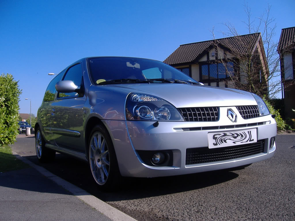

Well after a spirited drive a couple of nights ago the exhaust centre box has pretty much bitten the dust, it's opened up a bit and sounds terrible. Tomorrow will be finding somewhere local that can crack some welding gear out and replace the box or put a straight pipe in.
I also ordered a green cotton filter to have a go at a custom filter setup as I hadn't found a reasonably priced K-Tec style one. Typically within 30 minutes of ordering it I found one, now have two filters on the way. Might have to look at the custom setup on the wife's car using the standard lower Ph2 airbox, modified lid and enlarged hoses. Probably not onto anything knowing these engines but like something to do.
Also due a full alignment check, had a hairy moment in the car last night and lost the back end at not quick, but brisk, speeds (below the speed limit I must add). It resulted in me going backwards down the road and needing a new pair of trousers. If I was alert I'd have caught it but was talking to my son. No damage but found the tyre pressures were pretty high at the back, over 35psi, so figure I best not leave simple things like this unchecked. Tyres now down at 30psi.
Well over the last couple of days I've managed to get a few bits sorted out on the 172. First up was the exhaust, it was sounding dreadful to put it bluntly. I went across to a reasonably well know Ford specialist who did some custom work on it. They'll likely be doing the belts as well, the owner's had a 172 himself and has done a few of them (they're more known for putting Focus RS running gear into Transit Connects though lol).
Although I was contemplating ditching the mid-box entirely I went with another one. Glad I did as it's loud enough anyway it turns out. Wasn't just the mid-box though, the exhaust had 4 leaks overall! The cat had a small crack that was welded up with it not being too bad, the join to the mid-box was gone, as well as the box itself, and the rear clamp was well past its best.

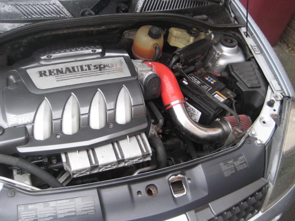

I also got round to fitting the home-brew "K-Tec style" induction kit. Bloody hell it sounds good, it's pretty loud on full chat, beyond 5k and doesn't sound a million miles away from like it's on bodies (shame it isn't).

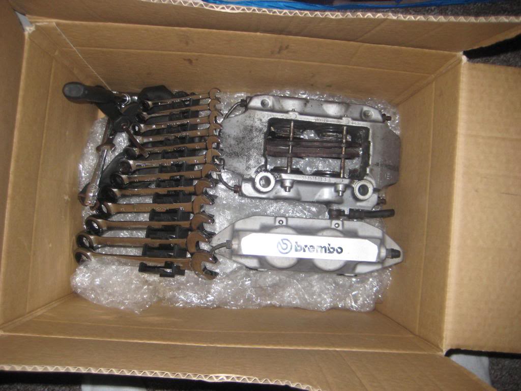

Also purchased a set of 197/200/etc Brembos in silver (nice and subtle ;)). Need to sell a few remaining parts of my Saxo to free some cash up for the brackets, some pads and brake lines but they'll be on shortly. Decided to stick with a 280mm setup so that I have the option to use 15" wheels if I wanted and can retain my pretty new discs. Will likely give me more choice of disc as well come time to change them.
The bleed nipples were in a dire state on one wheel as they look to have been fitted without dust covers but managed to get them loose with plenty of WD40 and the two spanner tick for some leverage. Going to get some new bleed nipples, pins and shims while I'm at it.
Any advice on fitting either welcome, especially the steering wheel, as nobody appears to know the washer size I'd need to fit it. I WILL do a guide on this as I'm surprised nobody else has on here.

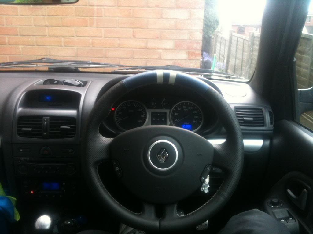

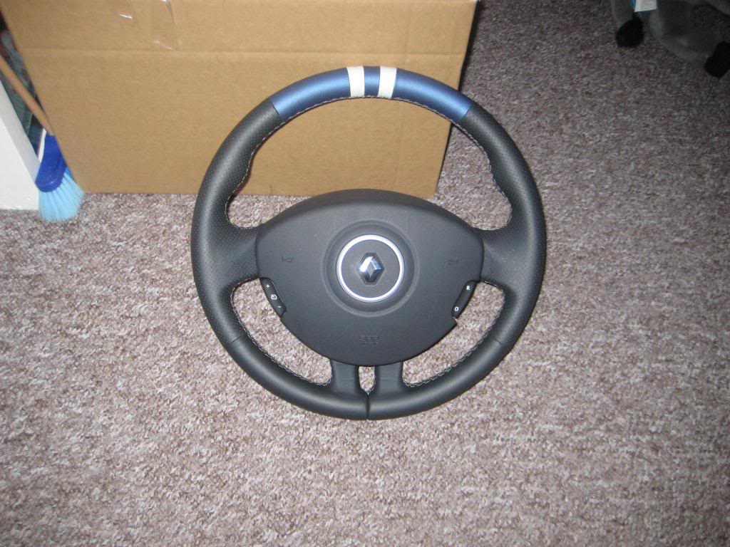

Fitting the 200 steering wheel was a bigger ball ache than it should have been and included more swearing than it should. The old wheel wasn't too bad to remove and the new one fitted ok. I meant to do a guide on this but was at my parent's house doing it and my phone battery went dead so no pictures. I'll give a run down below, it may not be how a "professional" would do it but this is just meant to be a guide, don't do it if you're not competent. The main points are:
1) Disconnect the battery!
2) Only a recommendation this one but I'd jack the car up to lift the front wheels off the ground. Makes checking that it moves freely easier as you don't need to drive it.
3) Turn the steering wheel through 90 degrees to allow you access to the clips that hold the air-bag in place. A flat screwdriver should prise the clips open easily enough.
4) Pull the airbag off, it'll need a yank, but be careful not to damage the wires by pulling too hard.
5) Once the airbag is off you'll need to disconnect the A and B plugs from the airbag, and disconnect the horn plug.
6) You'll need to use a T50 torx bit to un-do the bolt holding the wheel to the column and give it a yank to pull it free. Might be an idea to leave the bolt in loosely to save smacking yourself in the face with the old wheel. Probably hilarious to watch but not experience!
7) At this point you'll need to pop the new wheel on. Some people, me included, use a washer to stop the wheel rubbing on the cowling. It was a random one that I found so I'm sorry I can't give dimensions out, it could have done with being slightly bigger being honest. Then fasten the bolt. At this point check the wheel turns smoothy and centrally without any play.
8) Plug the horn back in and please test the horn at this point, I didn't, it wasn't working and it took forever to get the wheel back off.
9) Next up is to re-fit the airbag. The A plug (yellow and green on mine) fits the 197/200 airbag (in the A socket) but the B plug doesn't. You'll need a Stanley knife to trim a small locating section of plastic on the plug so you can connect the B plug to the C socket on the 197 wheel. They are all marked up A,B and C.
10) Push the airbag into the middle of the wheel, will take some pressure to get the clips to locate but at this point you're all done. Just remember to take the car off your axle stands and re-connect the battery.
I can't recommend testing what you've done along each step of the way enough. The 197/200 wheel is much harder to remove the airbag from, so that you can access the horn or to remove the wheel again, when it's installed. This is because the clips are top and bottom on the 197 wheel as opposed to either side on the 172 wheel. You'll either need to drill the underside of the wheel, through the rubber, or remove the cowling and fiddle for ages. I did the latter.
My horn isn't working now still but I've checked all connections, the circuit is complete so I think I have an issue somewhere else, I'd have saved an hour by testing this as I went though. Job for another day, might speak to the auto electrician I know.

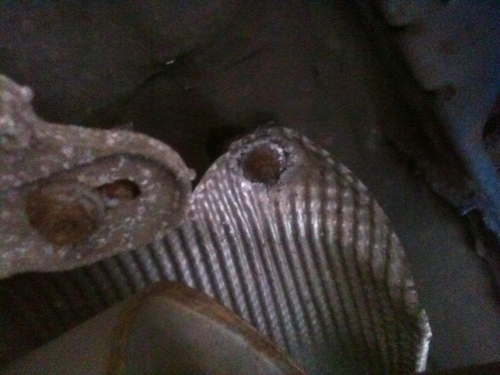

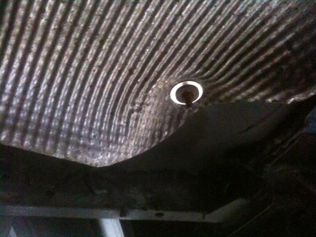

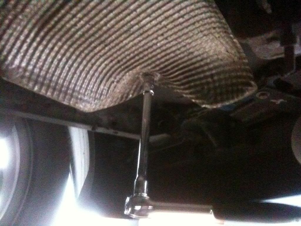

Well today's been a rare job on the 182. Wifey has been moaning that there's a rattle at the rear whenever she goes over a bump so it was time to investigate. Luckily I have a ramp to my front door that you can drive one side of the car up and make a natural little pit. Thankfully there was enough clearance to stick my head under and find the heat shield was loose. Usual case of it corroding around the nuts. I'll let the pictures of today's simple job do the talking:
The shield was like this around 3 of the nuts but only had 2 oversized washers. They went over the two outermost bolts, tightened up, and no more knocking. I'm liking these simple jobs for a change, it's rare that something goes to plan these days with working on cars.
  Beaten up 182
Lol, just did exactly the same on my 182, I bought these, did the job nicely.
