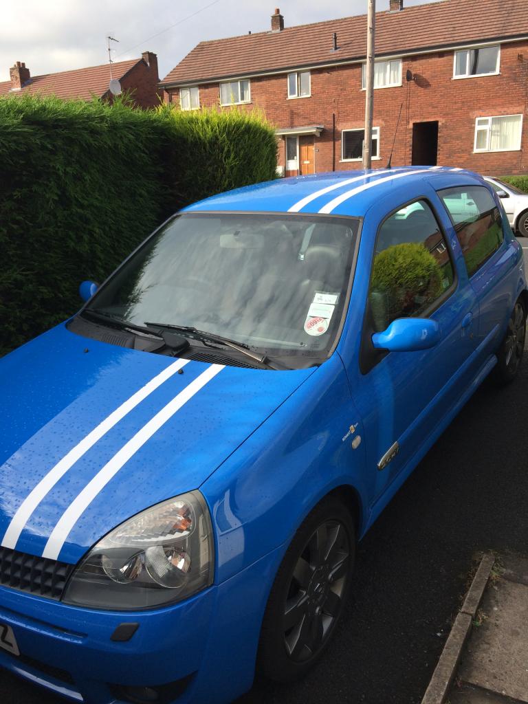

The 182 has had a slight change. The wife caved in to the majority opinion that hers will look better without the stripes so some hot water and 10 minutes work this was the difference.
Before:
After:
I don't dislike the stripes but I definitely prefer the car without them. Still needs some work on getting all the glue off and a paint correction, good thing I'm off the next few days then :approve:.

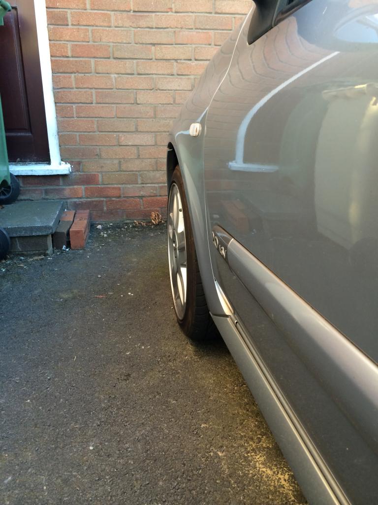

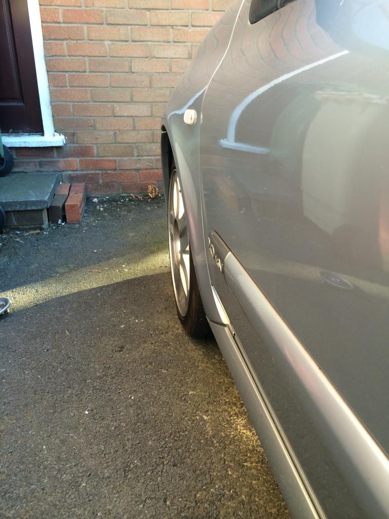

In addition to the stripes going from the 182 this weekend, I've now fitted the spacers to the 172 ready for the bigger brakes. Stance looks much better although the car still rides pretty high. Shocks are due changing so will probably look at the springs around a similar time. I'd go for coilovers but don't want too much of a compromised ride on the road and don't have the budget for a good set.

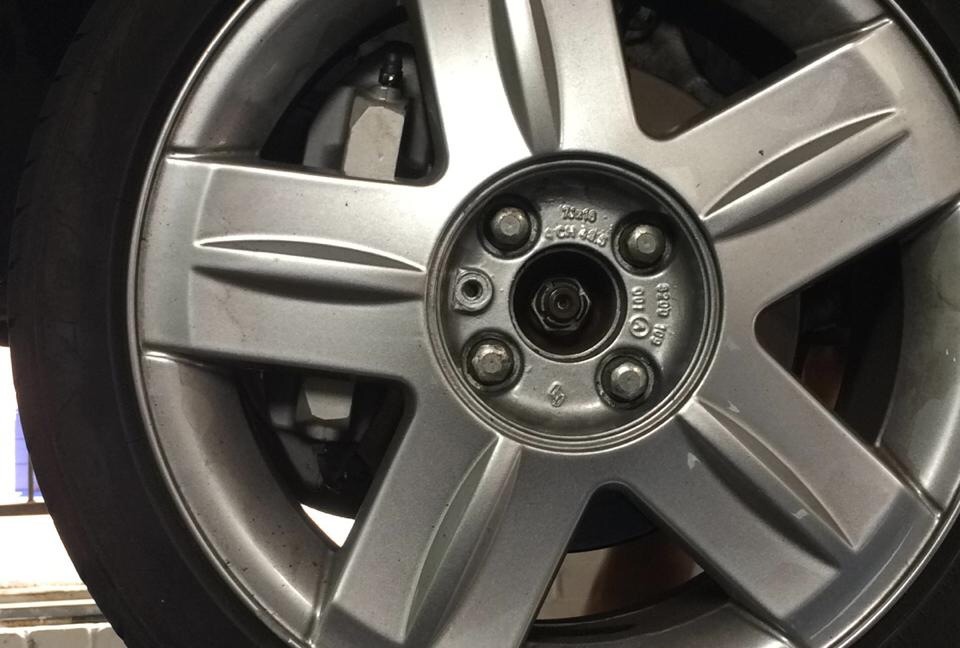

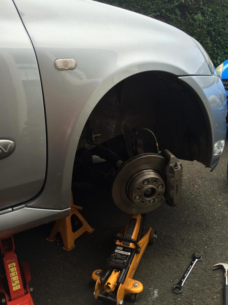

Well there's finally some updates in advance of Oulton next week. Had the Brembo 4 pots installed, new fluid and braided lines, an oil and filter change done, steering rack bushes tightened (still not right mind you) and the horn fixed.
Wasn't without its headaches though. We had a bleed nipple snap, a couple of stubborn caliper pins, two weeping brake lines that required adjustment, an incredibly stubborn oil filter and finally Steve from SC Autos is in the middle of moving the garage from one location to another. It took a bit longer than usual because of the move but they were a great bunch, very accommodating, friendly and knowledgable. Wouldn't hesitate to use them again.
Brakes are good, initial bite is good but the pedal travel is longer after initial bite. Considering getting a 197 master cylinder to combat this but that'll have to wait.

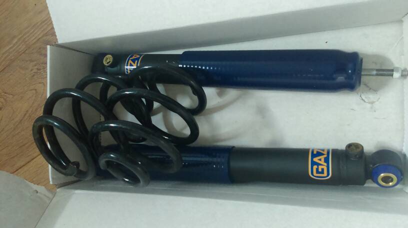

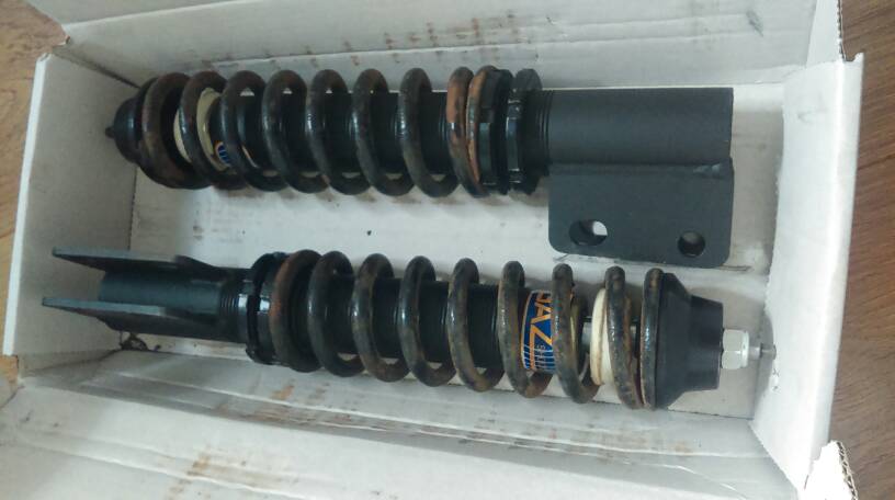

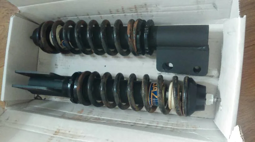

Next up was to sort the suspension. Was planning on keeping the car very much usable daily so was going to go with Cup shocks along with Eibachs or Cooksports, however, I then spotted these for sale....
Not exactly flush with cash after a holiday, two cars needing taxing, 172 broken, wedding anniversary, wife's, mum's and dad's birthdays all within a few weeks, but resorted to man maths and did a deal on them.

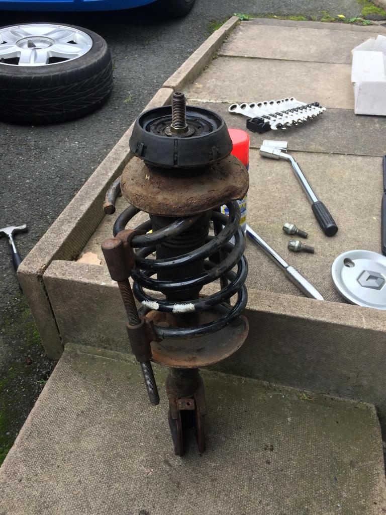

Went over to The Wirrall this morning to pick them up and get a head start on fitting them (car won't get taxed until the end of the week so not a major rush). Apart from the spring clamps being a general pain in the ass and a slightly stiff top mount I got the worst side off. The shock was in a pretty s**t state and the bearing has seen better days, some play and noisy...
That was about as far as I got as I've had to order new bearings and I had plans for the afternoon. Thanks goes out to @Andyrg@ ClioTurbo for the ABS pump, @Chi for the coilovers and the guys at SC. More to follow once they're fitted, but unlikely to be before the weekend. Might actually get back on track this year :smile:

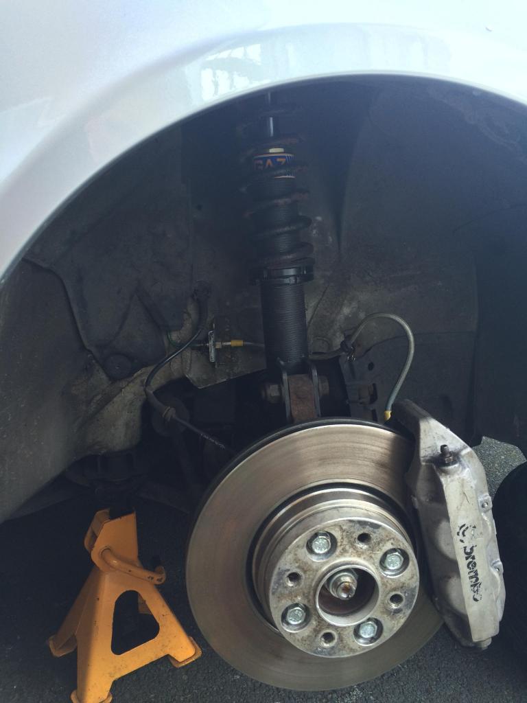

Only small updates really, I'll start with the bad news:
  • Pre-cat lambda (I'm pretty certain) is FUBAR. Runs like crap most of the time but the new one is due in a couple of days. Typical of it to go now.
  • Servo has been sourced, due tomorrow, thanks again @Andyrg@ ClioTurbo
  • Suspension issue still remains (albeit not as bad), but there's a bad knock when coming on and off the throttle. Have a feeling it may be the bottom ball joint on the offside.
Good news:
  • Front coilovers fitted (waiting on adjustable spring platforms from GAZ to fit the rear springs)!
(Two wheel bolts due to trial fitting the wheel while adjusting the ride height)

Hopefully after this week the 172 will be fighting fit. Busy day tomorrow as the spring platforms are here as well.
Well, the coilovers are now on the rear as well (pictures to follow when it stops raining) and I seem to have solved the knocking which was a loose engine mount.

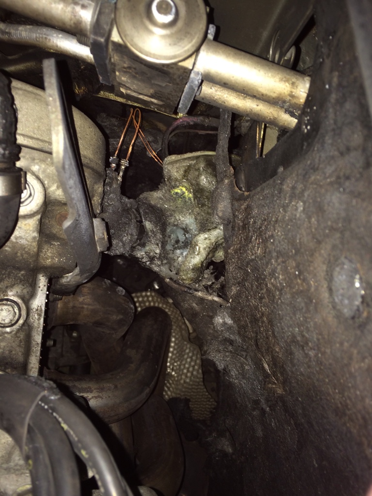

After the MOT, while the car was being driven to SC, the car CAUGHT FIRE! Still can't bloody believe it. Could have been much worse admittedly but the car isn't in great shape, looks fine until you open the bonnet.
So far the damage appears to be:
Inner arch liner
ABS sensor and loom
Fuel return line (the suspected culprit of the fire)
Servo
Master cylinder
Brake fluid reservoir
Some other wiring
Potentially the heater matrix
The other thing that worries me is how close the fire was to the cam belt. Even though it didn't let go I really don't trust using it now. All things considered the repair isn't small. It's not going to be a fun call to my insurance company in the morning, thankfully have protected no claims.

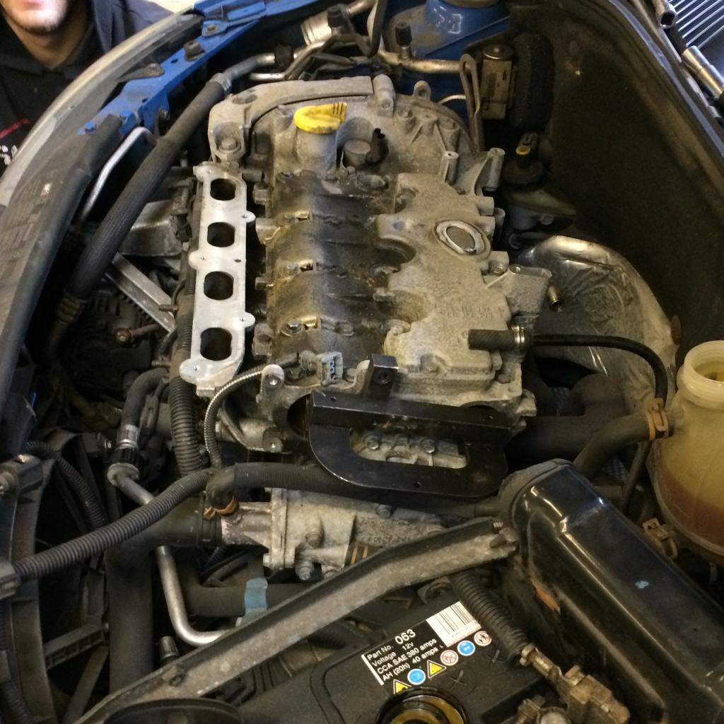

Unfortunately it wasn't as straight forward as I'd have hoped. From the moment I first drove the car I was adamant that the timing was out. Ste, knowing which specialist had last done the belts (according to the book and previous owner) didn't think it would be. In fairness both brothers and a good friend have used this specialist in the past with no problems. It was certainly out, you may be able to see it in this picture:
The timing issue had caused some issues with valves as the engine was reluctant to turn over by hand. Made the decision to take the head off and have the top end rebuilt. The cam cover had been leaking anyhow so it was an opportunity to sort this (don't have the final list of what was done so can't elaborate too much). It also needed a water pump, obviously the dephaser and other consumables such as plugs. Not a cheap few days but yet again I can't fault the effort put in by Ste and the level of help offered. Thankfully the power steering was little more than needing a fluid top up 😌
The car is now running better than ever, pulls much better and there isn't quite the same gap in performance that there used to be between the 182 and 172.

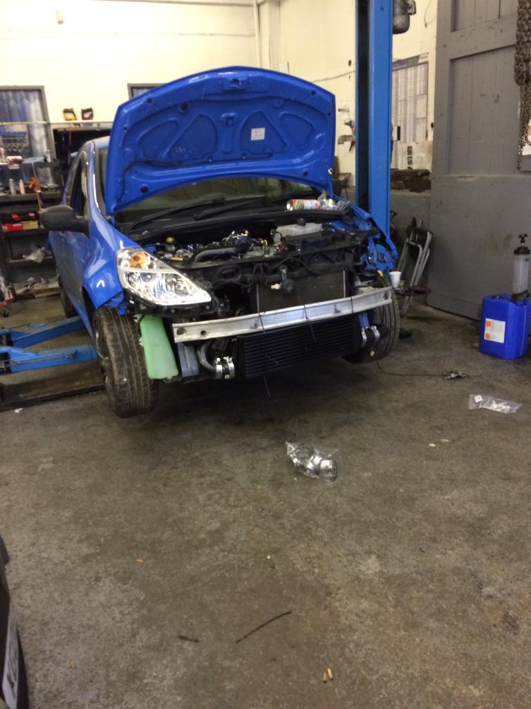

So I went ahead and booked a track day at Oulton for 31st March. Gave me a target to get the Clio ready for. I've done little with the 172 after the money I'd spent on the 182 with belts and all. Managed to put some money aside to sort the "need to do" bits out, namely the ABS delete, replace servo and master cylinder, and the fuel lines that kindly ignited the 172. I've also managed to get hold of a set of rough 182 Cup wheels that have some AD08R's on. The tyres aren't good for road use as they're on the limit but they were cheap and will do a day (or maybe two) and will be a spare set of wheels. Needed something as the rear T1R's are toast on my current set. Was due to book in with SC this week to have it up and running again.

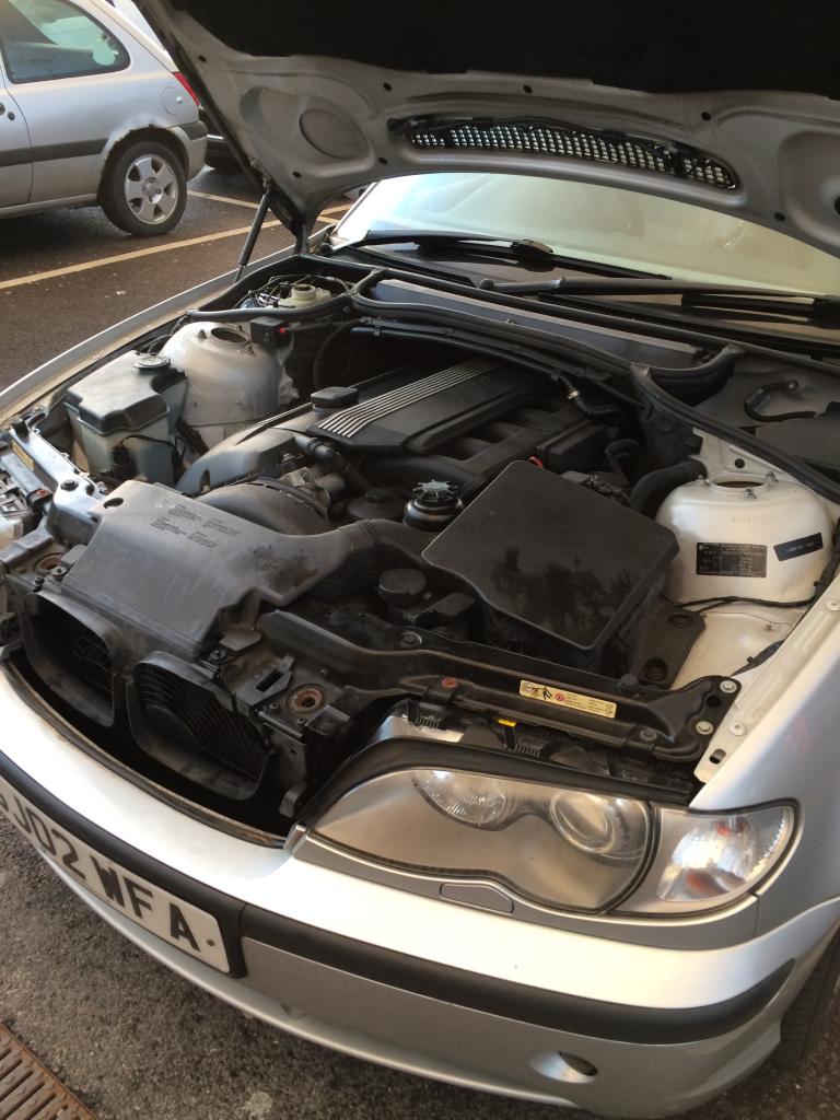

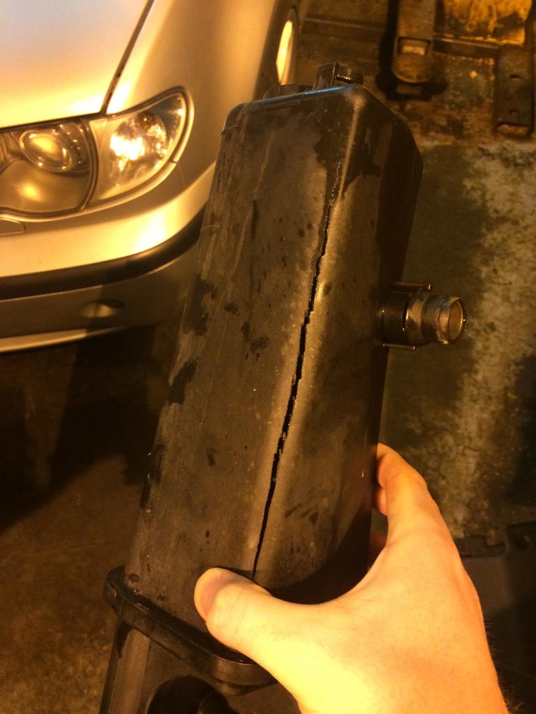

Unfortunately though my dire car luck of late has struck again and this time it was the turn of the German barge. And people say French cars are bad! I'd just driven a 450 mile round trip for a weekend in Scotland (which it coped with admirably) but while parked 1.5 miles from home, with the engine running, outside Argos, I heard a pretty loud bang/pop and initially thought someone had reversed into me. It was only when I saw plumes of steam coming out from under the bonnet I realised something was drastically amiss. I know the cooling systems can be troublesome on E46's so stopped the engine immediately, got out and stood in a puddle of coolant, opened the bonnet, concluded I could see **** all, swore, shut the bonnet again and phoned Green Flag.
I assumed the expansion tank had gone pop but the recovery guy reckons it's the radiator. It's currently at my mates garage awaiting diagnosis, handily it's a BMW specialist, and it may have spent my 172 repair budget. Currently in limbo between getting the 172 fixed or using the 182 instead for this first track outing to make life cheaper, will see what horrors tomorrow and a call to the garage bring :rage:.
182 -
The 182 has been a bit better behaved than the German, it's used a tad of coolant since the head was off but still running better now the timing's right. Will get it in for a check up though. Had it on the RR at EFI for the NW RR day. Was a good day out and it pulled 168.5bhp. Not altogether unexpected but still a little disappointing, still feels like a new engine. Will get the graphs up when I get chance. Need to get a manifold to cat fitting kit as well as the old fire ring fell out not long back and the bolts are past it, it's blowing over half throttle. Not many plans for this car short term but I'm sure an induction kit wouldn't go amiss, see if it helps free it up a bit.
Update on the barge -
It was the expansion tank, Tom 1 - Green Flag 0.
Now I know why it went with such a bang!
It's had a new radiator and thermostat recently which is good news, the expansion tank looked a little older and was a non-genuine. The pal who's fixing it has seen a few like this. Replacing it with a genuine part this time, which at £110 fitted isn't bad value and shouldn't dent the track prep too much.

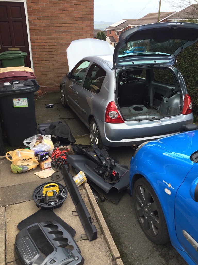

So this weekend I finally got round to starting things with the 172.
The rear part of the interior was stripped out, I collected my track wheels from the parents' house and I readied it for being picked up by the garage. Had to pump a couple of tyres up, free the brakes off etc.
Also appear to have sourced some 182 Cup wishbones that will be installed on the 172 in due course.
