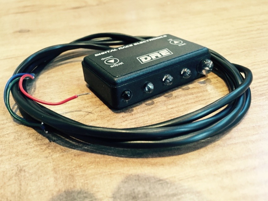

Well you need to find a ignition + and an earth point from around the dash area. The earth can be the dash bar basically, or anything metal that's attached to the bodyshell. The ignition positive needs a multi meter to locate, but there's one in the wiring for the wiper/indicator stalks.
The signal wire for the coil pack can be found at the ecu or the coil pack. You can take a pick of either pin 1 or pin 32 at the ecu plug. One wire is orange and the other is cream/off white.
Alternatively if you take it from around the coil pack DO NOT take it from the thick white wire. This is the 12v supply for the coilpack itself.
Once that's done configure the DRE shift light to work in 2cyl mode as it won't work in 4cyl due to only seeing spark signals for either 1/4 or 2/3.
Easy.

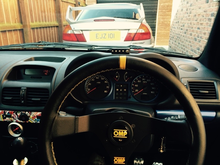

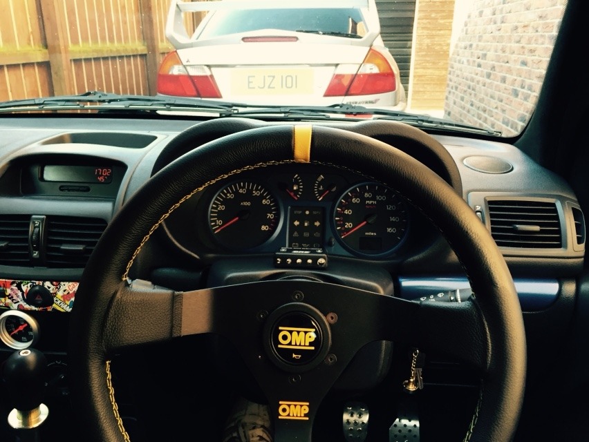

I'd like some opinions please!
The fitment shown by the two Marks in the thread won't work for me as it's obscured, so A or B
I quite like A but worried it's a bit 'in your face' and may be annoying/distracting as they're bright, is B the safer option?
Pics taken from ~ my eye line
A
B
M.C..
A would be the best as it is directly in front, don't worry about them being bright because when you are concentrating on the track they don't seem to bad, and you want to see them without looking down.

Position A
Set it up so that it only starts to come alight at the top of the rev range, pointless having green lights on at 4k.
Thats alright for joeys down at McD's, but you only want to know right at the top of the rev range.
Mines right in front of me, and tbqh i hardly notice it, but I do know when it starts to flash on red.
Position A
thanks Tony, I planned on the lights starting at 6k and going red ~6800 as I always change just before 7k anyway, does that sound ok?
Easy.
@MarkX @Mini182 this is what I posted further up the page about wiring the DRE shift light in.

Well it's fitted, bit meh about it tbh, not sure I like it, maybe come alive and be useful on track, but I find the LEDs hard to read on the road, but of a blur, maybe I need to start the sequence earlier or even later to run them together more......6100 to red light at 6800 and flash at 6900. I'll report back after my next track day.

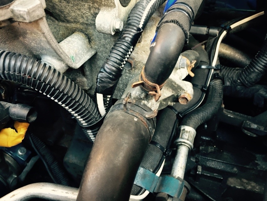

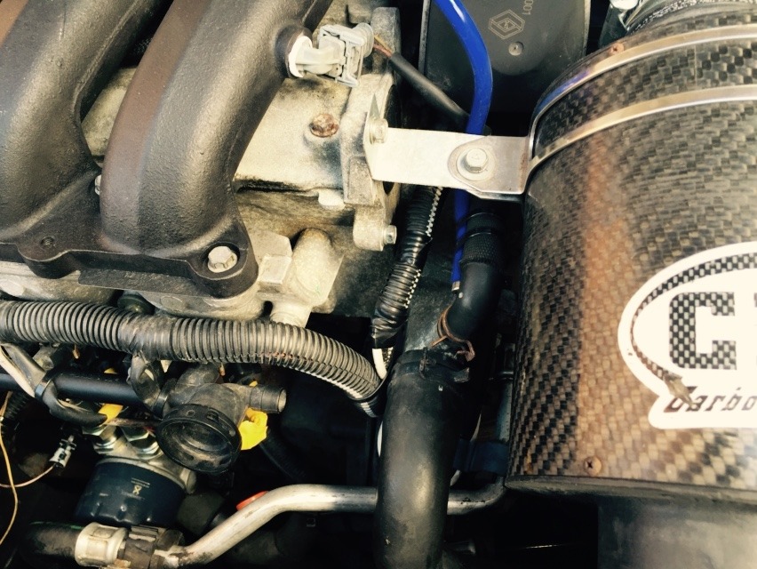

For anyone wondering about connections, I used the old +/- 12v from the head unit void, then ran a cable to the engine bay through the bonnet release grommet in the passenger foot well as per Mark, then tapped into the orange wire to the coil in this conduit...
