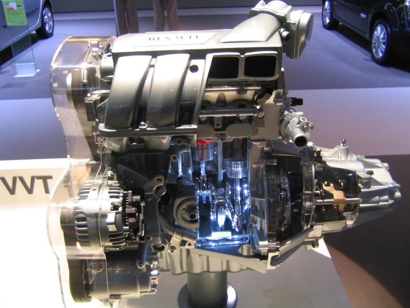

As per post title. The obvious changes I can see are the inlet manifold is very smooth, by looking at the cutaway from the British Motorshow,
and they have probably altered the map on the ecu against the 182. Is the 197 producing 158 lb/ft of torque now?
The main increase in power is down the the Remaped ECU and VVT.
I am sure that the change in the Inlet has helped a little, as will the Exhaust manifold, but most of it has been done through the ECU.
Just think all the money to purchase the 197 you could save the money, get a set of cams, matched inlet, decat, and a remap and be pushing around the same figure, if not a little more.
remember thats a "show" engine the inside of the inlet manifold is nothing like that on th production unit lol!!!
i want chromed crank and rods!
it'll be a rough texture inside
the amount of work that goes into tarting up those show engines is ridiculous
Yeah I remember speaking to some other tuners and they say that a mirror finish is never the best way forward. Its ideal to have a bit of texture inside to create turbulence or like a swirl flow into the inlet. Does this just apply for the combustion chamber or will it make a big difference to the actual inlet manifold as well.

The main reason im asking is that, people on here say it is very hard to get a real 200 bhp without using cams, standalone etc. So has the 197 had cam profile changes etc to get this extra power? Or is it just items that some of us 1*2 owners are having done, ie inlet match and remaps etc.
of course we do
higher comp ratio
better inlet
higher revlimit
different cams and constant VVT
chrome pistons ;)
Constant vvt? How does this compare to the 182 then? Is it right that the vvt starts working from 1650 rpm?
Will the 197 cams be a direct replacement for 1*2 engines being that they are all F4R's?
I would imagine the cams would be a direct replacement, but why bother when there are better cams out there eg BenR's current and new designs and Shrick
i have a funny felling that they'll have done something gay with the oilways in the cams which means they can't be swapped between the 700 and 800 series units, just a guess though
