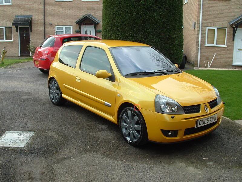

In the very corner of the bumper. They clip the bumper to the wing so that it holds the two tightly together and doesnt leave a gap where they meet.
On the inside of where i have marked the pic with the red square.
