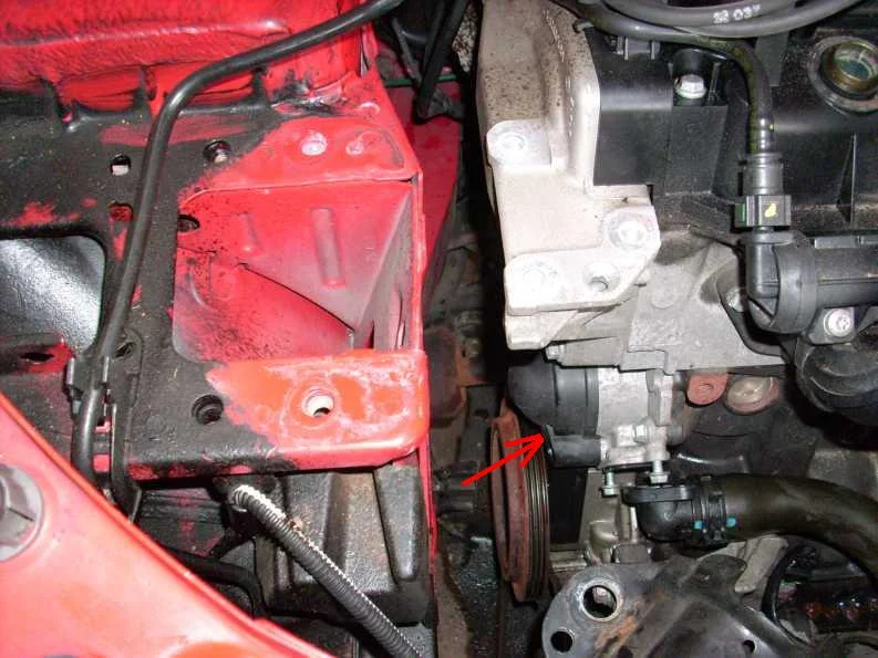

Where is the water pump on a 54 plate Clio 1.2 16v. A lot of people are saying it's the water pump thats grinding/rattling/making a dodgy noise. I was thinking of using a stethoscope or a screwdriver to make sure it's defo that. Where's it located? Preferably with a picture, and a arrow. Thank you.
Drivers side front of engine bay. Look at this site for a more detailed explanation, http://www.donkennedy.co.uk/Clio/Clio.htm
I did mine last week took about 3hrs including an oil change. Just remember to lock off the flywheel when undoing the crankshaft pulley.
