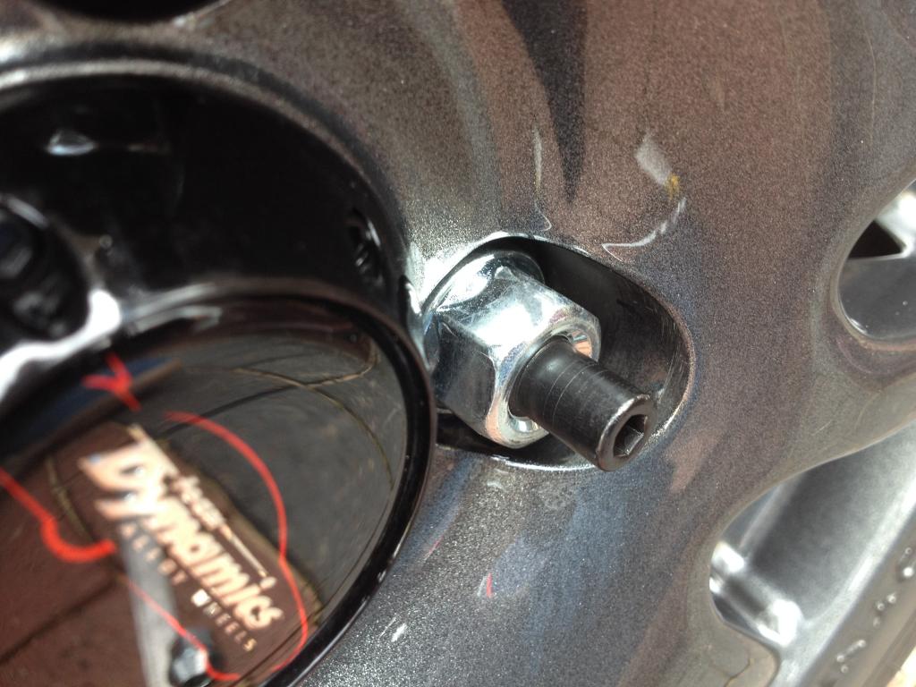

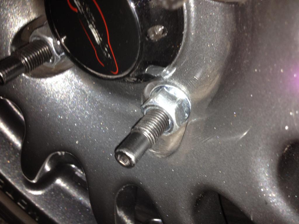

I use 82mm long studs on the front with a 16mm spacer (and no spacer with second set of wheels) and a 75mm stud on the rear both bolted into the hub (don't like the idea of holding the wheels on with a bit of ally)
and the front uses all the thread and the rear leaves a bit of exposed thread.
I don't use locking wheel nuts and I don't think it would be possible to fit them with this kit due to the bullet nose.
front
rear
