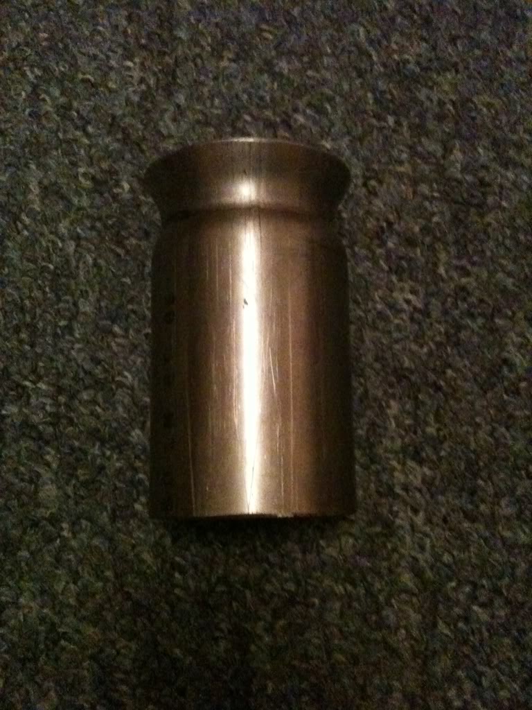

Just had it confirmed from Piper, the exhaust has to be cut between the cat/centre pipe join just before the centre box and sleeved, I've managed to get hold of this image...
No it doesn't it comes with a olive joint separate which slots into the centre section and is clamped then you clamp the joint to the cat.
Ah cool, I take it you have one fitted to your car?

Yeah I've got one fitted. Easiest exhaust I've ever fitted so straightforward. Old exhaust doesn't need cut to come off and the beam stays where it is.
I'm running mines with a de-cat but you can see the olive joint just slots into the centre section and can then be clamped to the mani
