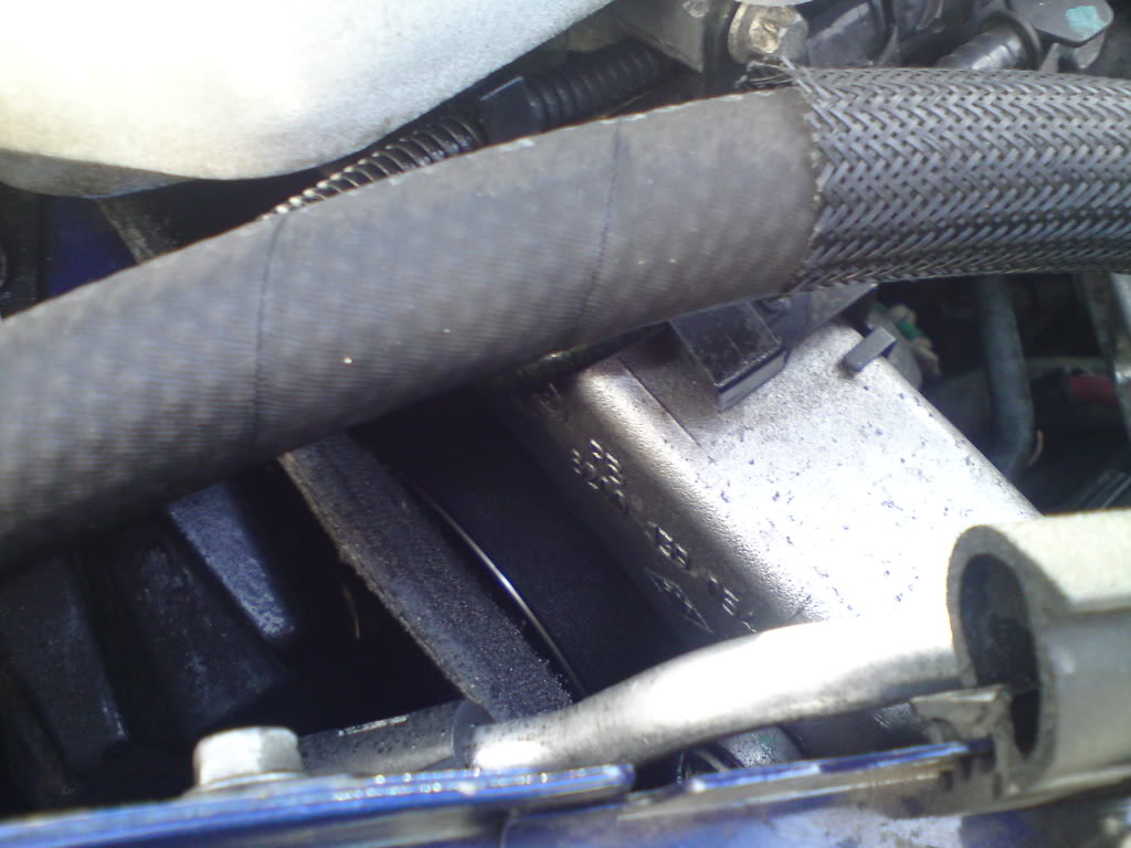

Got any pics of where the leak seems to be coming from?
i've seen the PAS pump seal fail pretty spectacularly on a couple of pumps in the last few months. throws all the oil out and then whines like hell. New pump needed is the most likely scenario
il put some pics up now, the bad thing is ive only had the belts changed about 4 months ago lol not nice
its just under that silver thing it has some metal pipe goin in to it, thats where i think the leak has come from not sure wat it is tho ??
