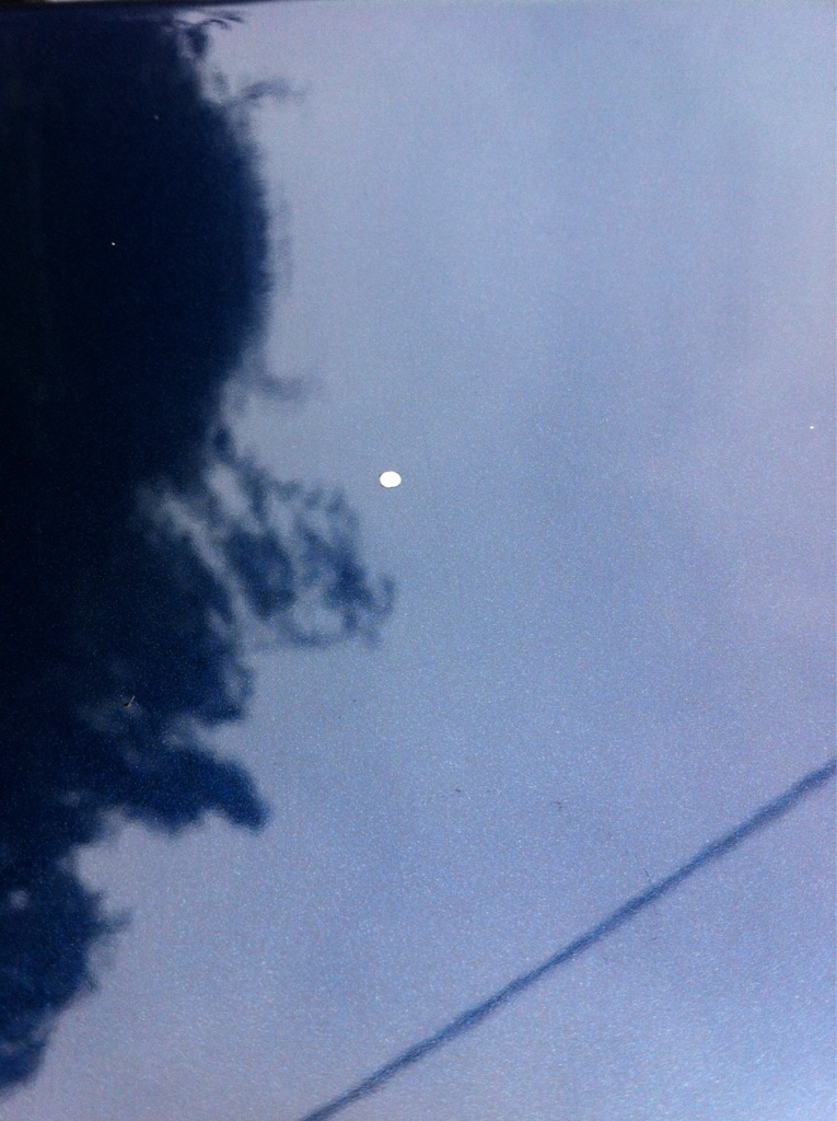

We've just picked up our new (to us) Fiesta. I've given it a wash this evening (one bucket and a sponge) and noticed lots of little spots of white paint on the bumper, bonnet and passenger side lower. I gave the bonnet a little go with some Super Resin Polish that were't int shed but no luck. The paint work is otherwise very good and Ink Blue is rather nice! Any ideas on the best way to get the white paint off?

Tar remover first then clay as necessary.
These are two things I've never done before lol! Any good value product recommendations? Will the tar remover help remove the white paint?

tar remover should help break it down then clay it to finish might take a while and a few hits to get rid tho
and check out auto finesse products highly recomended on here and click the link at the top of the page for the website

I found that tar remover took a LONG time to remove spots of paint from my Dad's car.
Clay did the job much quicker.

Tardis or Tar-x then bilt hamber medium clay (can use water as lube).

Looks like clay is the way to go...

As said id give it a try with Clay, Don't go rubbing too hard though, If it doesn't come off easily just give it plenty of light passes.
