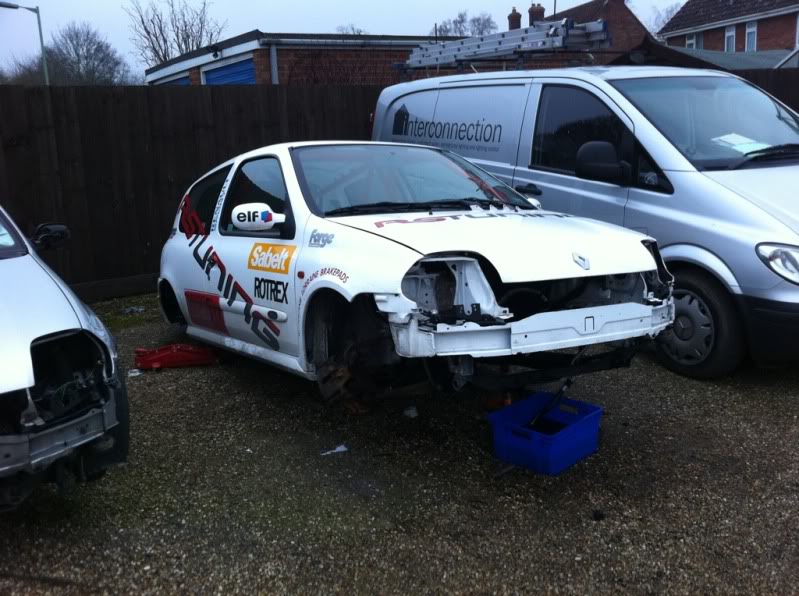

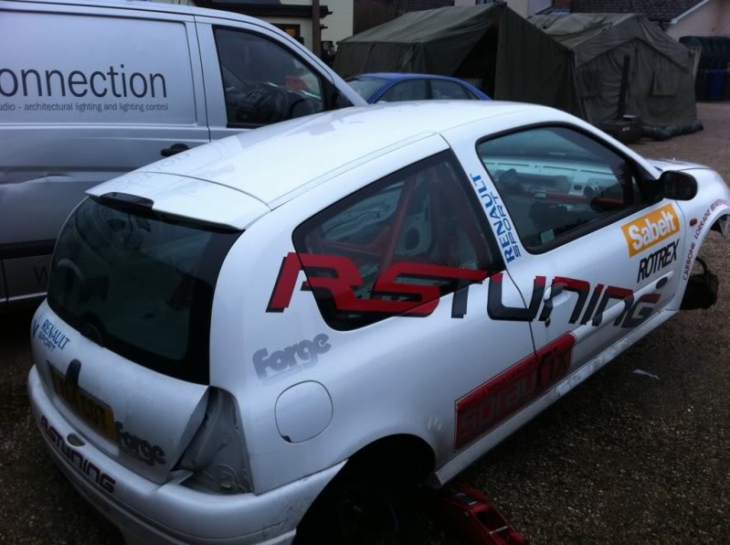

What's the history of the shell judging from the original pics was it pauls sc car ?
Ricardos
  LY 200 EDC
Just read from start to finish, immense work, done properly with some genuine attention to detail.
Yes it certainly was Paul at RS tunings old shell, i believe Danny bought the car off him. I don't know the goings on in between but this is how i came to find it when i went to view it for the first time. I had to think hard and long about taking this project on as it was quite literally bare and had never taken on something like this.

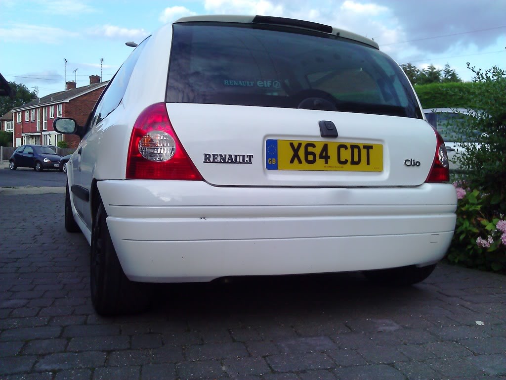

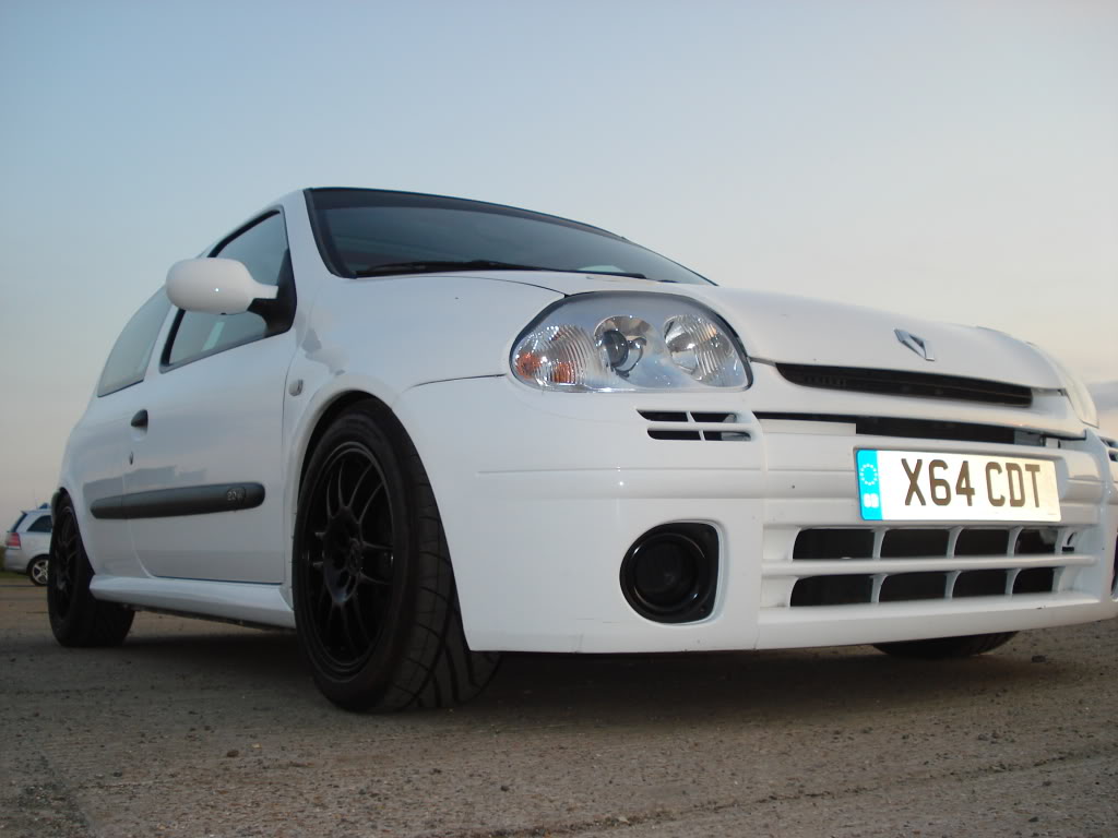

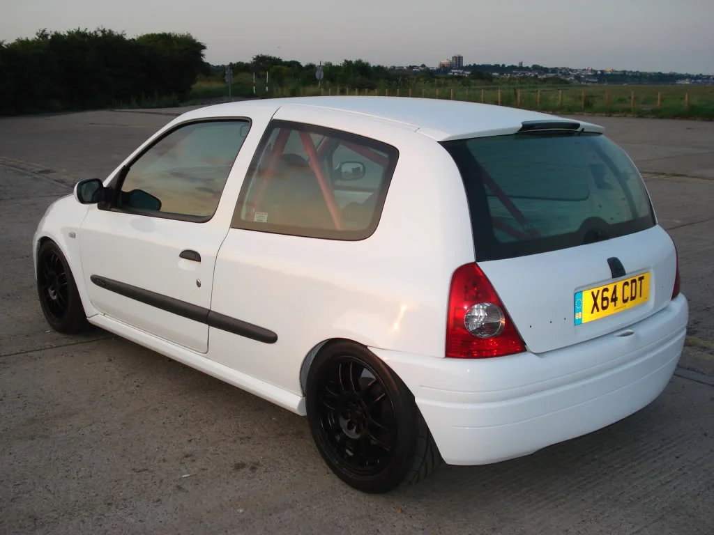

Ok, thought i'd do a little update as the Clio has been on the road a month now and covered about 600 miles, 260 of those were done last weekend on the round trip to Cliosort Saturday at Gaydon. Its given me the chance to bed every new component in and see if anything happens that i need to deal with.

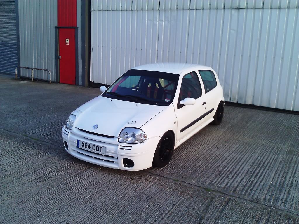

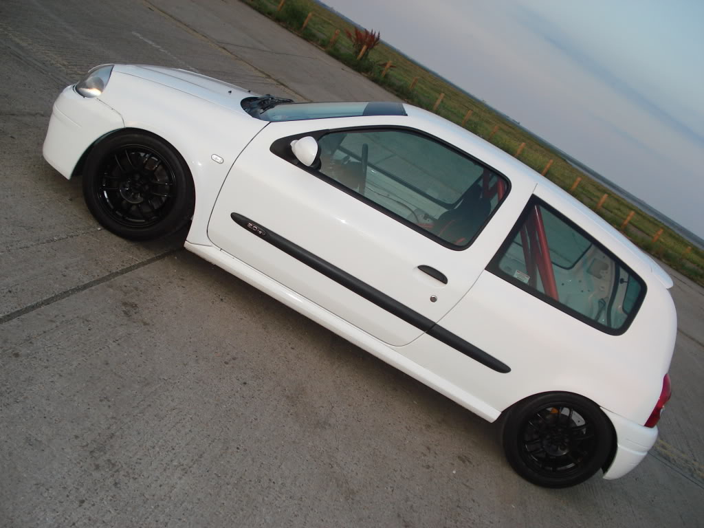

So, the maiden run out in the first week of July which gives me the opportunity to finally take some pics of the Clio NOT on the driveway! I'm really impressed with the final look of the Clio and can't believe it's actually made it off the driveway on it's own steam after sitting there for 4 months.
Now running on Shell V power and finally putting on some miles it feels really responsive with all the ingredients working together. Lightweight, AC delete setup (172 Cup alternator) matched inlets, decat.
Driving to and from work for a week gives me this

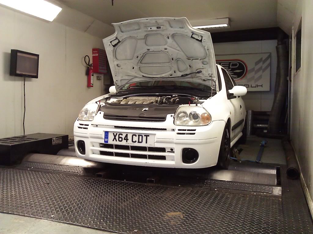

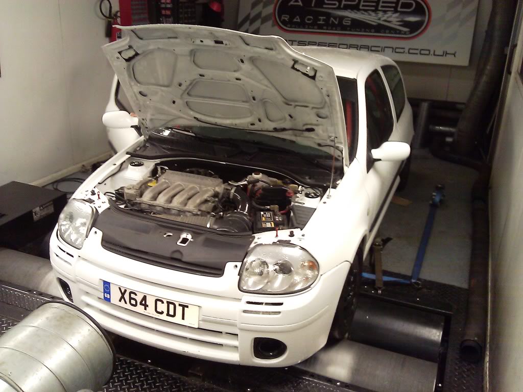

The next step to me is to get it on the rolling road to give me a powercurve printout so i book it in at the local RR facility quite literally over the road and a 3 minute drive from home. The BHP and torque curve indicate a flatspot, the next step i feel is a remap

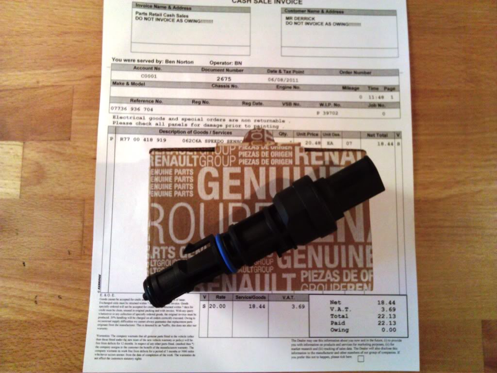

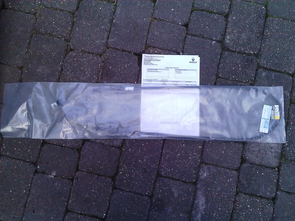

There's also the annoying problem with a sticking throttle, i'm having to blip the pedal to drop the revs down so i'm booking it in to have the TB taken apart to be cleaned, the ICV cleaned and a new throttle cable fitted. The speedo has also started to play up so i've also ordered a new speedo sensor from Renault so i'll have that fitted at the same time.
I also popped into the local breakers to sort some boot badges to finish it off, beats leaving the holes in the tailgate
So time to save for a remap and get it booked in on a trackday to really push it, then hopefully in October i'll be heading over to the Nurburgring.

Hey mate, great work on the project! From what I've read the throttle problem and speedo may both be related, and caused by the speedo sensor. Maybe try replacing that before stripping the throttle body down??
Ricardos
  LY 200 EDC
Yep, was told this too by a mate of mine who works for Renault. I'm picking up the new sensor from Renault tomorrow and will have that fitted as well as the new throttle cable. I'm gonna buy some carb cleaner for the ICV too.

Speedo sensor is picked up from Renault yesterday, for me it always pays to buy genuine parts cash allowing.

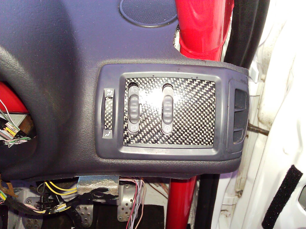

Wow, I really like this car! bet you're well chuffed with the end result?
I am currently looking at dashboard options for our car and thought about relocating switchgear to the now redundant air-vents too. Nice to see you have already done this and it looks/works well.

What power did it make on the rolling road?
Cheers
Power wise 172bhp, 142ft/lbs, i was more interested in the bhp and torque curves which shows between 4500 and 5500rpm a dip in power. As mentioned i think a remap would smooth it out and eek out a bit more power. The RR facility had 3 other 172s on their system and they all had less bhp. On the road the Clio feels really responsive
More than happy with the outcome.

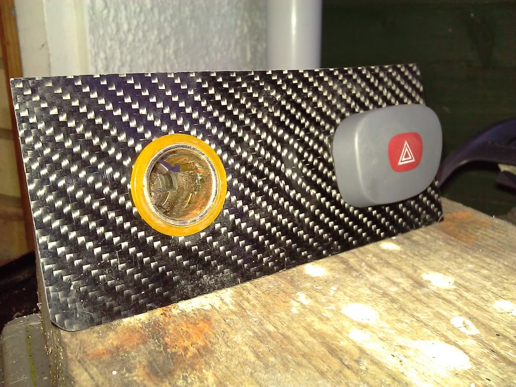

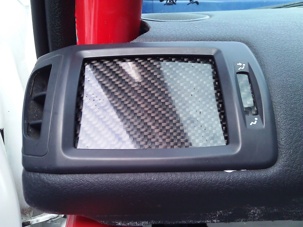

I always had the intention of putting the 12V feed and the hazard switch in place of the centre vents using carbon fibre. It was only when i needed to locate the headlight beam adjustment where the idea of fitting it in the drivers side air vent came, it seemed fitting to blank off the passenger side with carbon fibre to match the other vents

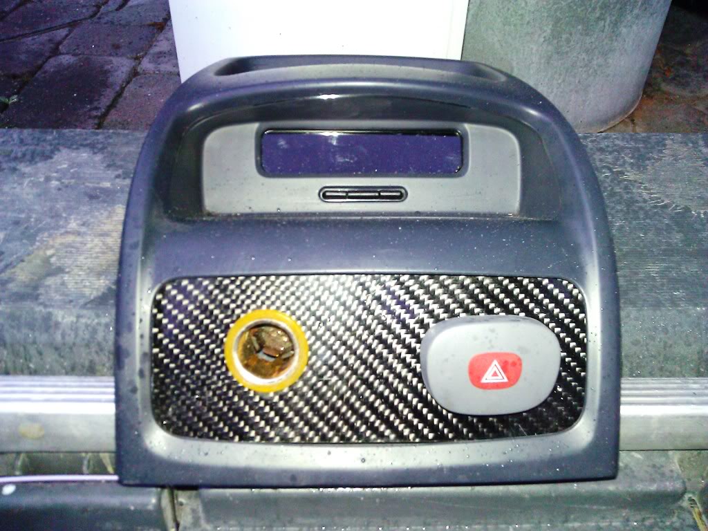

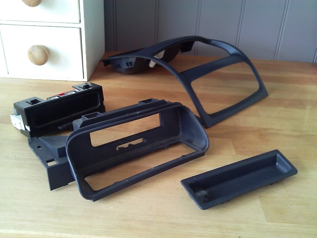

Passenger side air vent, just blanked off with 1 or 1.5mm thick carbon fibre
Drivers side air vent with headlight adjuster and dash clock dimmer, the whole unit is used and covered with the same thin carbon fibre sheet
Centre vents taken out and replaced with carbon fibre, this space is used to house the hazard switch and 12V feed
Ricardos
  LY 200 EDC

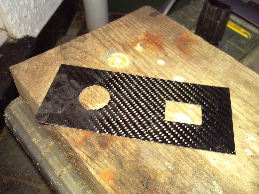

I need somewhere to mount my hazard switch, thinking about putting it where the clock is. How is it mounted to the carbon fibre?
My hazard switch is from the early 172 and it slots into a rectangular opening. When fitted in the 172 it slides in and clips into place, so i did the same and cut a rectangular opening in the carbon fibre for the sitch the clip into. The same goes for the 12V cigarette lighter feed.
This shows the dash centre in pieces, i took the dash clock body out but kept the glass and super glued that back in. There's nothing left behind it all as it's not needed

Where do you get bits of carbon like that? Was thinking of doing somthing very similar in mines.
I was lucky and was given a 500mm square sheet to do what i want with and gave the rest back. I imagine motorsport places do it, E Bay??
