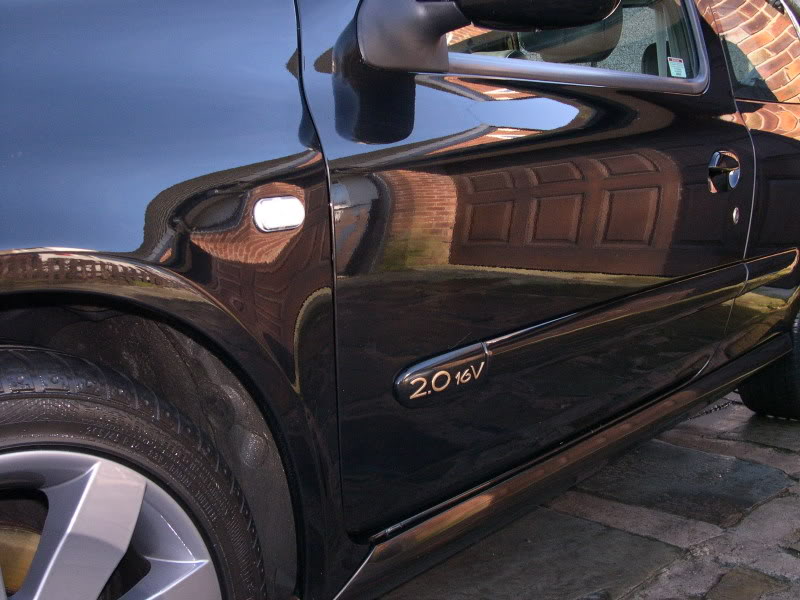

i've just finished doing mine :) i managed and i'm s**t when it comes to spraying.
i used a plastic primer after a quick rub down :p
then colour coats which i left to harden
then using a touch up pen of the right colour i hand painted the lettering.
then a couple of coats of laquer. job done!
