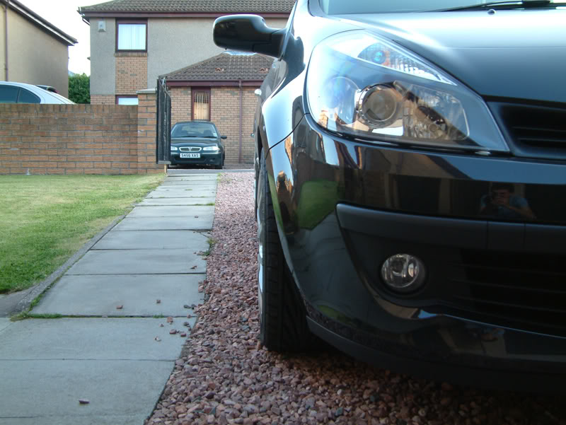

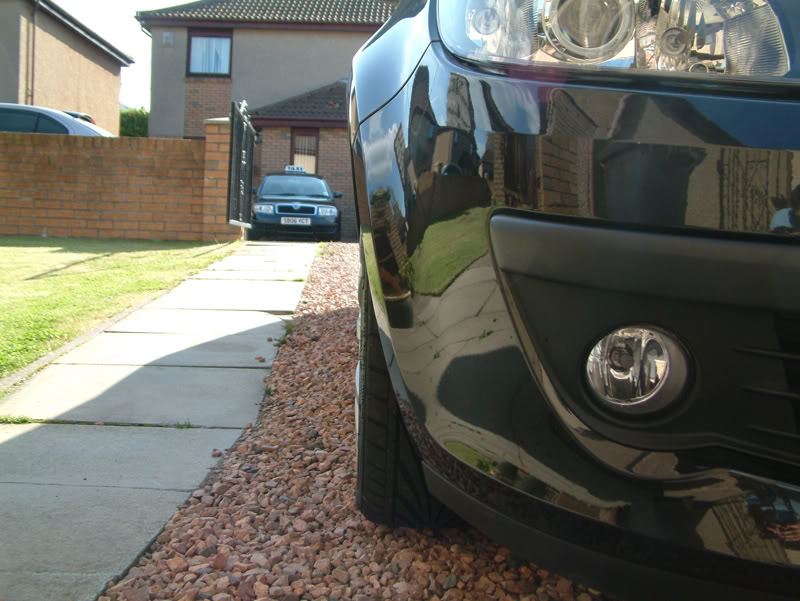

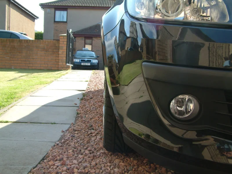

spacers are what you want ! make a hela diffrence to a mk3s Stance !!
25mm (FK System B i think) Spacers and down 70mm on Weitec coils....more pics here
only a non sport but shows the diffrence !
After
