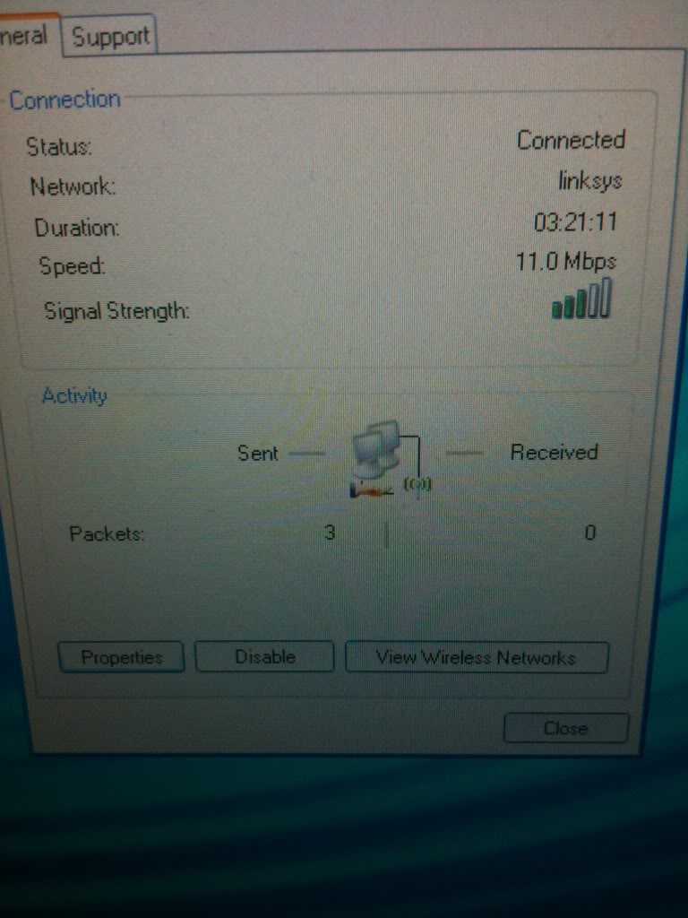

It sees the network. It's manually configured for the ip address etc and none of that has changed. But now it connects and the 'packets' thing either sits at zero or gets to 1 or 3 and then does nothing else all day.

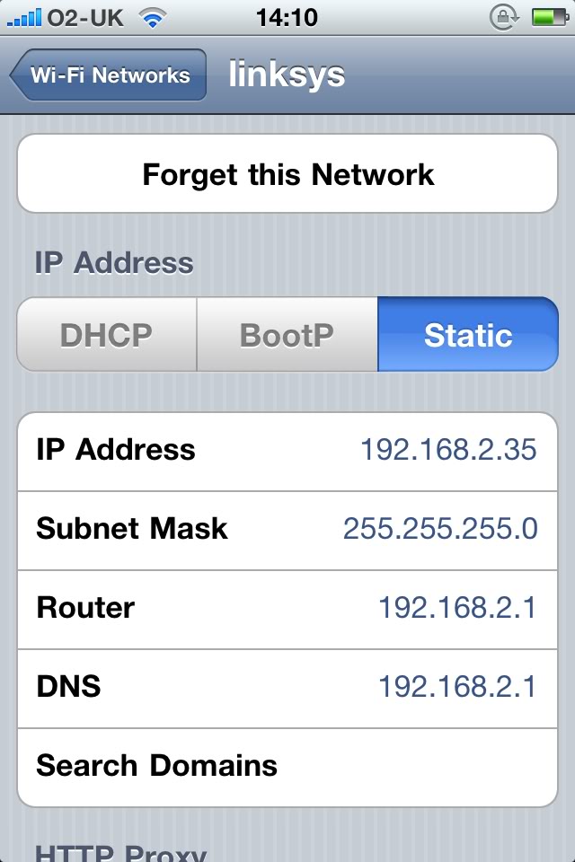

My iPhone still works on it so the network is alive and well and even with the laptop next to the router the problem persists, so it's not a distance thing. I've also updated the driver but that didn't fix it.

He's obviously not changed anything, your iPhone will be set to automatically detect and because you've configured your I.P settings on your laptop, it won't pick them up, most likely the default gateway being configured to 192.168.1 and because it's not static IP the router changes it every so often, it could be .2, or .3. Best to set it to automatically detect.

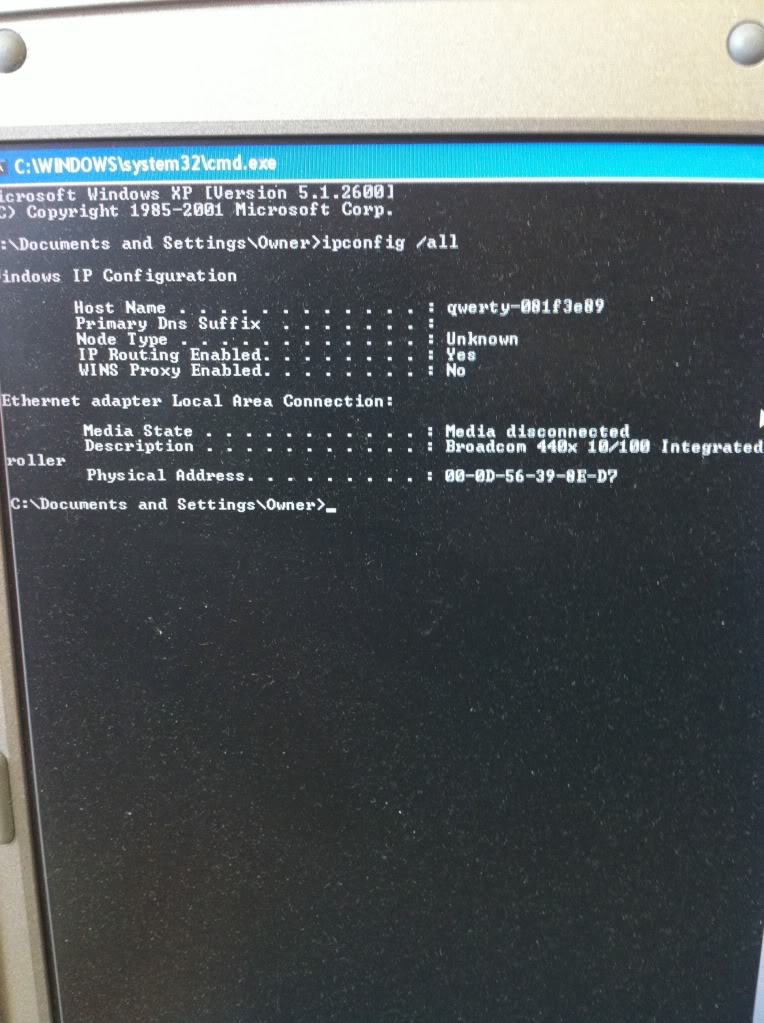

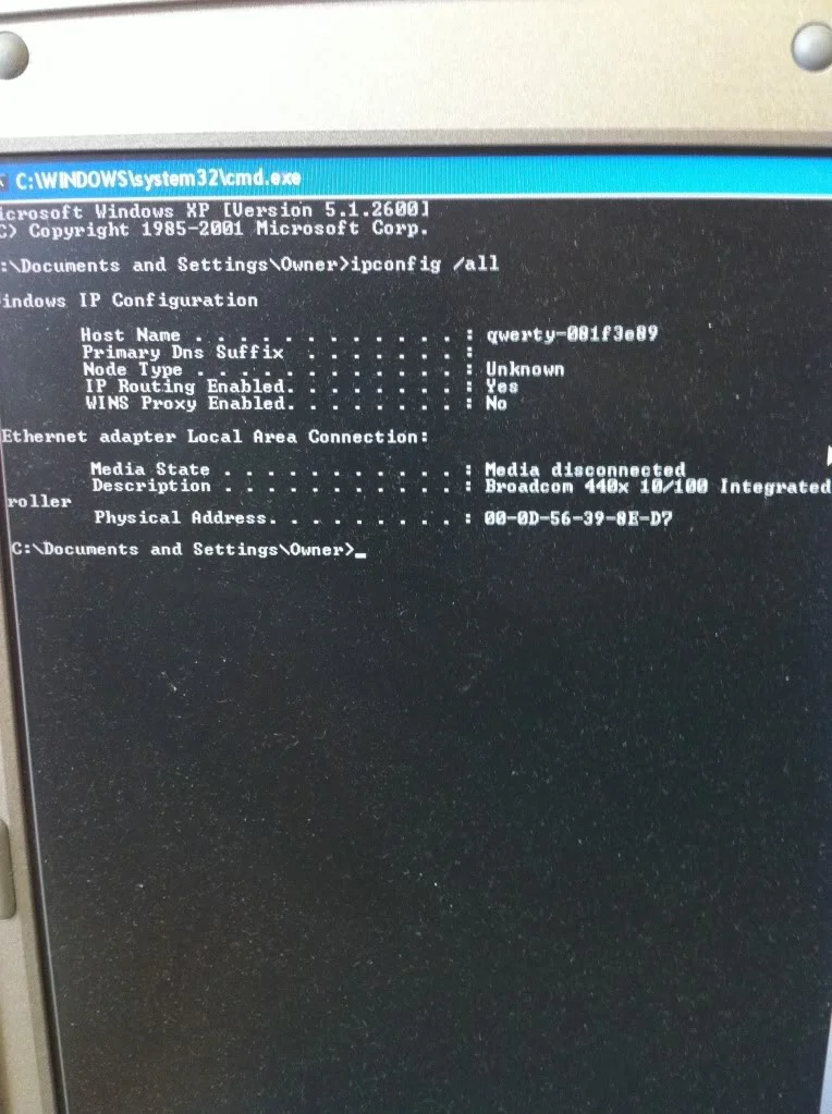

It only says disconnected because I turned it off. Lol. I was getting stupid popup and it kept flashing connected and was annoying me.
It's not showing the adapter, so there's something definitely wrong there.

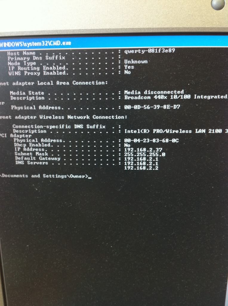

EDIT: Lol! Turn it on and then do ipconfig /all!
Ok, so it's definitely connected.

Try repairing the connection (right click on the little computer in the taskbar).

The TCP/IP settings look correct. Can you try connecting the laptop to the router via an ethernet cable and see if that works? If it doesn't it'll indicate a corrupt TCP/IP stack. If it does, it's something to do with your wireless settings.
iPhone is definitely 100% wireless.
