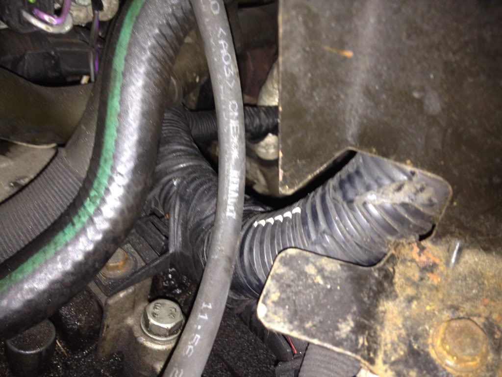

Anyway.......had another quick look and found this
The picture you see is the bottom of the ecu case at the far side of the battery tray.
Dont know if u can see but looks like the corner of the ecu case has rubbed its way into the armoured sleeve of the ecu wiring. Wonder if this could be the problem
Looks like i will have to cut all the armoured sleeve off to investigate
I feel brave
  Black Gold Trophy
Could well be the problem, I would disconnect the battery before investigating further to prevent anything shorting out
EDIT: You probably have already if you managed to get the camera in that position

Yeah had a brief look today and couldnt see any breaks in the wires, pretty sure its a wiring problem somewhere between the uch and ecu, will report back once my autoelectrician has had a look
