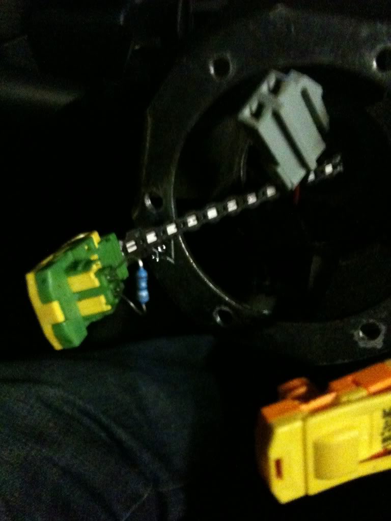

This is what the resistors should look like to stop the lights coming on mate
3.9 ohm used
