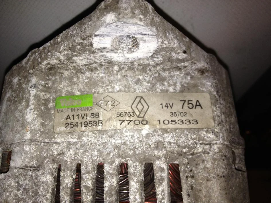

Will this alternator work on my cup??
So I have been looking. Found this one, which I know says 12V as well but the part numbers line up with the ones on my alternator ( see picture)
http://www.woodauto.com/Unit.aspx?Man=VALEO&Ref=TG8S017
how did you find that? I have been looking for ages. Going to order it now. Fit it on Friday afternoon. Then 2 1/2 years and the cup will roll again!!!!!
