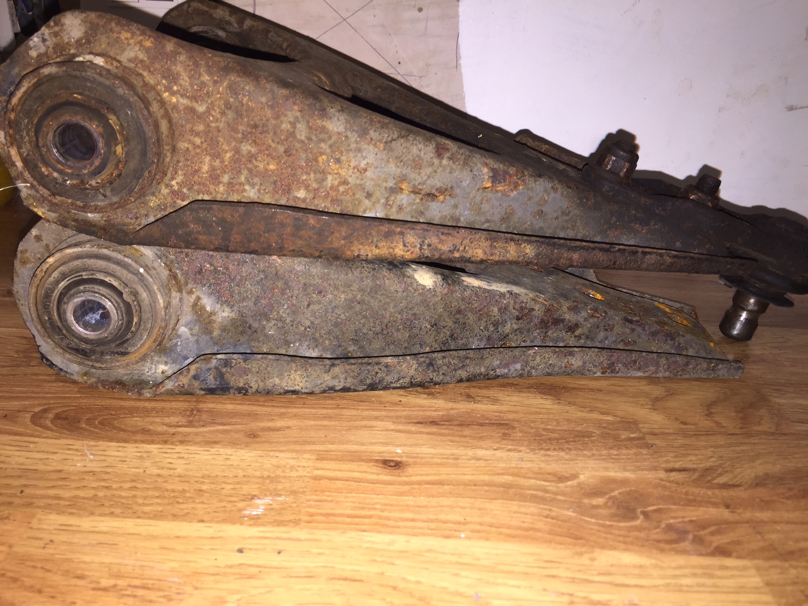

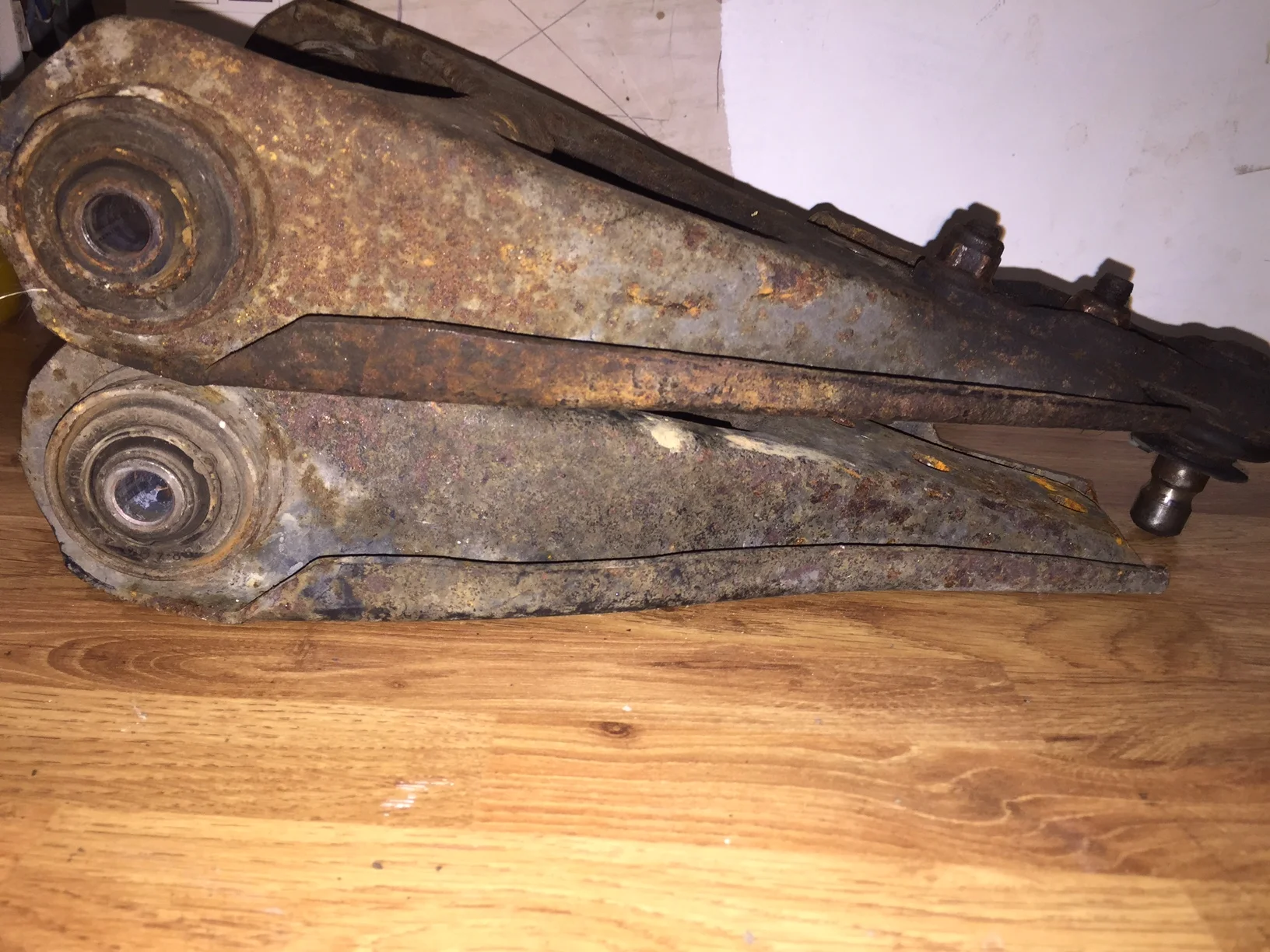

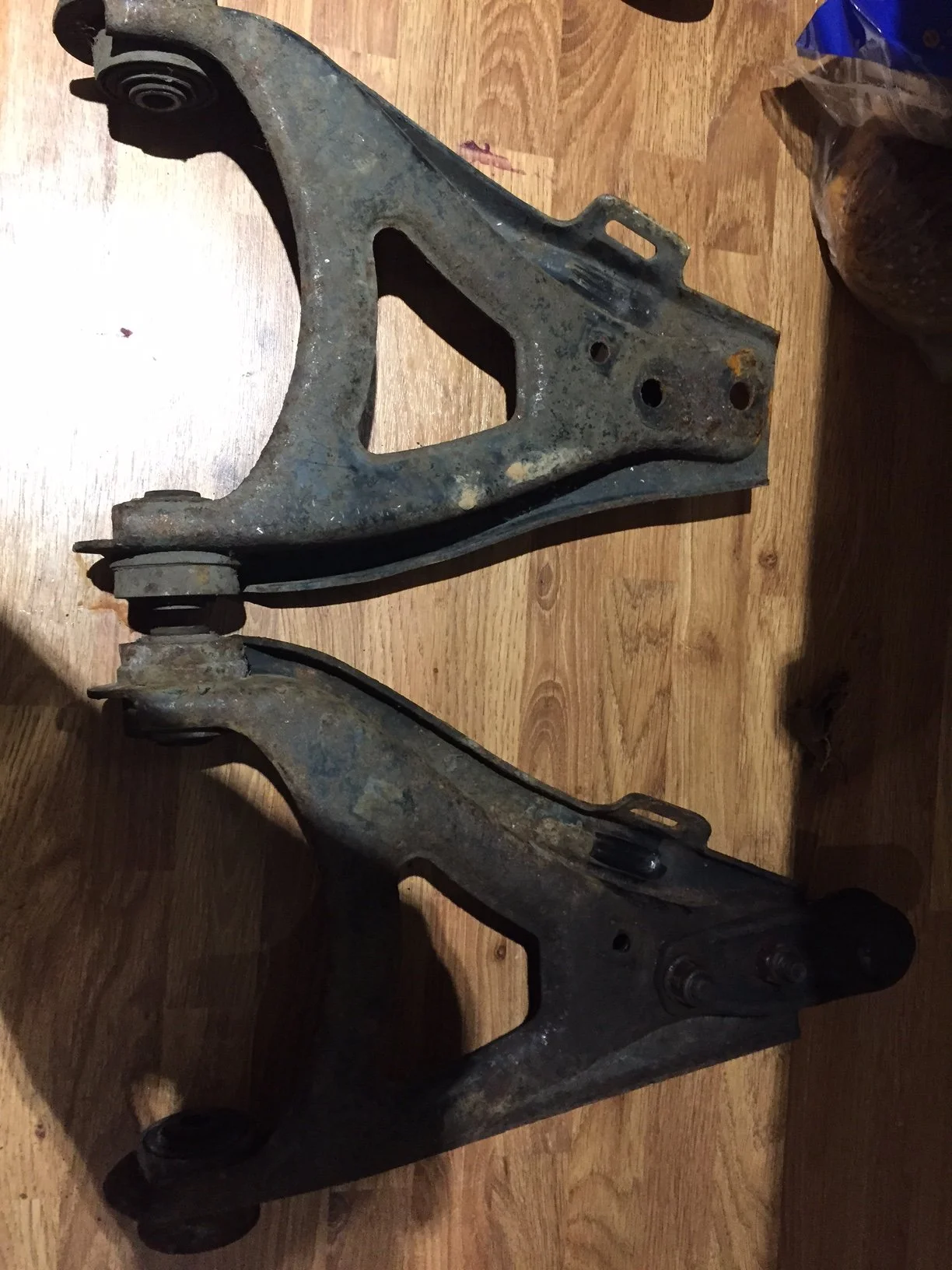

I'm breaking a ph1 at the moment and took the wishbones off today, when i saw them i was surprised how much they looked like the ones on my williams.
Put them side by side with williams wishbones and they look identical!
Can anyone confirm if this is the case?

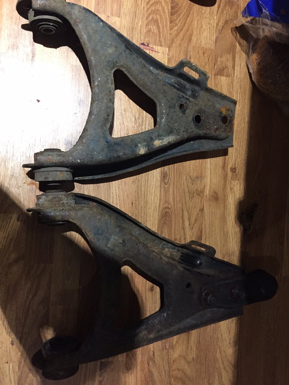

172 ph1 wishbones are identical to williams i just checked again.

If you have two to compare in front of you then trust your own judgment.
I don't know if they are the same or not.

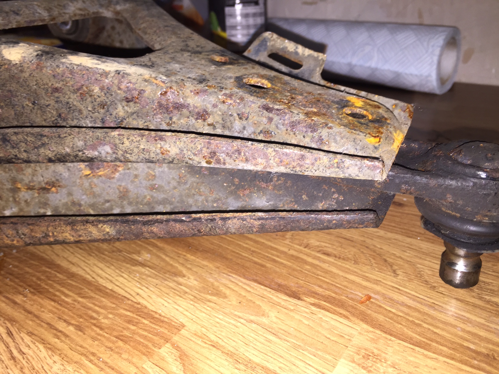

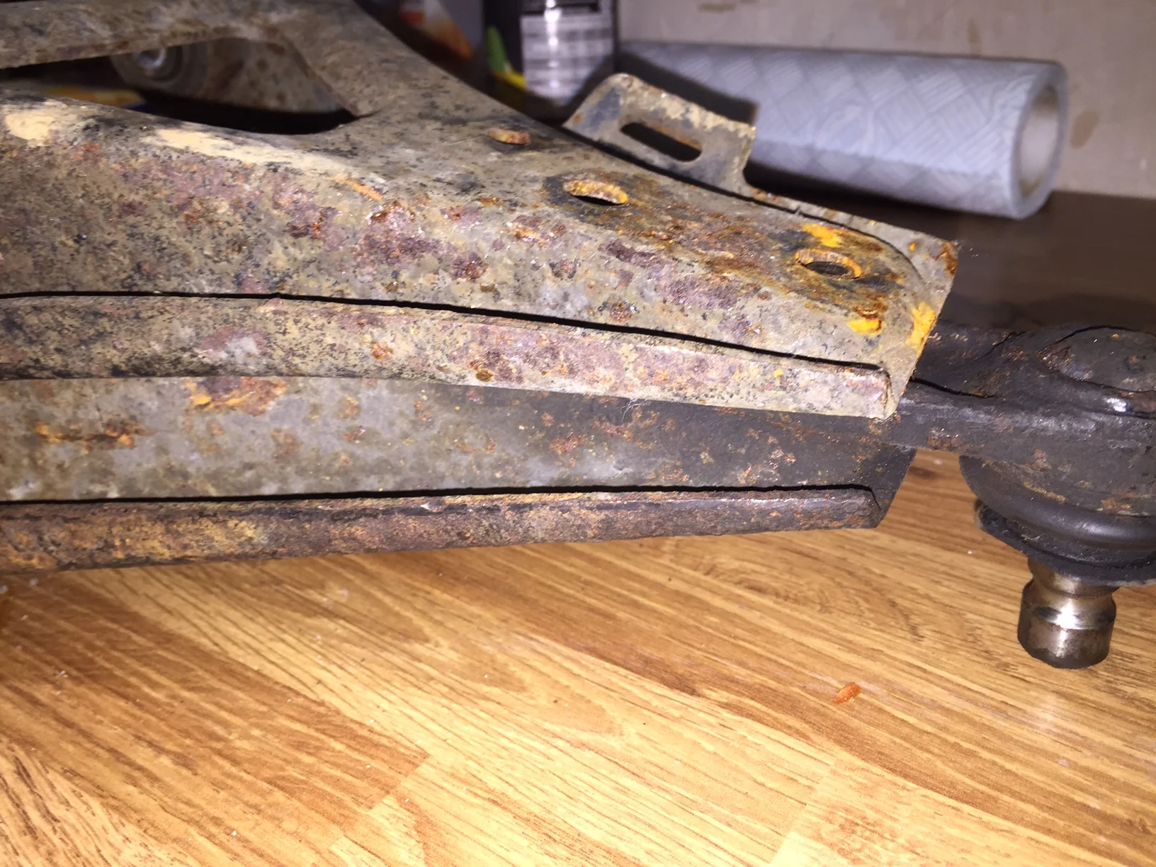

It is a bit hard to tell but they do look different in the angle of the ball joint bolts. This would change the caster angle.
I dont think the ball joint bolts are different, I tried to get the balljoint off the williams wishbone but one of the bolts is a bit seized so I didn't bother.

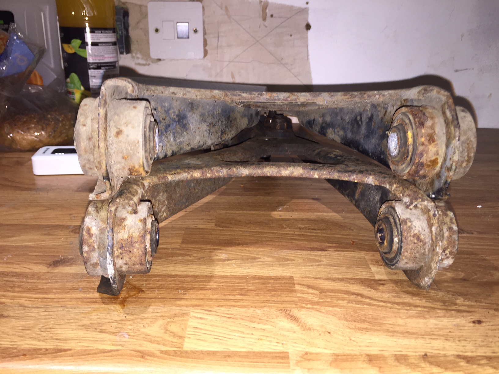

If the angle is different it will be minimal as you can see in the pictures but to me they look identical.

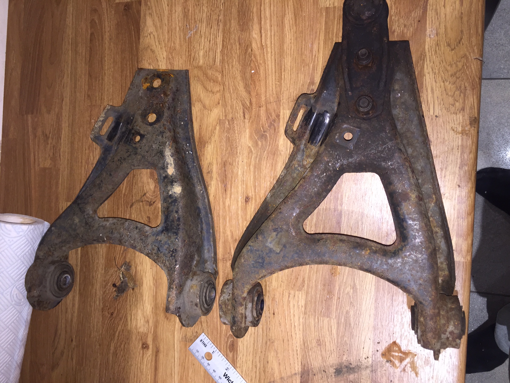

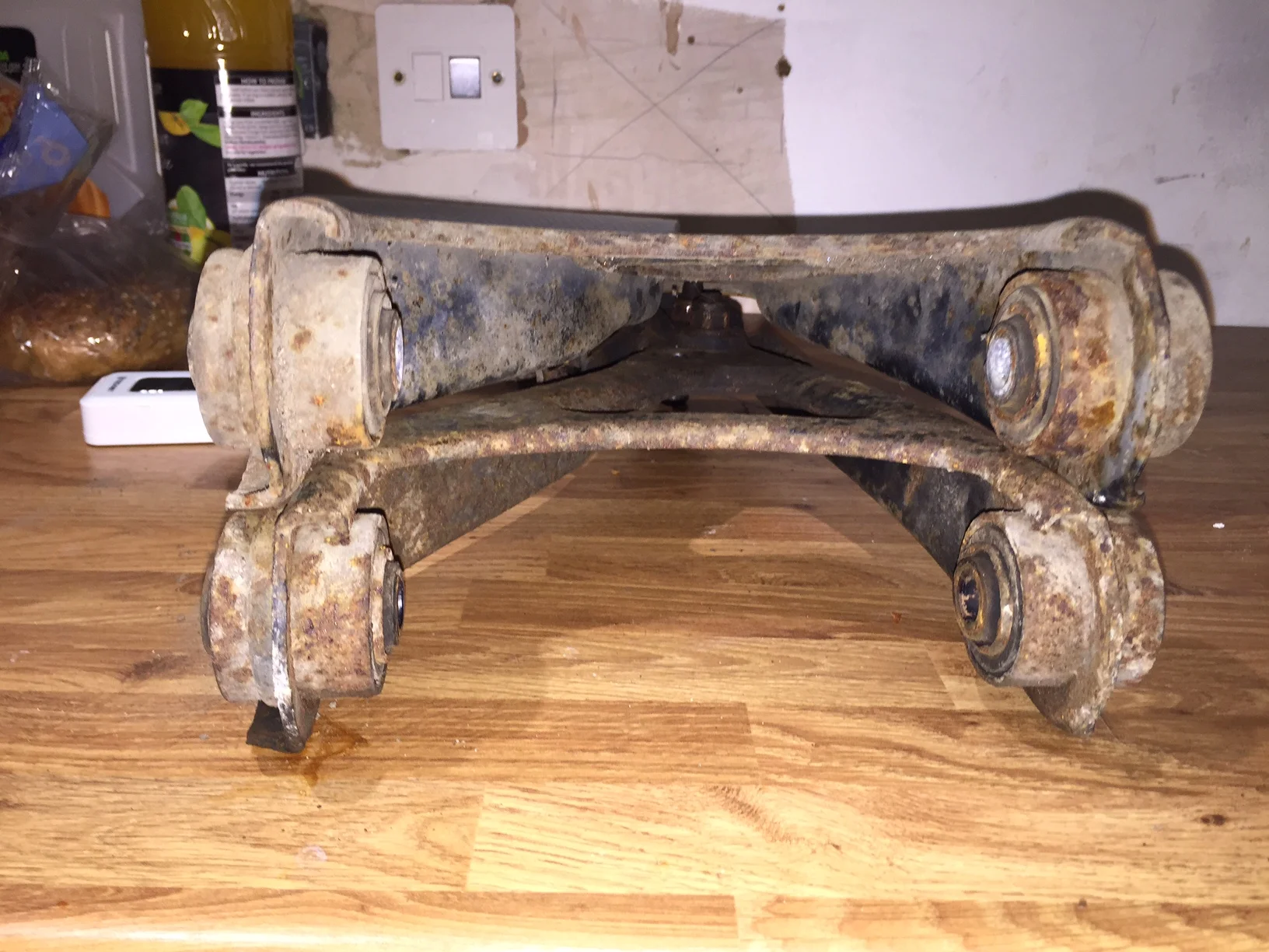

The concensus seems to be nothing is interchangeable, but the rubber bushes are the same, widths and spacing of everything is the same, bolt holes, anti roll bar locator is the same, this part is interchangeable unless I am missing something?

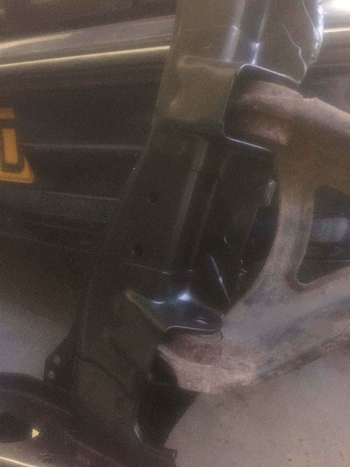

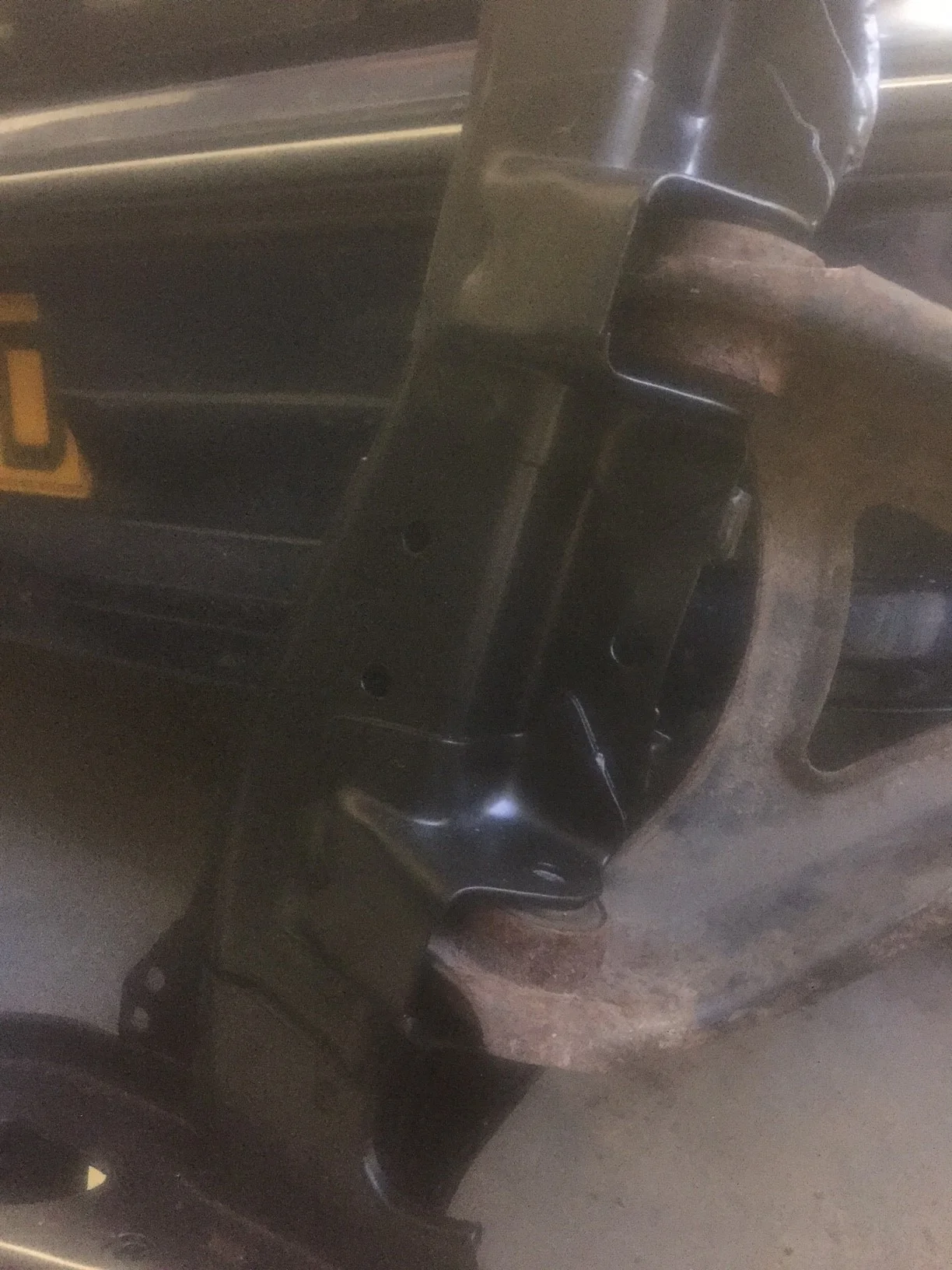

Just took the balljoint off to check and the bolt holes are in the same place and same spacing test fitted the 172 wishbone into my williams subframe and it fits like a glove. 100% the same.
Interesting for all mk1 owners with possibilities for extra castor etc. Without changing anything else

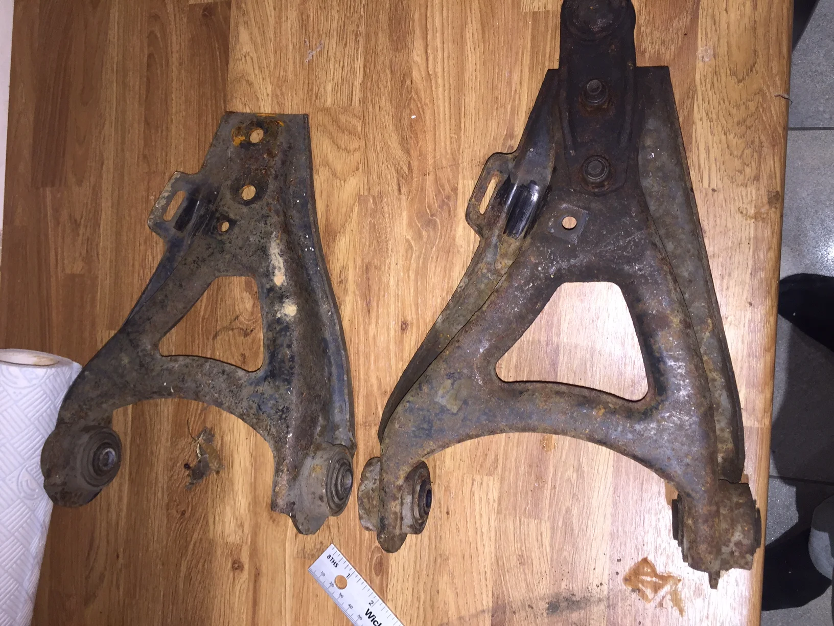

IMG_0835.webp Here I trial fitted the ph1 wishbone to my Williams subframe, measured all the bolt hole distances to the edge of subframe then did the same with the Williams wishbone. All dimensions EXACTLY the same, castor included
I thought this would have been common knowledge by now!?
good work, nice bit of beta that. I'm not mega up on Williams stuff as I just ran all mine around as dailies until I sold them, were never projects so never changed wishbones
all I know is you need the 172 ball joint as well as the Williams item has smaller bolts and bolt holes
