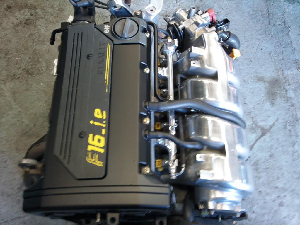

little update, wasn't sure what colour to do the covers, went for semi gloss black.
what do you think?

That looks pretty smart actually :) I'm liking the polishing too.
If you haven't got a new spark plug cover, Renault probably still sell them (cheap too)

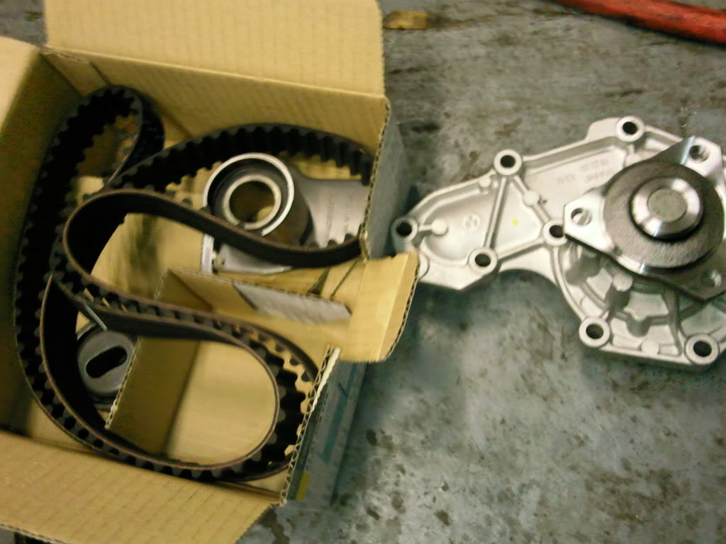

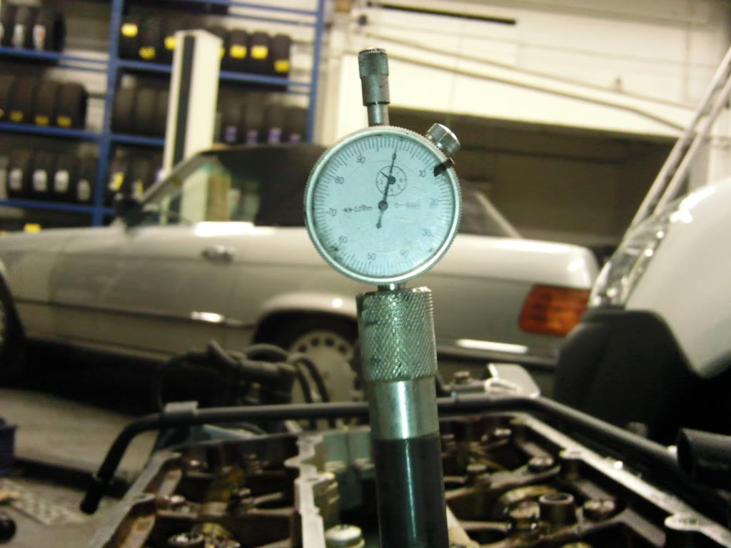

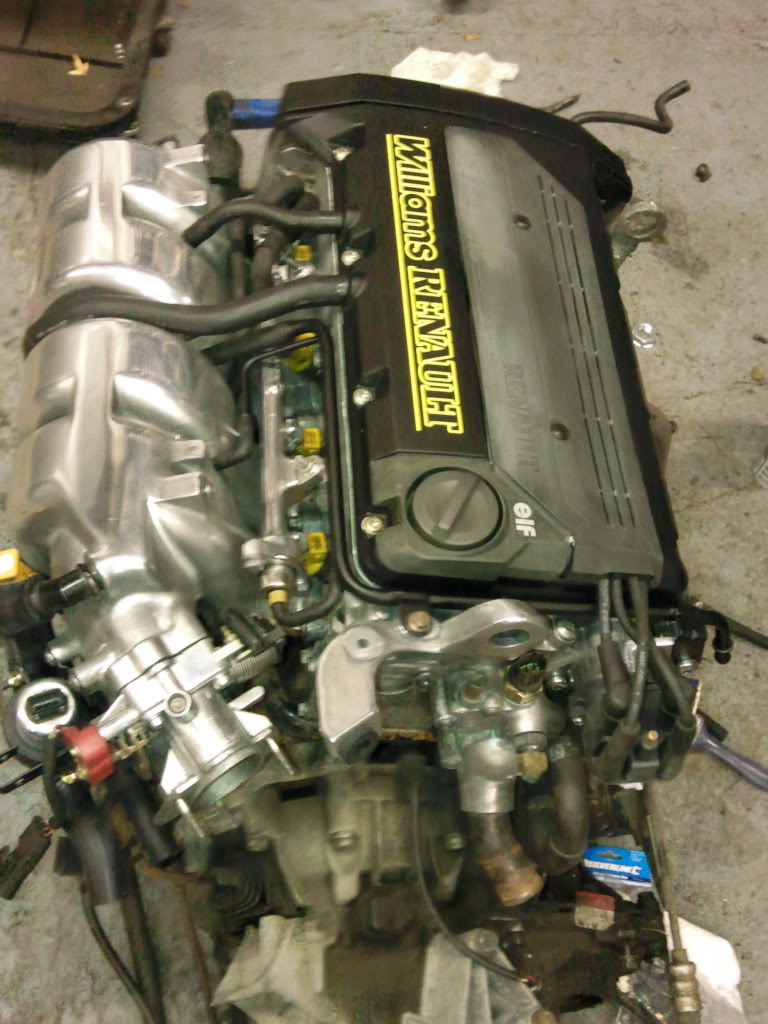

got a cam belt kit from renault as it worked out cheaper than a after market one, £89 about £20 cheaper.
and the water pump was a little noisey and had a bit of play in it so got an after market one came to £30 with a rocker gasket

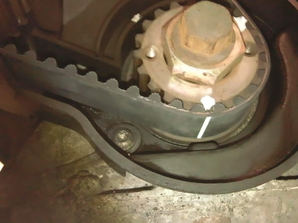

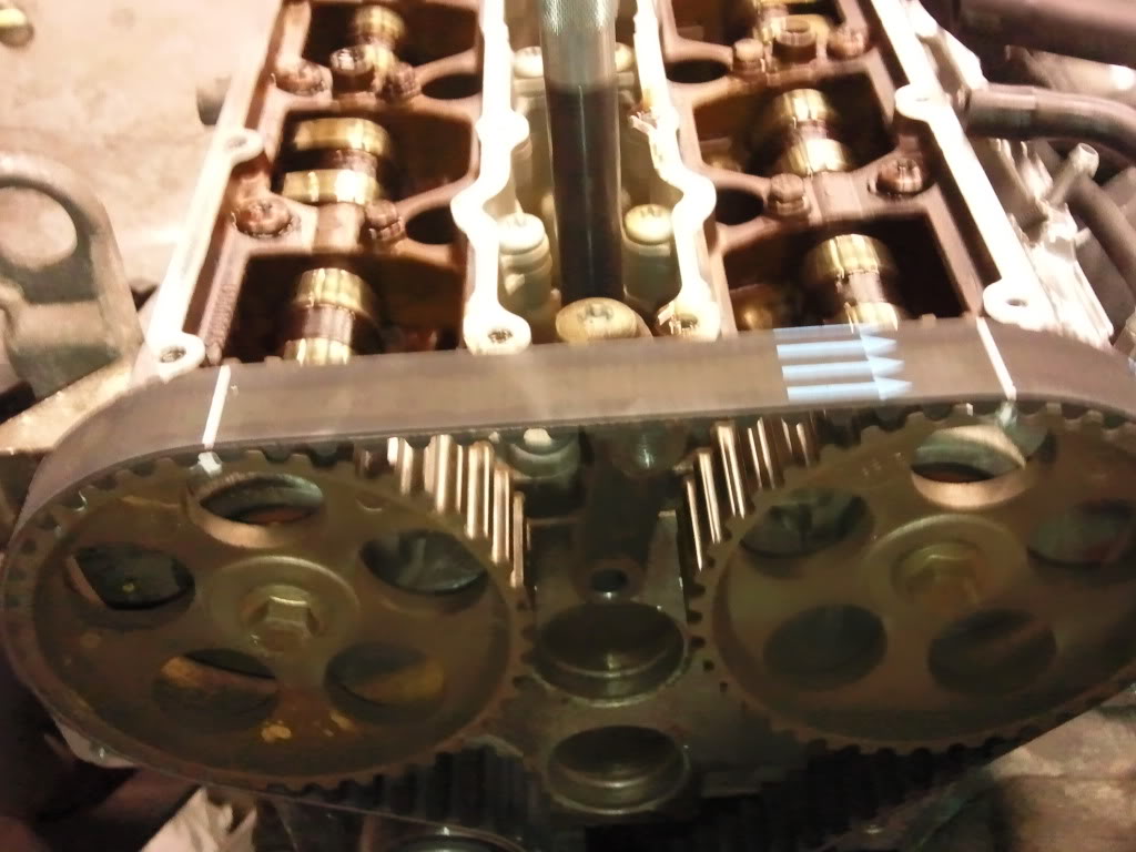

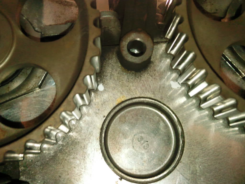

put a dti gauge in number one piston got it to dtc,removed the covers and pulleys, put a big nut on the bottom pulley and put the bolt back in, then marked the cam pulleys as the rocker cover was off so could'nt see the marks.
then i got the belt out the box and all that time i spent marking up and using the dti gauge was a waist of time, as the new belt had the timing marks on it, but i suppose better safe than sorry.
it timed up nice and easy
crank shaft pulley with the mark on the bottom
and the marks on the cam pulleys

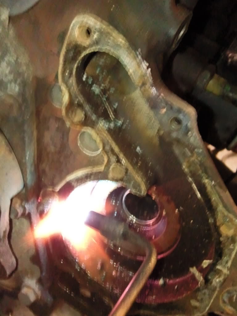

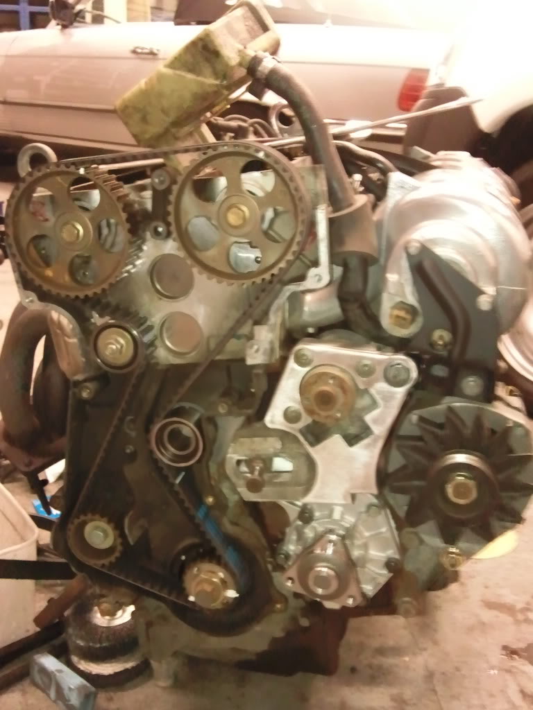

then started on the water pump, all i can say is the french need to start making cars easier to work on, there is no way you could do this job without dropping the engine, anyway had to take loads off to get to it, then two bolts broke taking the pump off
lucky i could warm them up and they broke off in a way i could get hold of them with mole grips

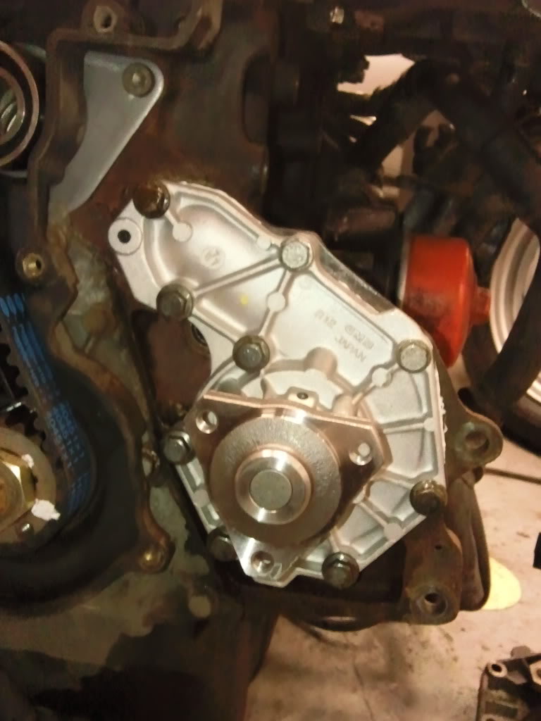

and the pump fitted, managed to find two bolts in the workshop, what a weird thread size they are, lucky to find them

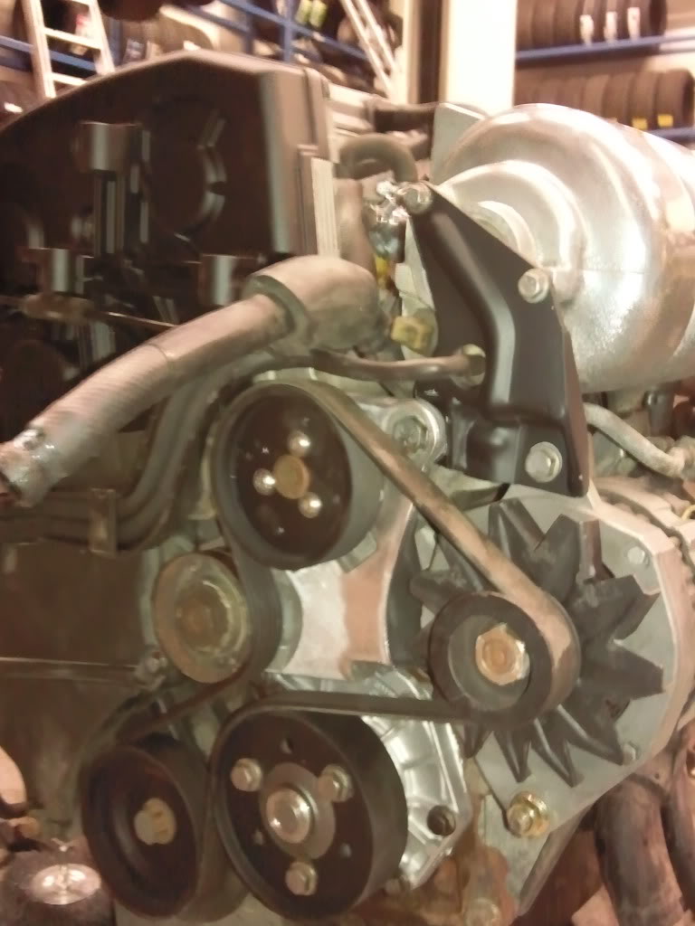

ran out of time tonight so as far as i got, ready for covers and pulleys

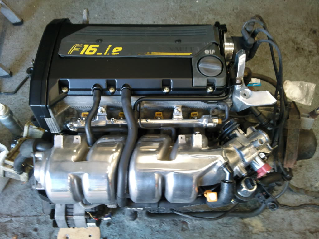

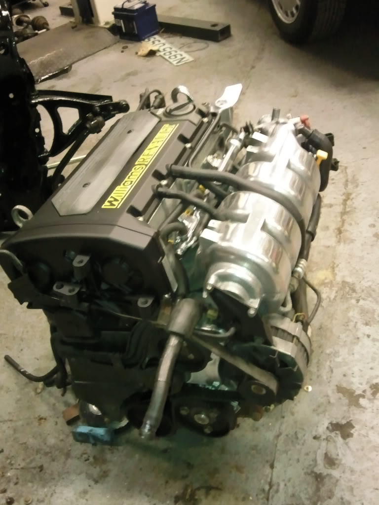

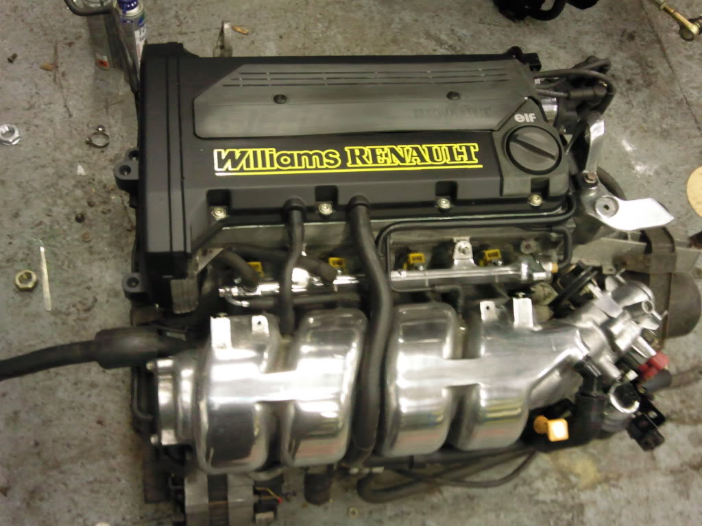

the front back together now

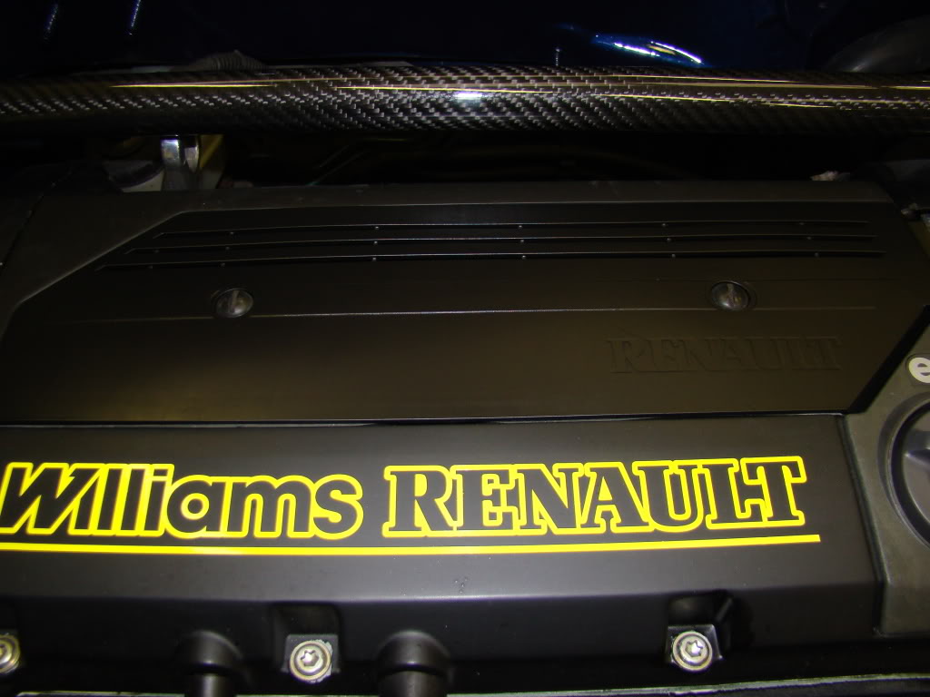

made a sticker for the engine but still not sure what to do with the plastic cover
the sticker is all yellow the light makes it look white
just a few little bits left to do on the engine, then i can make a start on the engine bay

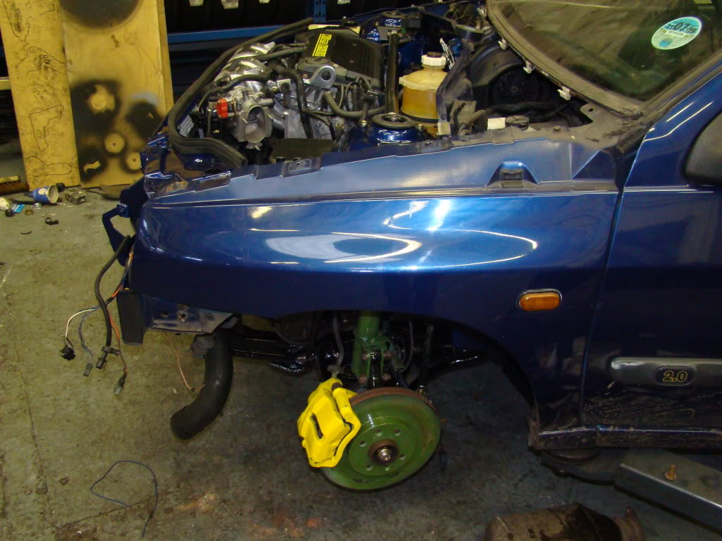

thought i'd do a little update as i haven't been on here for a while
sorted a few bits out but as i was in a rush didn't take many pictures

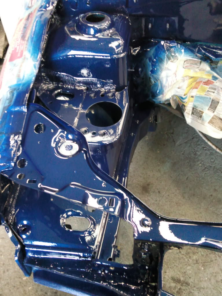

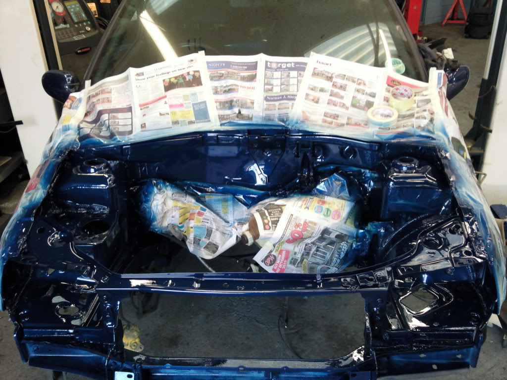

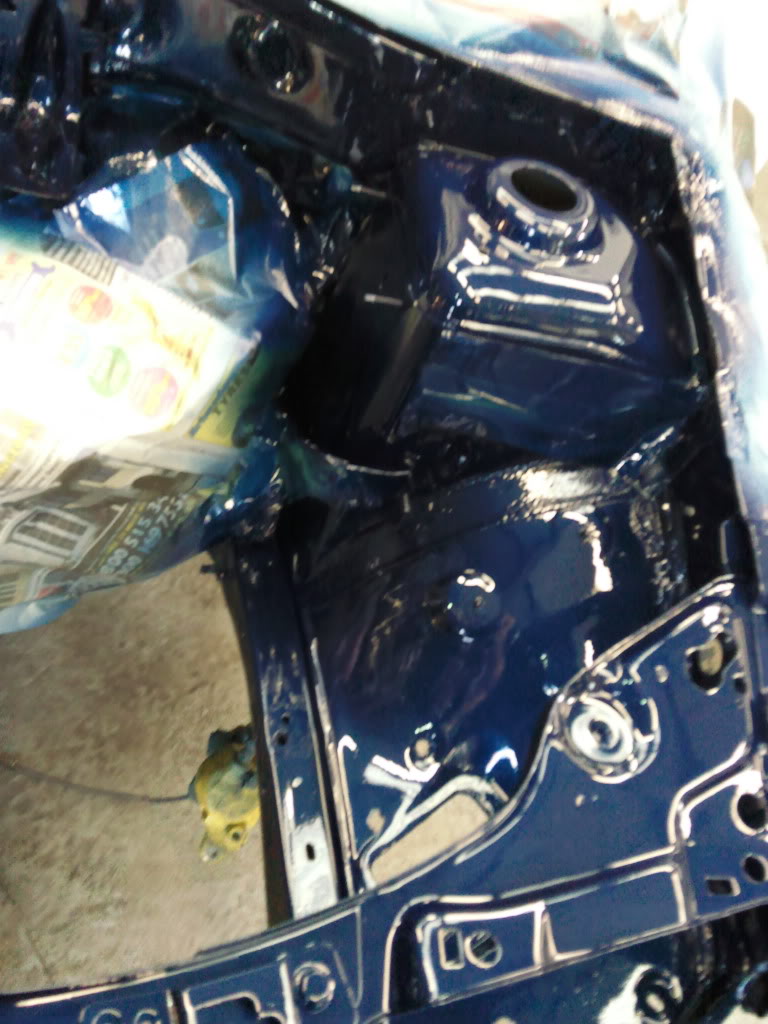

stripped out the engine bay apart from the ABS pump and brake servo and master cylinder, prepped and painted the bay,
the o/s
and the n/s

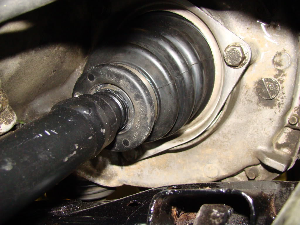

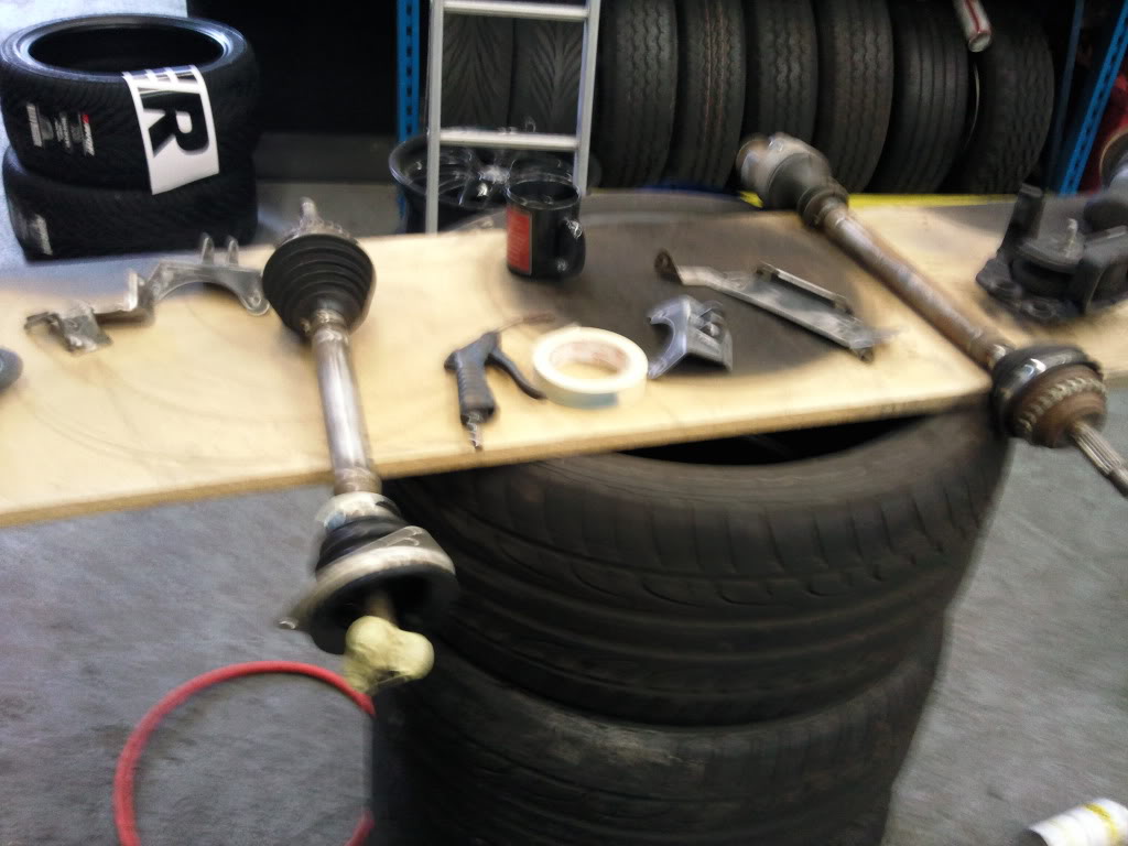

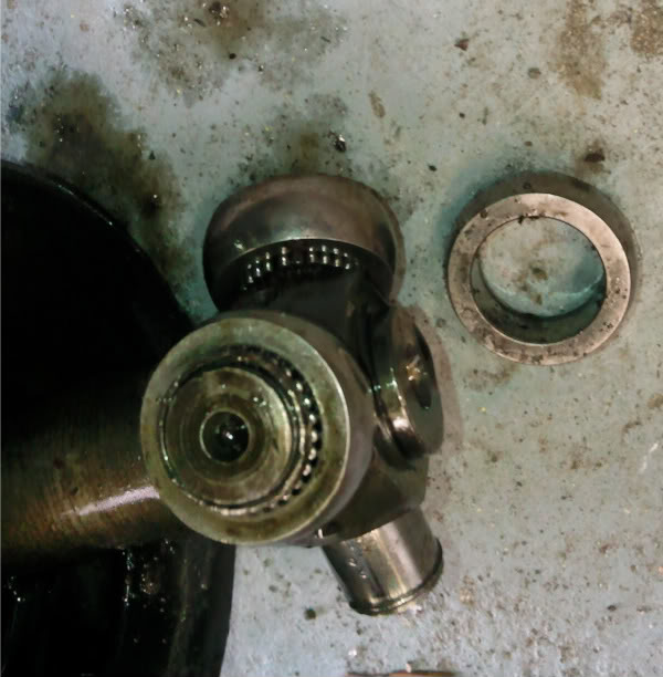

i managed to get a second hand drive shaft off a leguna for £25 and repair the end of mine by changing all the bits over, forgot to take a picture though, you can see the end masked up as i was spraying all the other bits too, the picture is rubbish:dapprove:

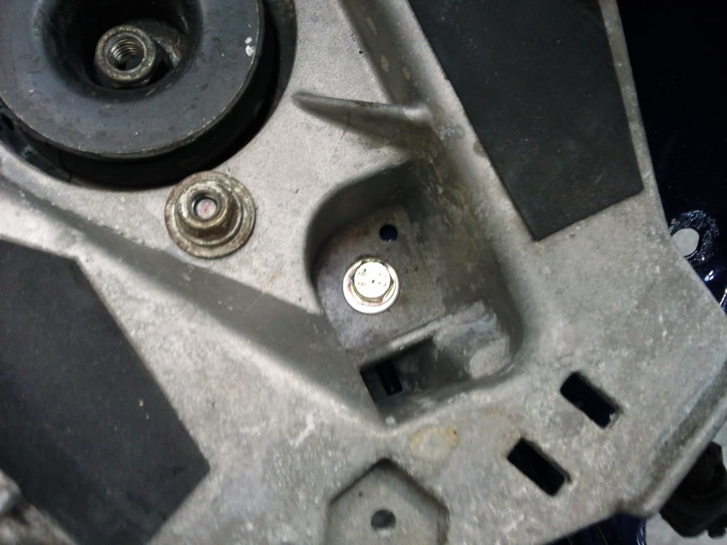

one of the bolts were broken on the n/s engine mount was broken so i drilled and re tapped the thread
the o/s
and the n/s

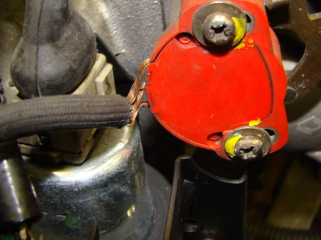

i need to repair the throttle position sensor as the wires are perished

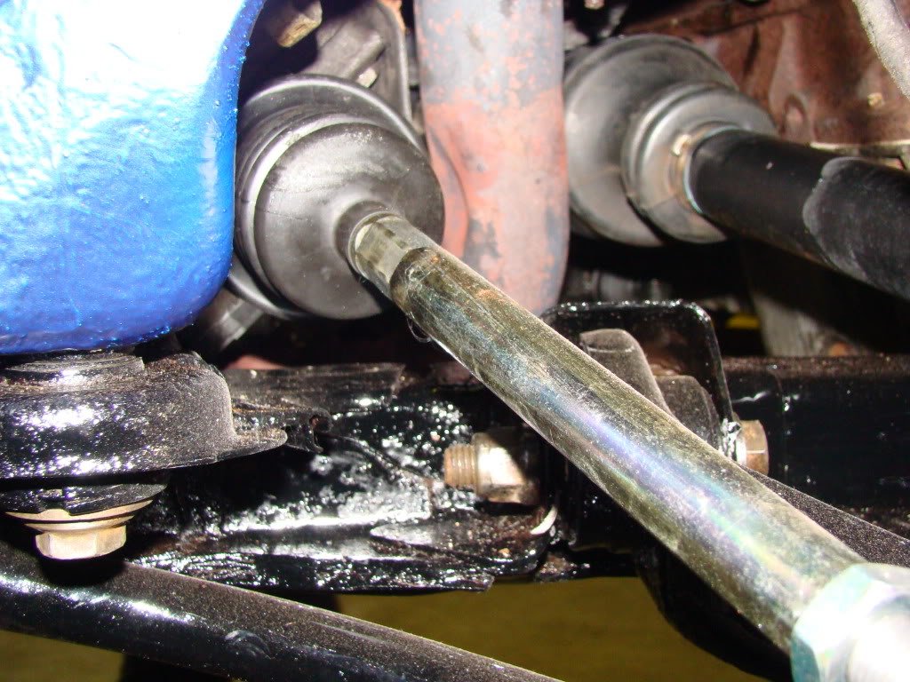

the n/s drive shaft back in and hopefully stay dry as it leaked before
and a very dry steering rack but after fitting it found out it's too short:mad: so need another rack or repair mine, that i kept thank god

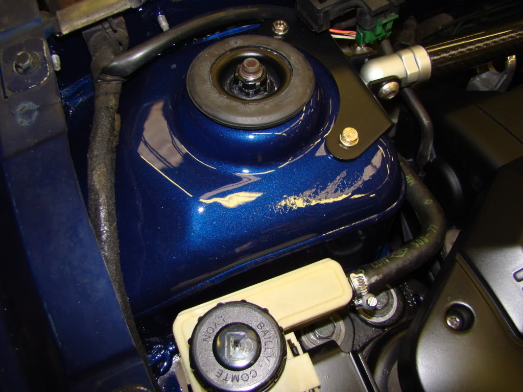

repaint the strut brace mounts as they were grey

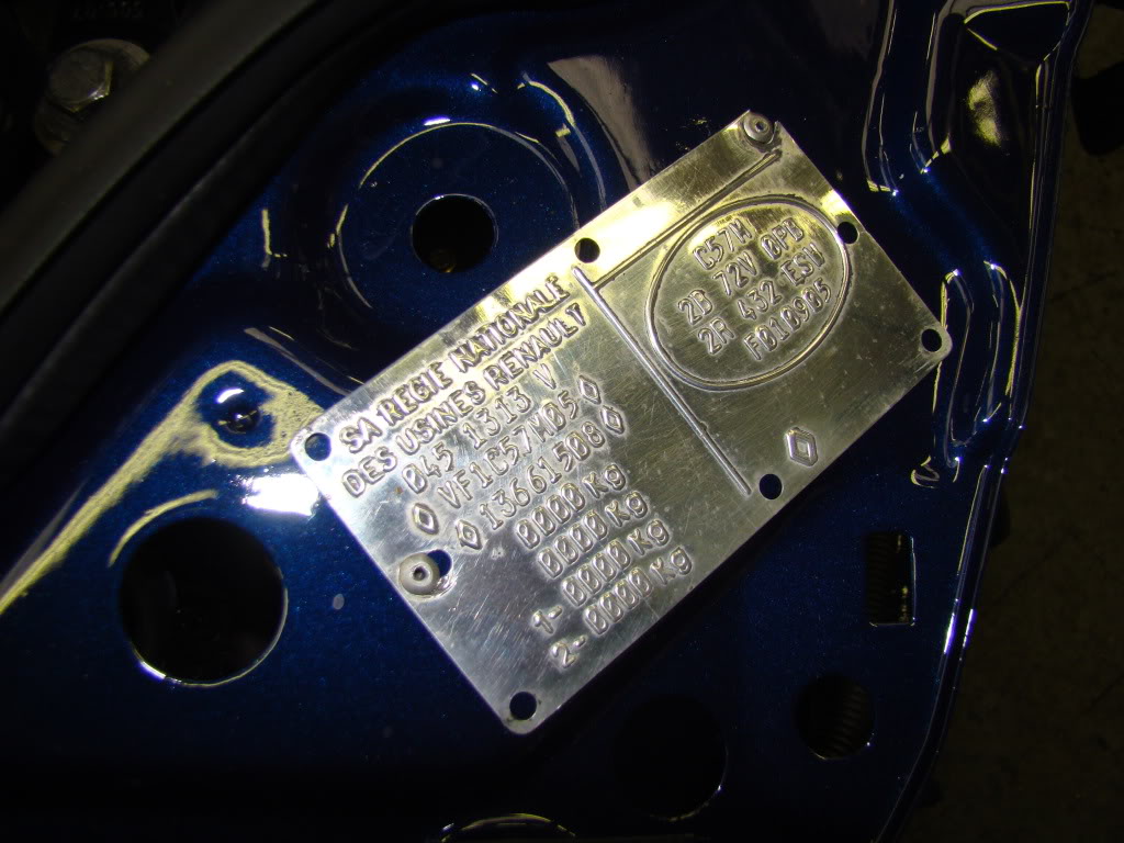

and polished the vin plate
painted the mount cover, and cleaned the fluid bottle

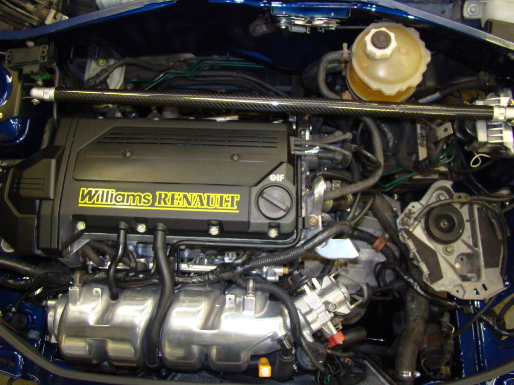

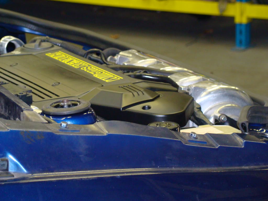

decided on painting my sparkplug cover

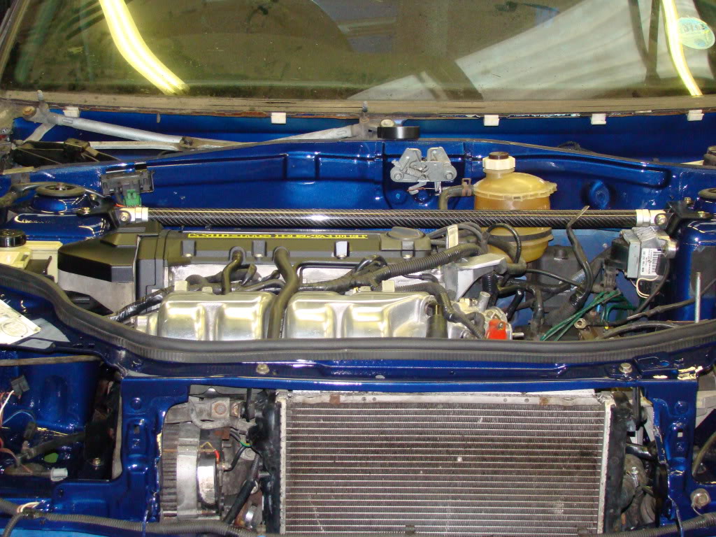

and a few of the bay so far

WOW! Awesome progress mate!
But please buy a new water bottle! Thats ruining the otherwise minty mint bay!!
Gaz_
  Extreme mode
Mint!!! What did you use to spray the bay? Proper gun i'm assuming?
  Golf GTD Mk7
nice mate, coming along well. how did you paint the plastic engine top (or is that not the spark cover).
  impreza p1, williams 3

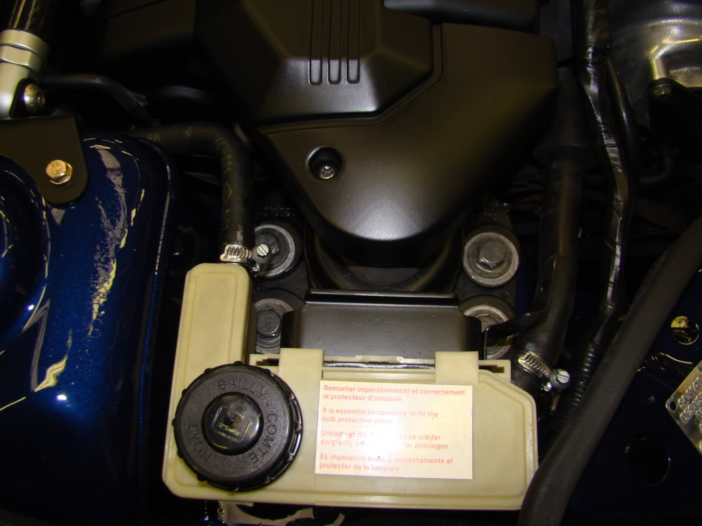

thank you:) it is a bit of a nasty colour, where do you draw the line, but is it right on top and in veiw so may have to get one!
thanks! yes a proper gun, white stone chip on the chassis, then primed and a base coat blue, i was surprised at how well it covered, then a couple of coats of two pack laquar
thank you,it is the spark plug cover, to start with i thought i'd straighten it out, so tried a heat gun and to my surprise it worked well,
then i rubbed it and the mounting cover with scotch bright, and sprayed them with plastic paint i got from car spares

really nice. The williams track rod ends can be fitted to the valver steering rack fyi
are you sure as the one i got i think was off of one, i measured the arms and ends but the inside of the rack is too short, i dont want to have the same problem
on monday i'm sending my rack to a power stearing repairer if the price is reasonable
i tried to get repair seals for it but renault dont do them
  ValverInBits
I did a little research with my MK1 rack, i'm using a female track rod (male track rod end) manual rack. I've looked through an outdated (but still relevant) renault parts database and the williams rack seems to have a different track rod. The track rods between the valver PAS racks and the manual racks are exactly the same.
I think the difference with the williams rack is it's a bit tighter lock to lock, then the track rods are longer. Certinally what I thought the parts database suggested.
the williams has a wider track using 19 suspension parts the valver has normal clio suspension i think, i've fitted new rack arms and track rod ends and mearsured them with the old ones, but i didn't measure the rack length like a fool

Plastic paint seems to work well then. Always thought it would flake off over time. Might give it a go on a few bits ;)
