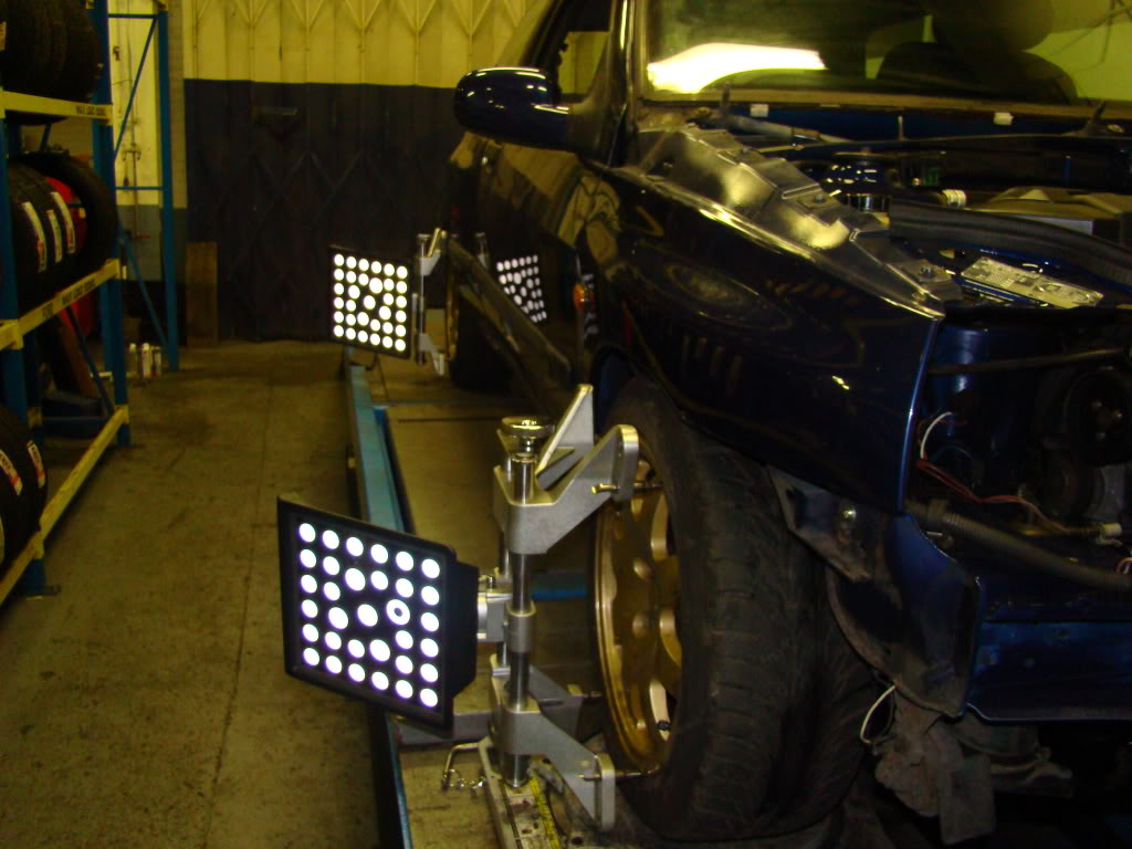

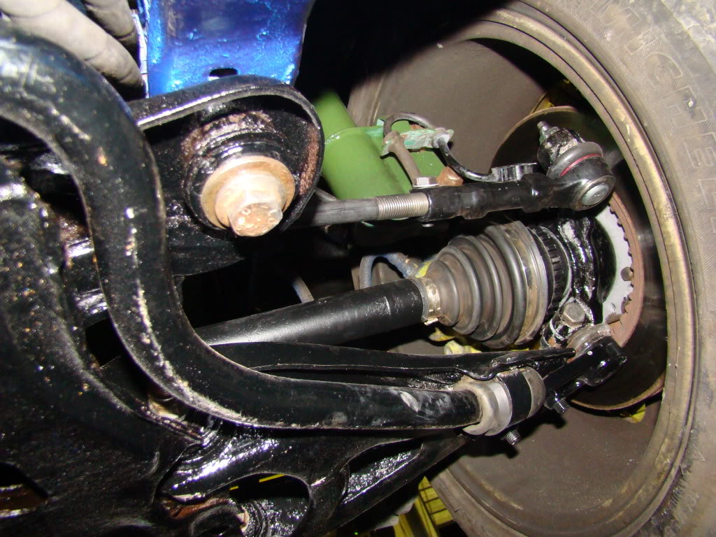

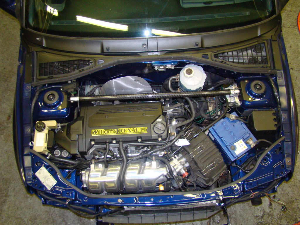

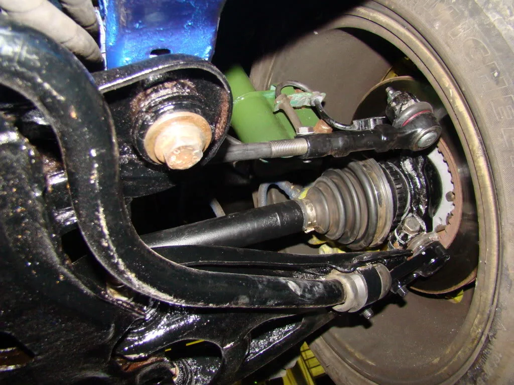

the williams has a wider track using 19 suspension parts the valver has normal clio suspension i think, i've fitted new rack arms and track rod ends and mearsured them with the old ones, but i didn't measure the rack length like a fool
so do you think i've been had over as the rack i got was meant to be off a valver? i cant do anyhing about it now as i got it 4 months ago19 wishbones are actually slightly different and push the wheel forward slightly, but yeah same track. I suspect the williams and valver racks (not including track rods) are the same length.

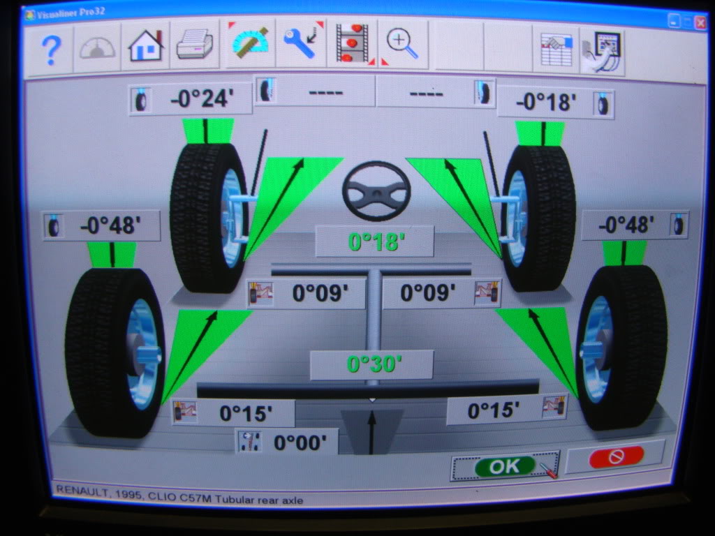

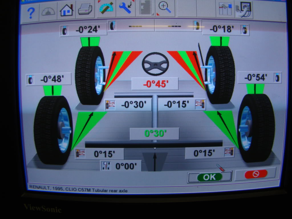

not bad but even the little drive from each ramp you could tell it wasn't right, i'm very pleased as it's very good on all the readingsNice mate, and good effort doing it by eye!! Not far off!

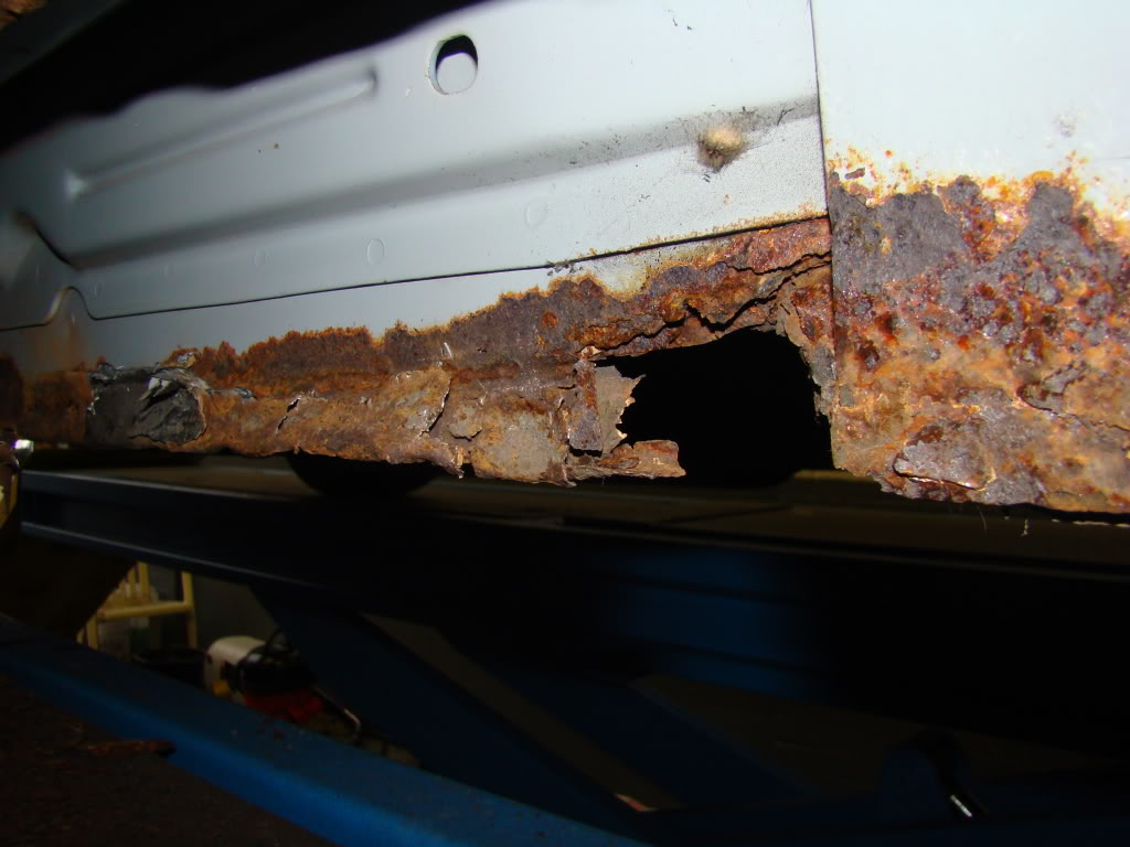

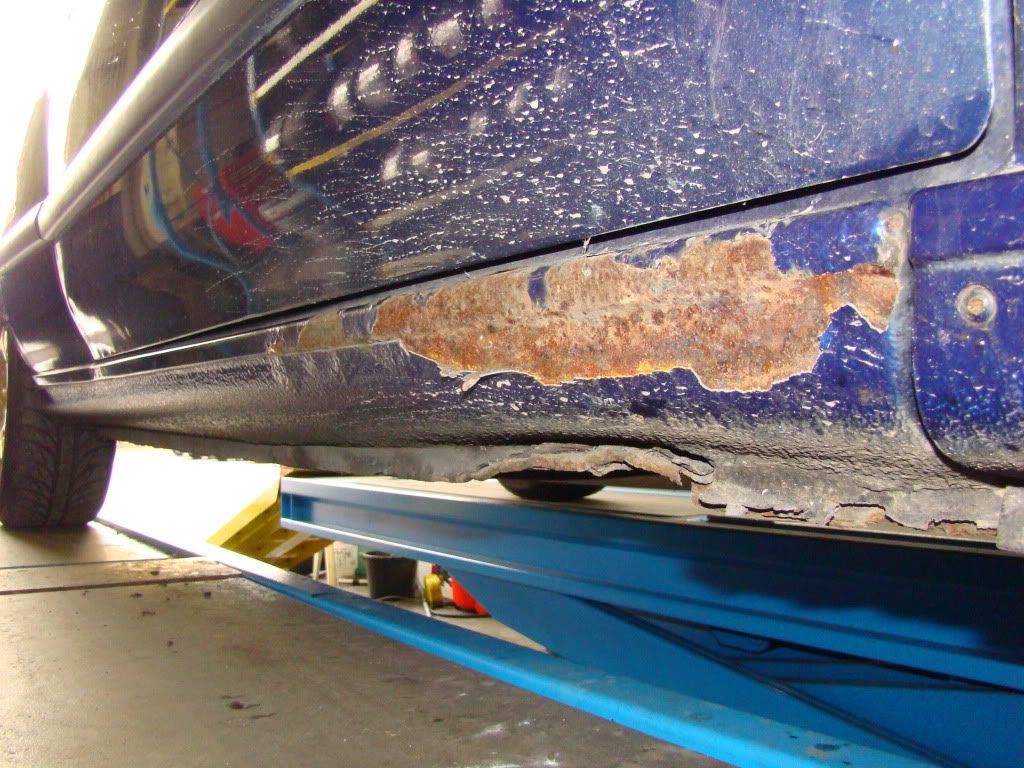

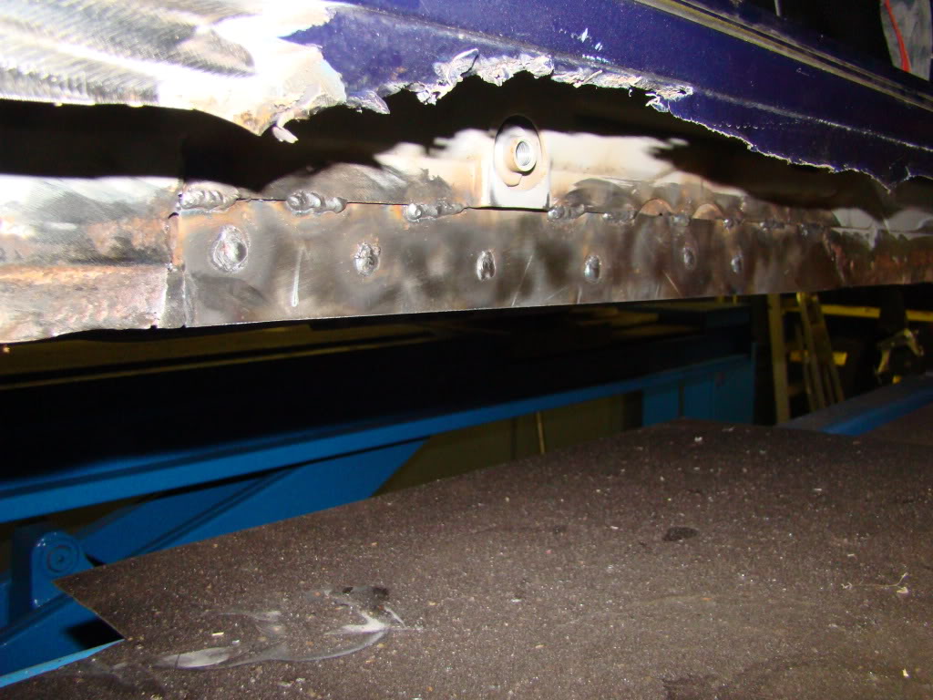

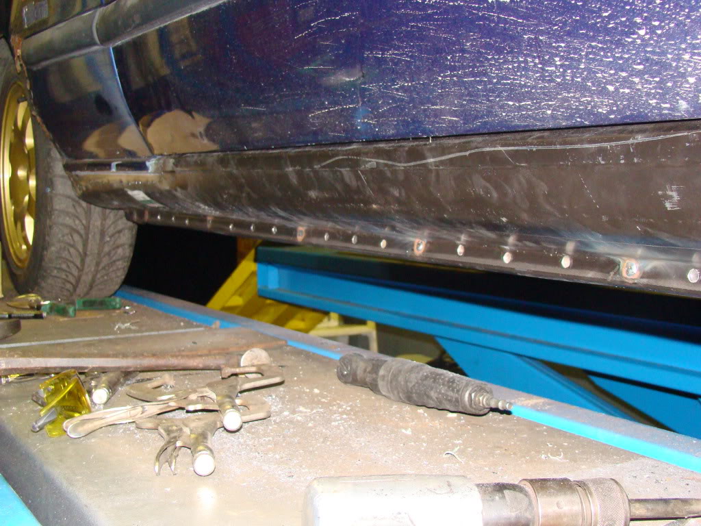

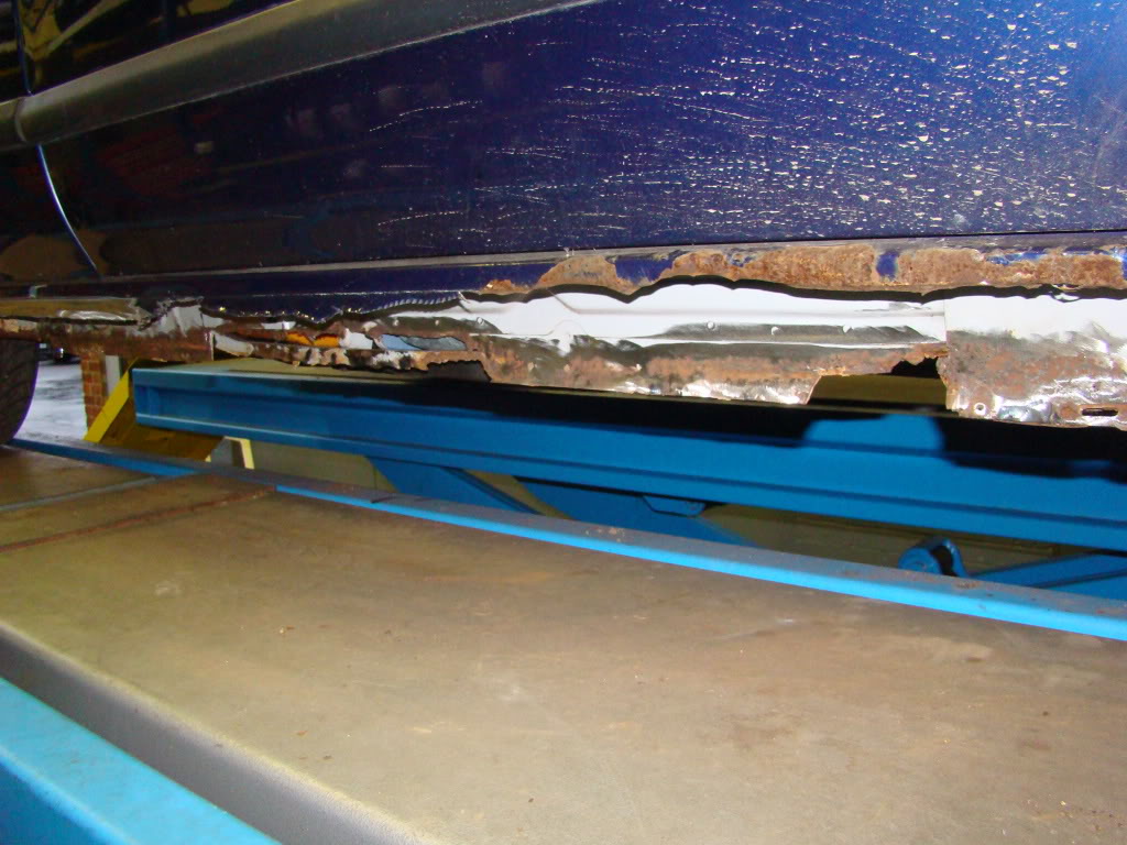

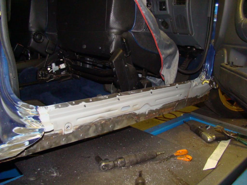

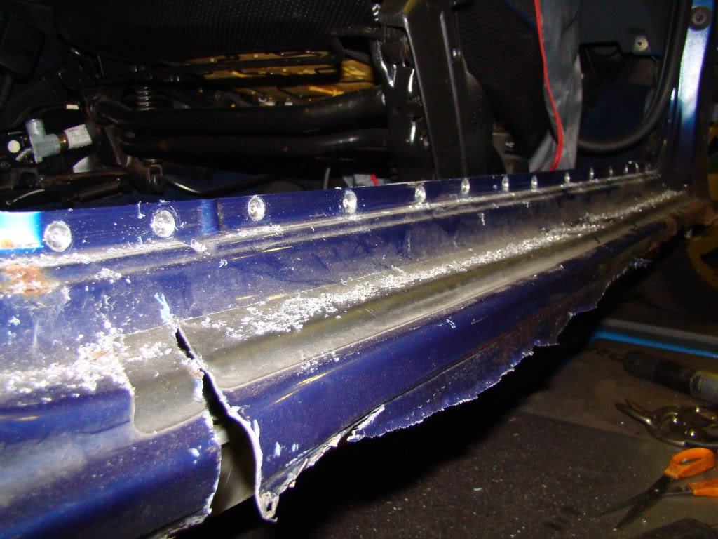

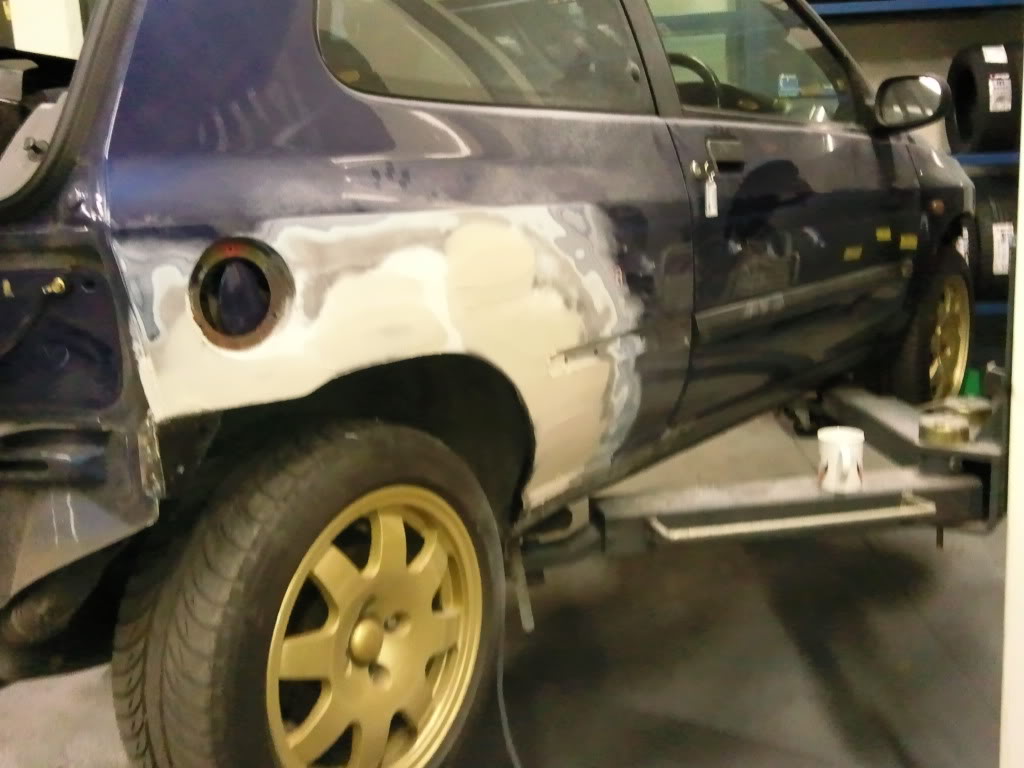

thanks for the positive comments, the sills came from a motor factors, took a day to get and they were full sills for a mk1 clio, £21. they do need a bit of work to fit on the rear but the rest is a perfect fit! as for the thickness of the metal i used i think its about the same as body panels, good enough for the inner sills as they seemed the same
no but i will find out tomorrow for youcheers. Did you note the manufacturer of the sill?

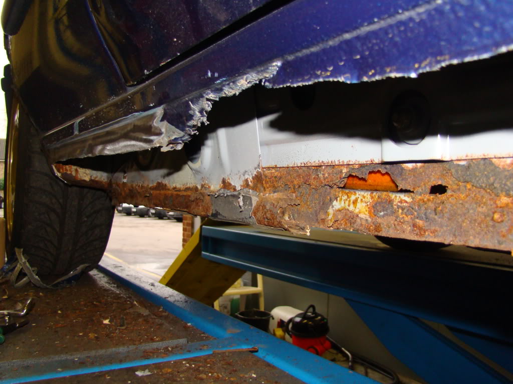

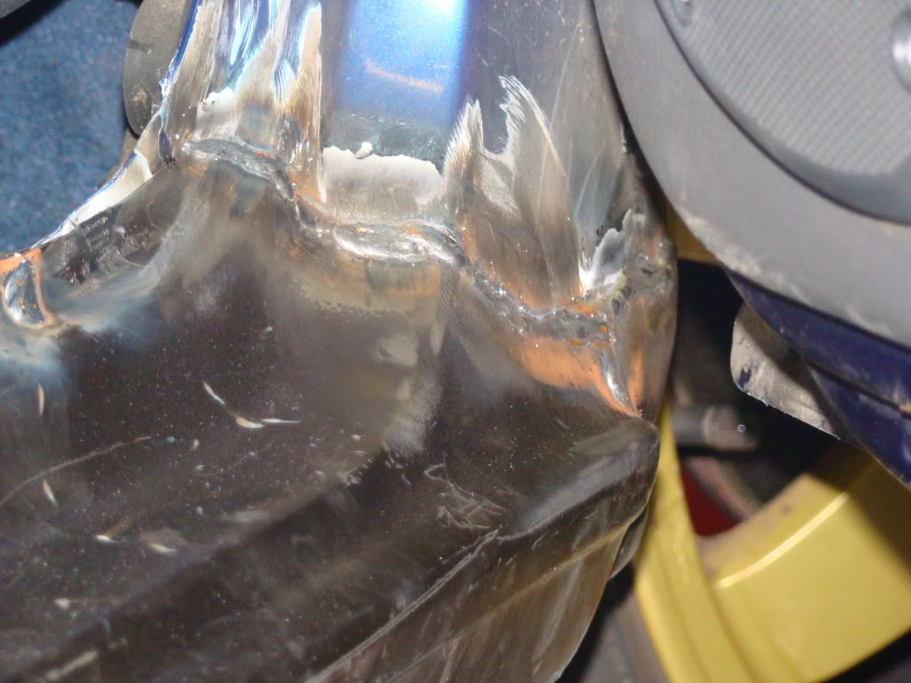

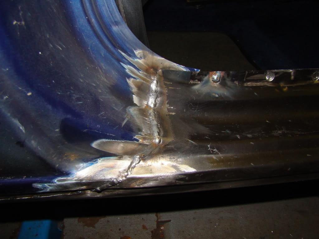

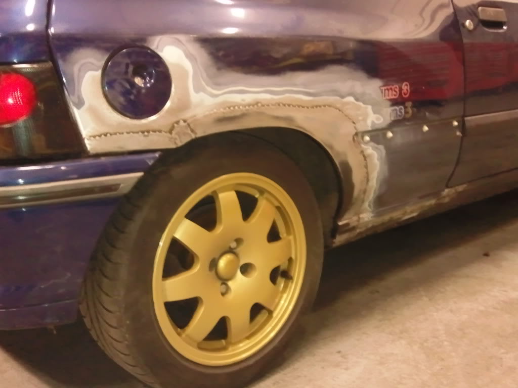

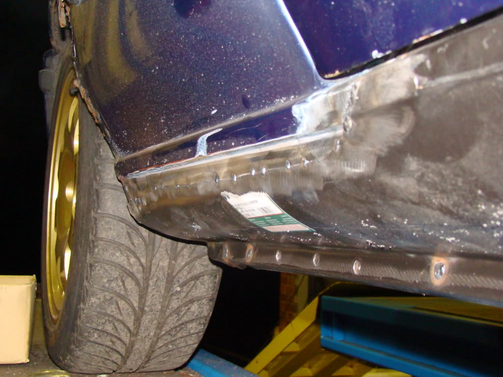

done, not that bad under there or it would be a lot more work if it was rottentake the petrol instructions sticker off and you'll find more rust to repair - while your doing it properly and all![]()
there's instructions on the ring on the body under the capPetrol instructions sticker??
i'll keep you in mind, the moulding clips just twisted off, so as long as they dont break romoving the trim i'm hoping they'll be oklooking really nice! if you need any plastic trim clips (except for the moulding ones) pm me as i have loads of new ones spare so i might have some you need.
