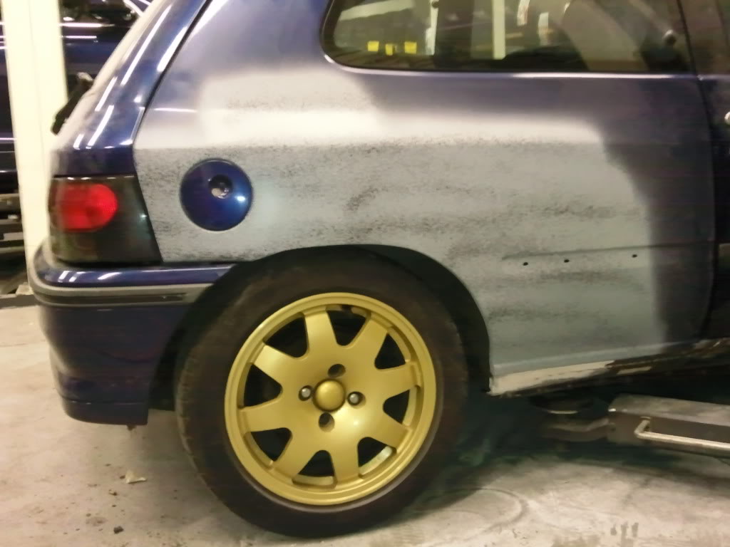

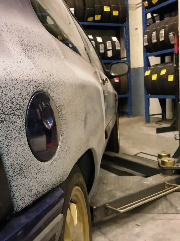

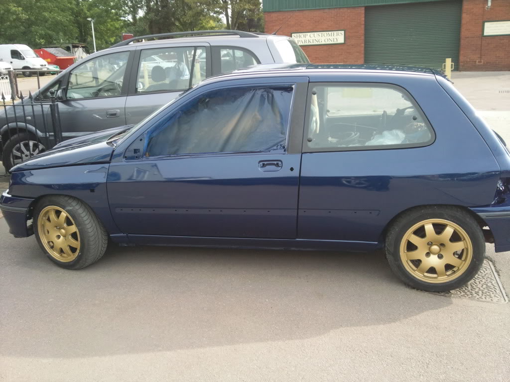

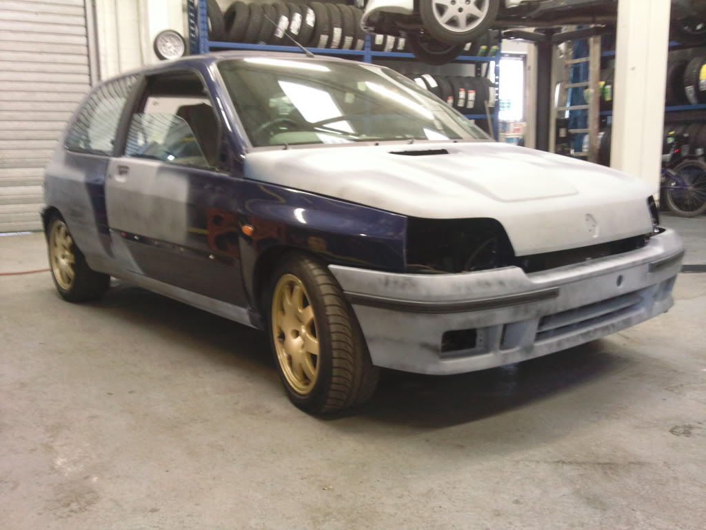

got the wing in primer with a quide coat today, still got to finish off the sill panel but i'm pleased with how the wing came out, suprised myself a little
cant see very well in this picture but the wing is pretty straight

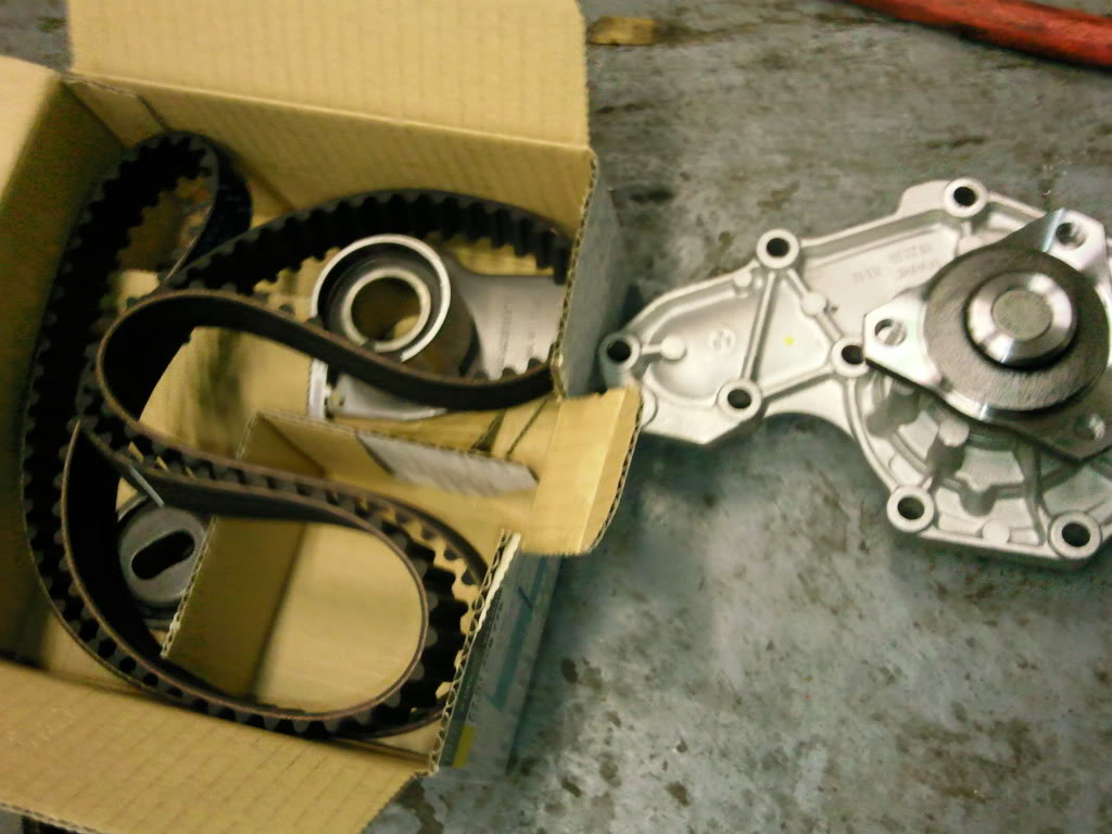

got a cam belt kit from renault as it worked out cheaper than a after market one, £89 about £20 cheaper.
and the water pump was a little noisey and had a bit of play in it so got an after market one came to £30 with a rocker gasket

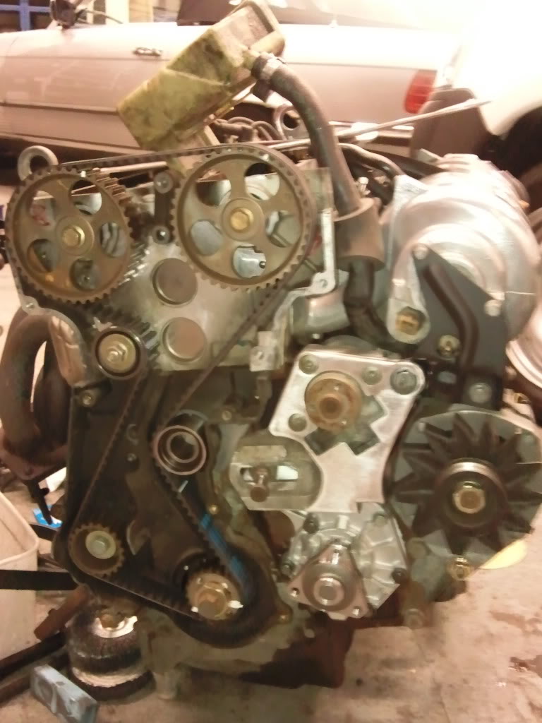

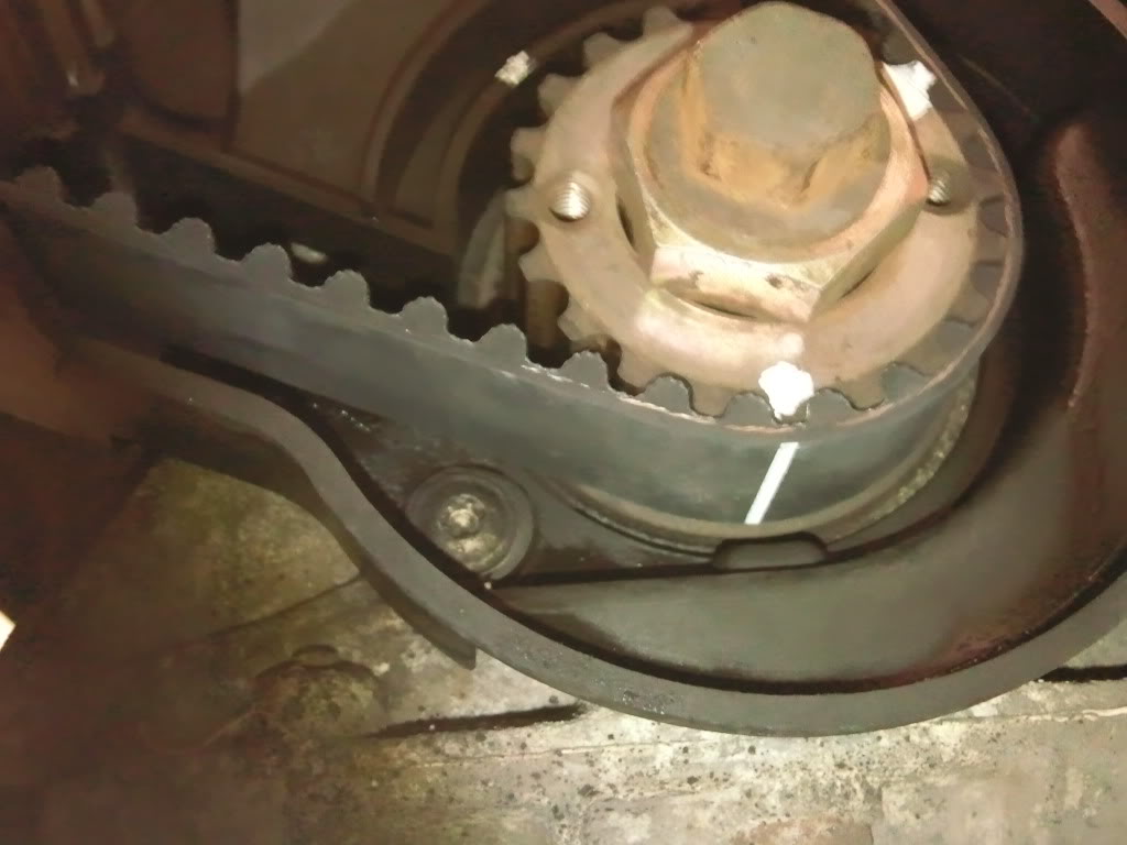

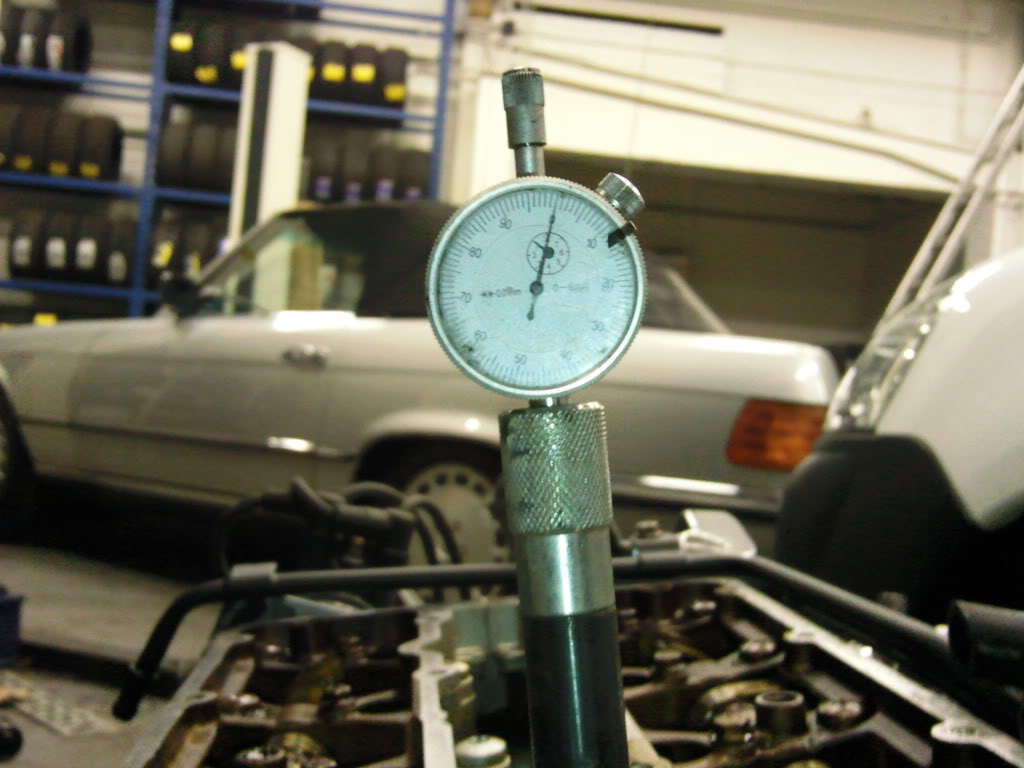

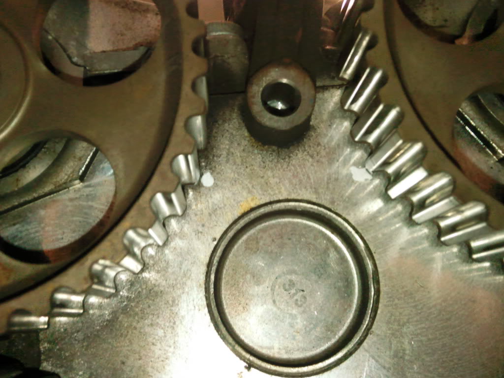

put a dti gauge in number one piston got it to dtc,removed the covers and pulleys, put a big nut on the bottom pulley and put the bolt back in, then marked the cam pulleys as the rocker cover was off so could'nt see the marks.
then i got the belt out the box and all that time i spent marking up and using the dti gauge was a waist of time, as the new belt had the timing marks on it, but i suppose better safe than sorry.
it timed up nice and easy

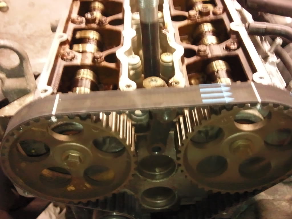

crank shaft pulley with the mark on the bottom
and the marks on the cam pulleys

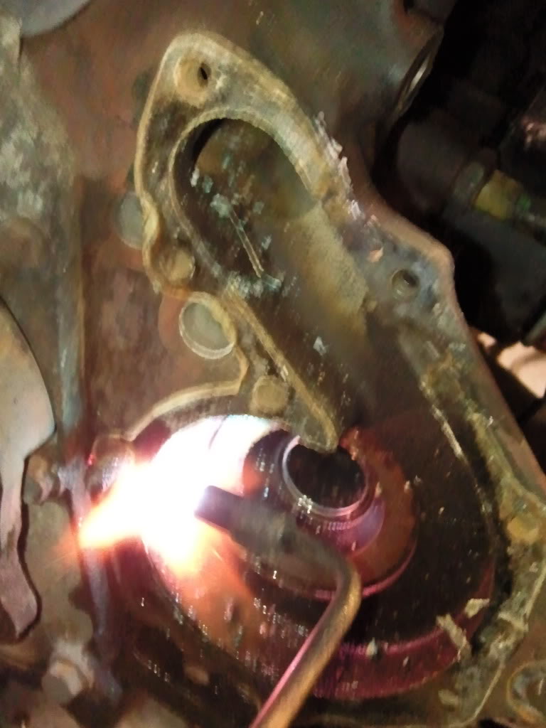

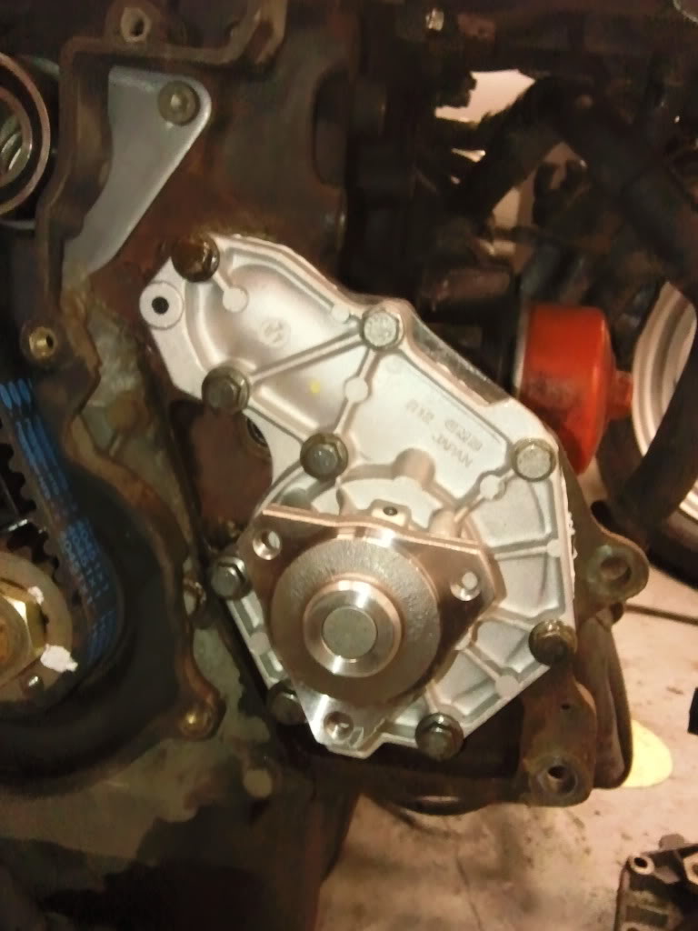

then started on the water pump, all i can say is the french need to start making cars easier to work on, there is no way you could do this job without dropping the engine, anyway had to take loads off to get to it, then two bolts broke taking the pump off
lucky i could warm them up and they broke off in a way i could get hold of them with mole grips
and the pump fitted, managed to find two bolts in the workshop, what a weird thread size they are, lucky to find them
ran out of time tonight so as far as i got, ready for covers and pulleys
nice thread mate. dunno how iv missed it tbh lol. cars lookin well.
btw...water pump is a couple hour job with engine in situ. ;)
and gsf supply most parts, belts etc ...cheaper than reno......and they even come in a reno box ;)

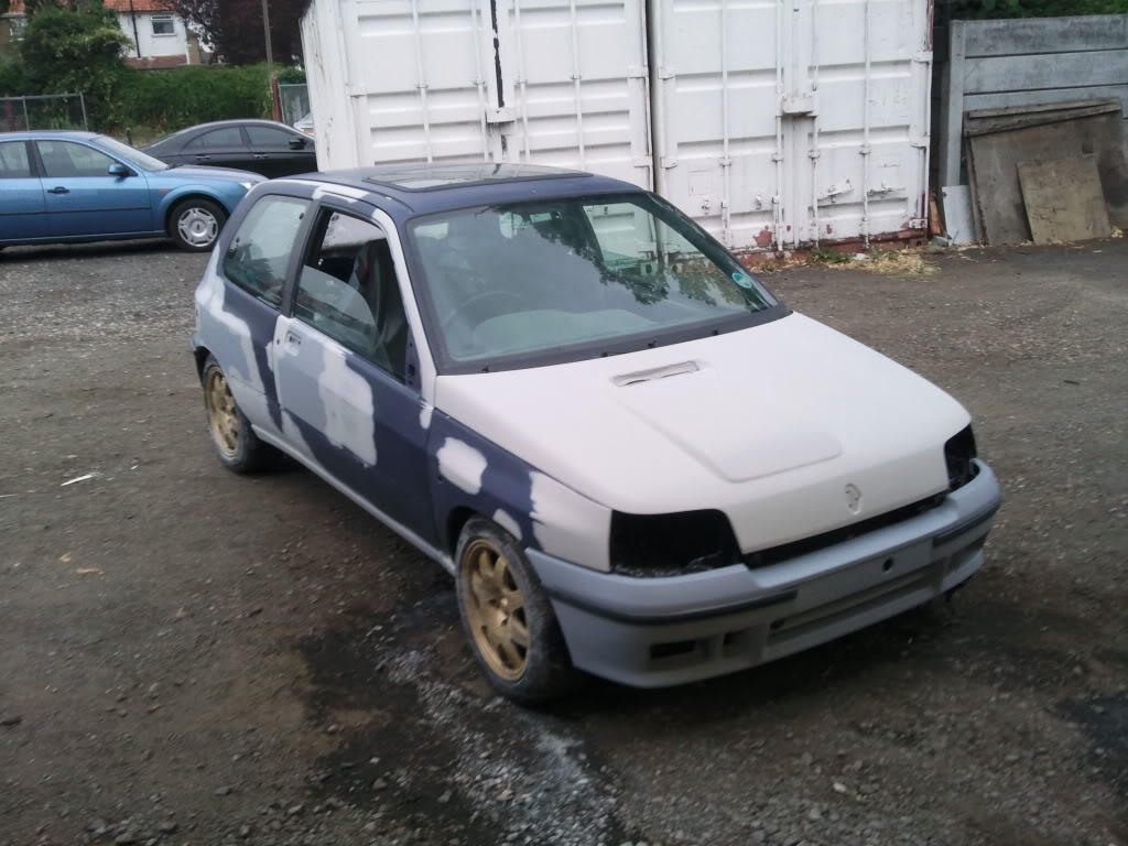

not been on here for a while, and only just started work on the car in the last month.

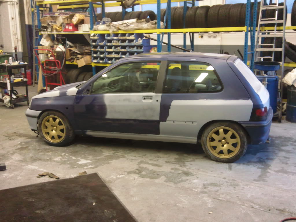

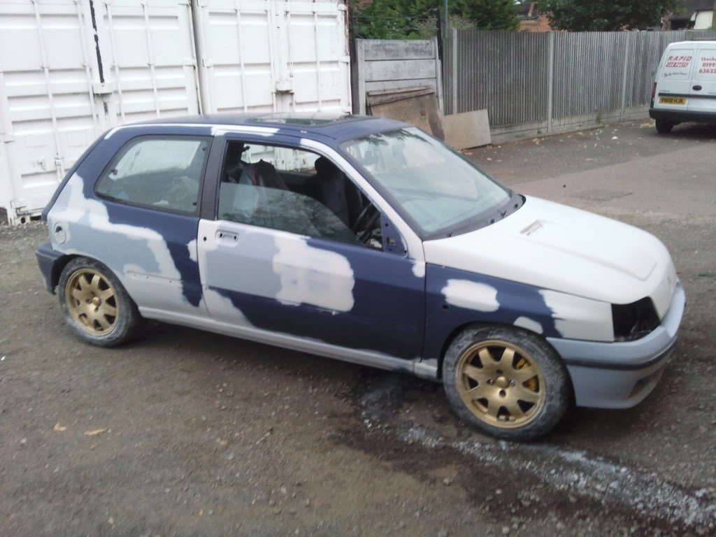

i've got most of the panels now in primer, just the nearside door and the front wings to prep!
just a few pictures how i left it tonight!
pictures were taken on my phone sorry about the quality

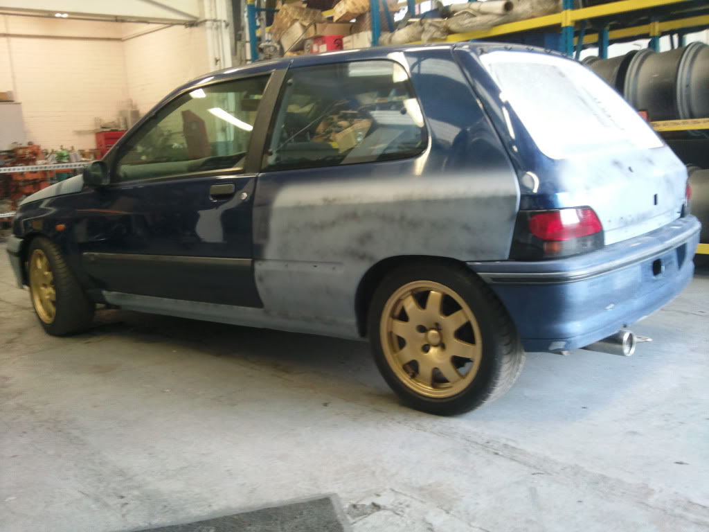

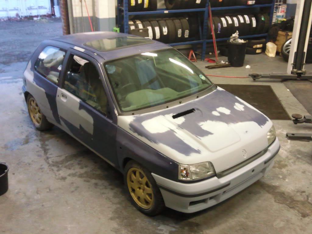

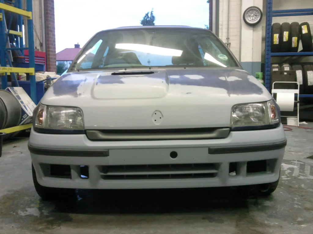

just an update

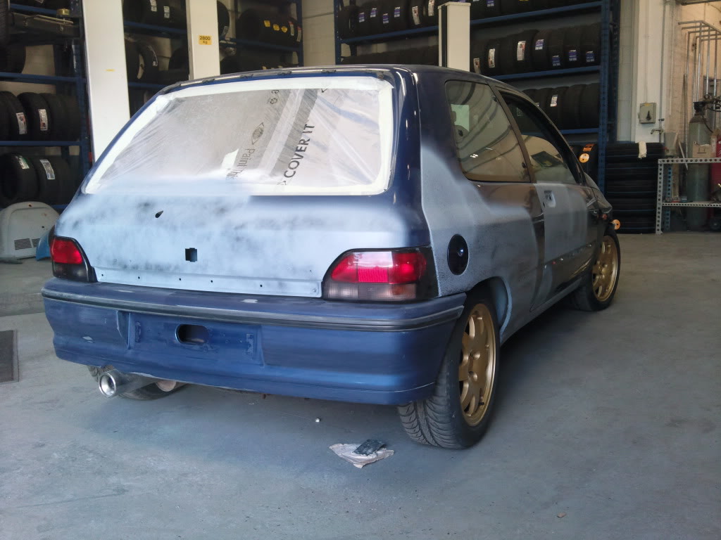

the car is all rubbed down apart from the n/s door, that i'll do tommorow, then more primer on some bit i'm not happy with!
i've sprayed the sill panels with the front wing removed with a water based stone chip so they can be overpainted.

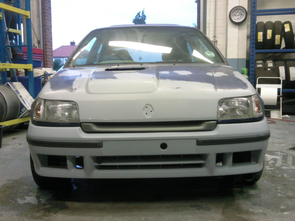

i mocked up the front so everything lined up, the grille was a bit of a pain, but happy with it now.
i wasn't going to paint the roof but thought it's only one more bit and found one tiny bit of rust so sorted that as well.
as you can see i removed the rear screen and spoiler
oh and what do you guys think of the front indicators, not sure if i like them

Just read from the start, looks awesome dude. Great buy for £300. What are you upto so far in costs? Indicators are gonna get cries of 'Silver visions' shortly on this forum..
Daz.
  Clio 200 RS EDC
don't mind the indicators too much, are you getting fresh headlamps? they make such a difference!
Just read the thread in full mate. Absolutely amazing what you have achieved.
I look forward to seeing the finished article mate. Keep us updated please.
Gaz_
  Extreme mode
Looks ace. Keep it original, that includes the indicators ;) New set of headlights too ;) Chop chop!
  impreza p1, williams 3
thanks guys, i think the indicators will have to go, the headlights aint too bad the indicators make them look bad! the fog lights do need replacing on the other hand!

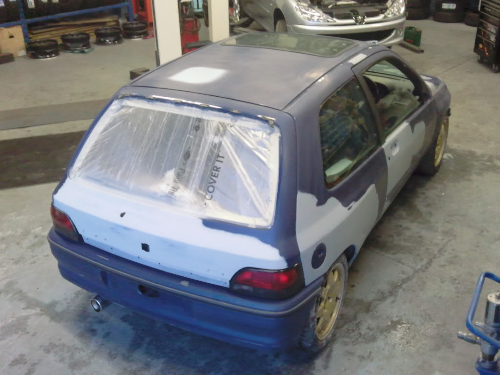

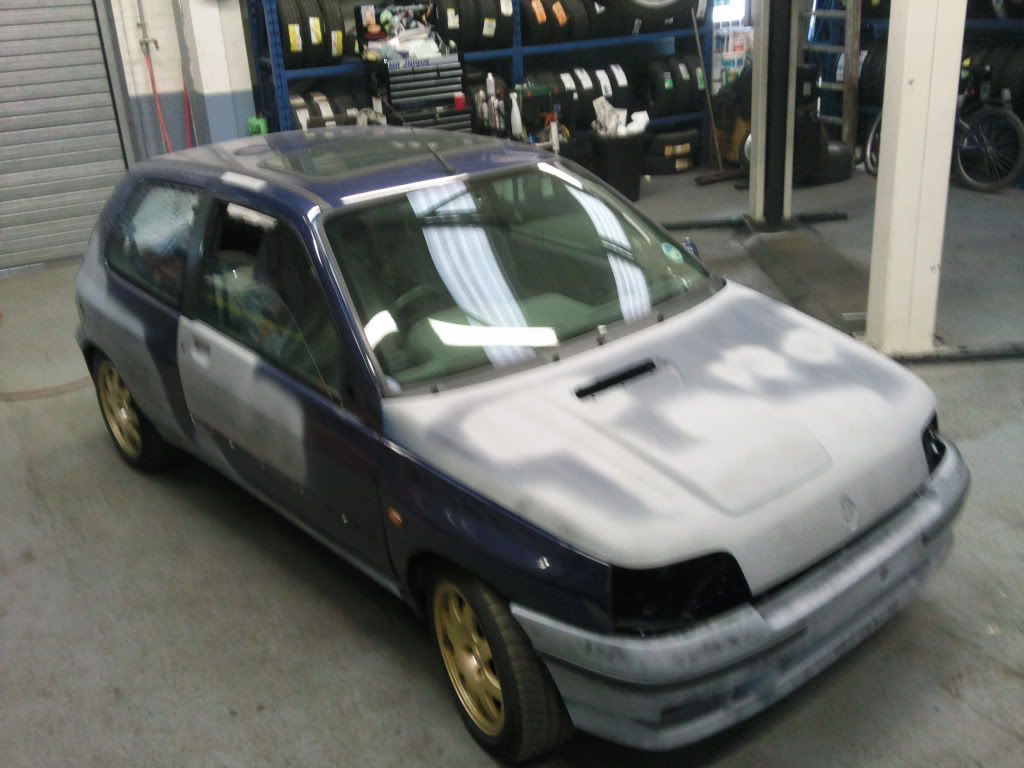

small update, the car is very close to going to the spray shop!
i've primered the areas that needed doing again, and started flatting with 800 gritt wet, it'll be ready with a couple more hours of rubbing down, so painted very soon! :D
only a couple of photo's

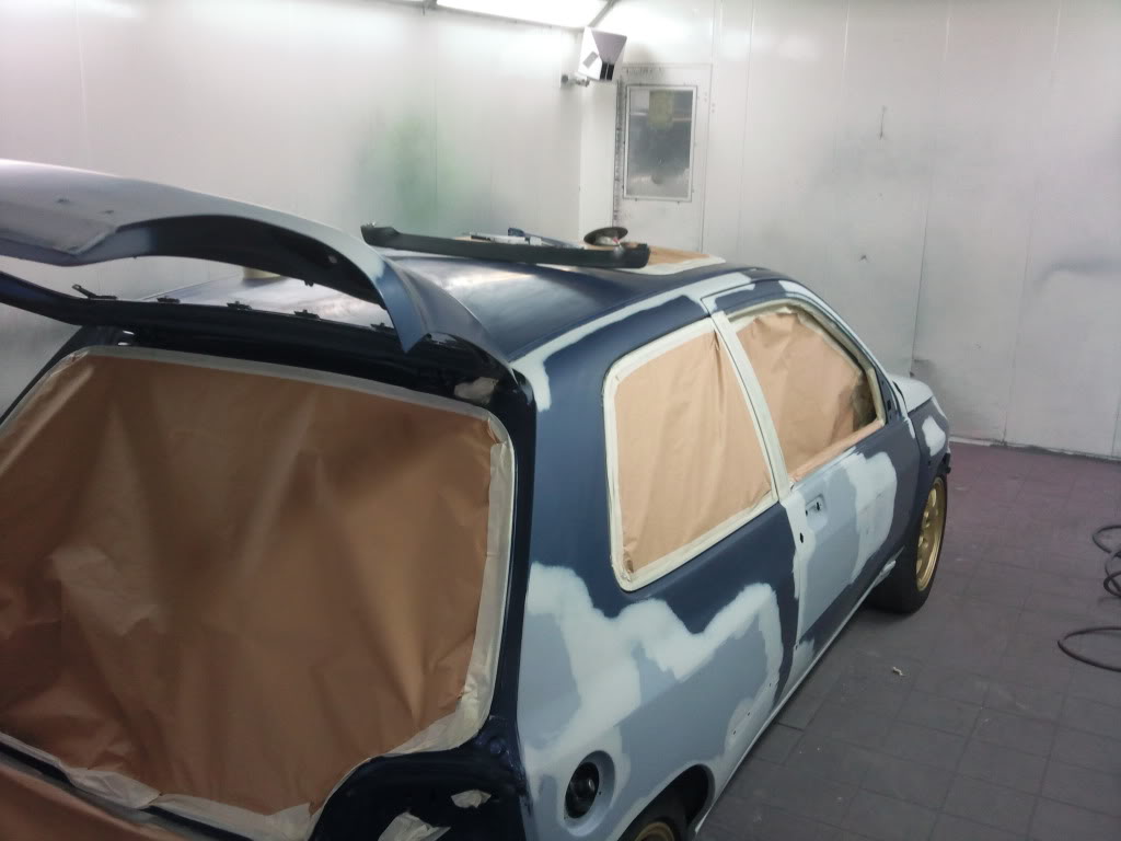

the cars in the paint shop all masked and ready to paint first thing in the morning, i'll put some pics up soon

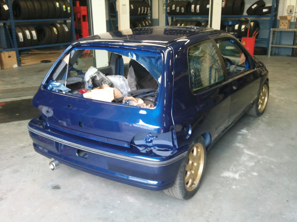

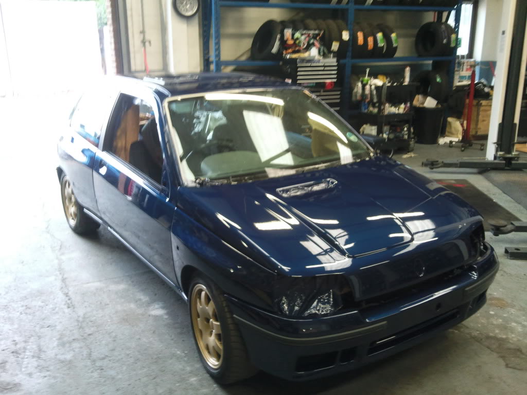

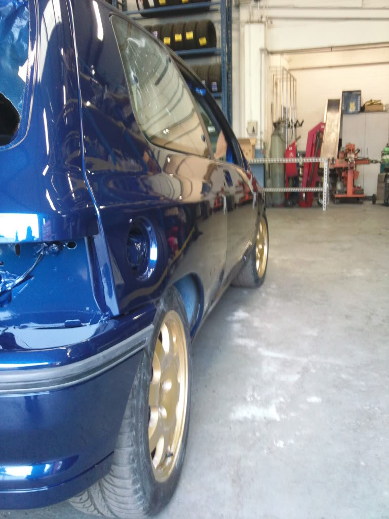

the cars back from the paint shop, just a few pics off my phone, so pants quality
in the booth after spending a few hours masking up!
freshly out of the booth
and back in the workshop
a couple of shots of the sides all before the polishing starts

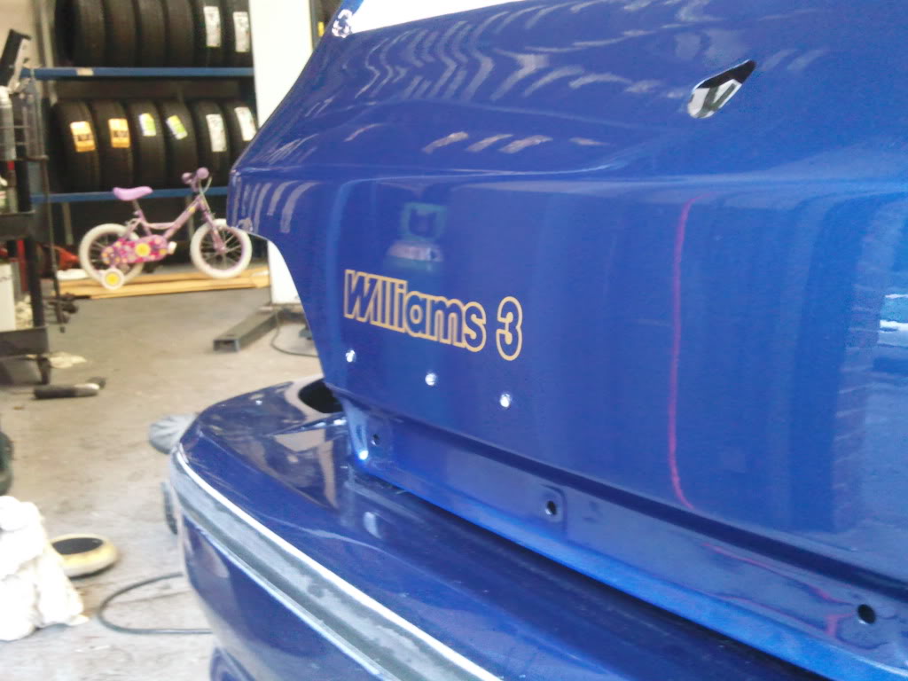

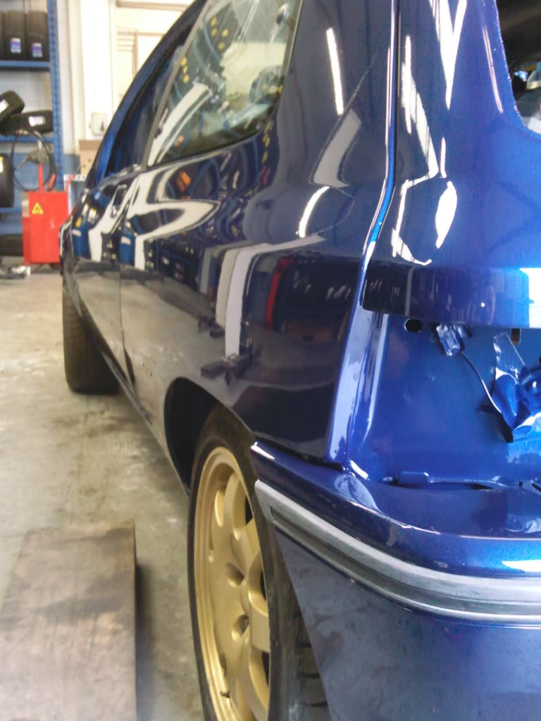

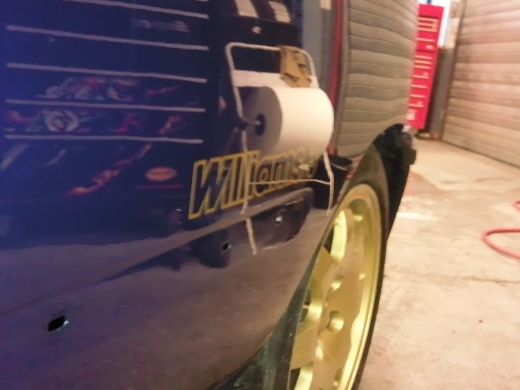

all i managed to flat with 2000 grit wet and polish today was the roof boot and n/s/r wing, couldn't wait to get the stickers i made on
i'll get some decent pics up soon, thanks for looking
