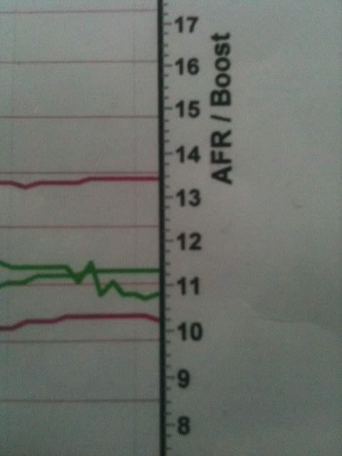

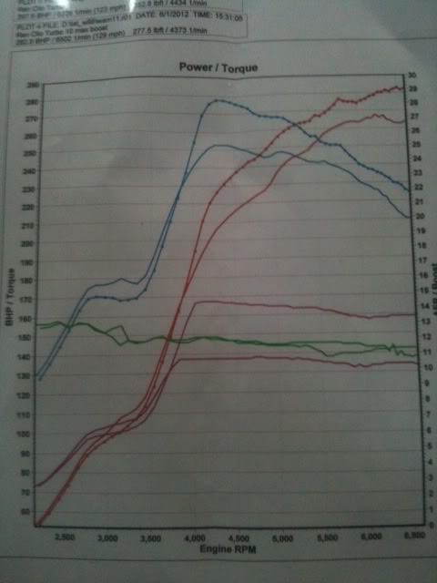

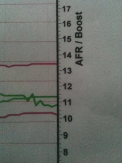

Updated with Graph
  BMW 535d
Basically the injectors maxxed out at 283bhp and 277ftlbs. So its currently running 13.8 psi. Very happy with the results at the boost pressure.
Maybe more to come, new tyres needed first though. Unfortunately bigger injectors will require another remap.
Possible 350 with 20psi lol?
  182/RS2/ Turbo/Mk1
If you put more midrange boost in you should be able to run much more torque without maxing the injectors it's only at higher rpm where the induction stroke time base is diminished it will really struggle.
At 4500rpm those injectors will clearly be happy to do over 300ftlbs
Fitting bigger ones is a better idea though of course!
  182/RS2/ Turbo/Mk1
Do you have a boost controller built into the ecu as part of your instalation or are you on a manual one?
If its on electronic controlled by the ECU then he could have dialled a bit more in, but if its on a manual one they couldnt put it in just in the midrange anyway.
Plus it probably drives nicer like that anyway as with the extra midrange it just leaves them feeling flat up top.

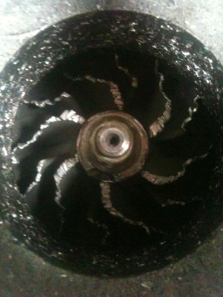

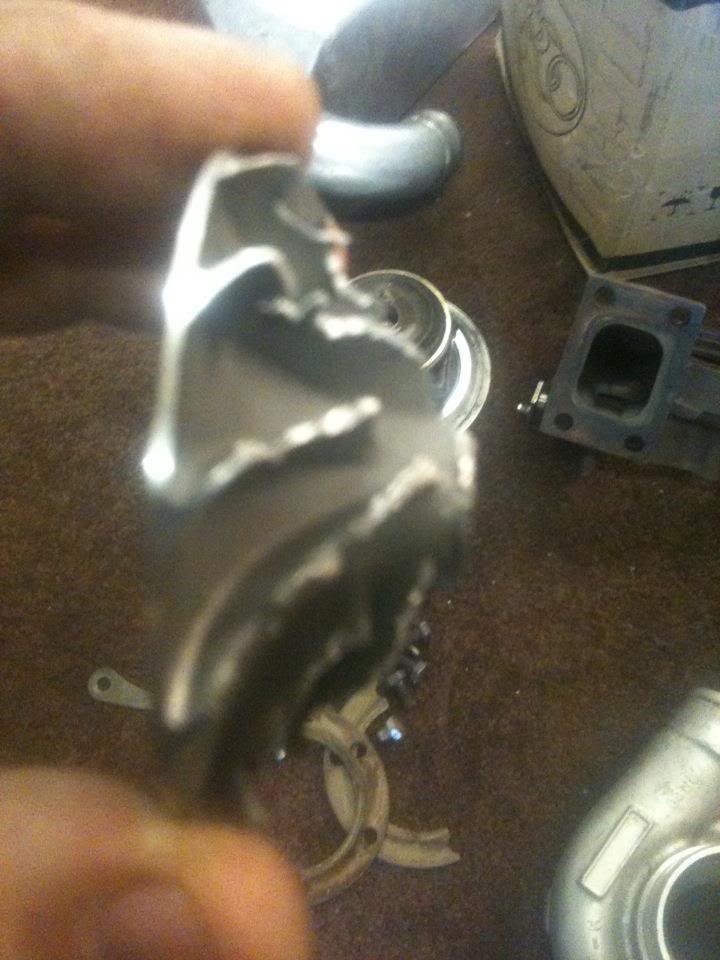

When disaster struck

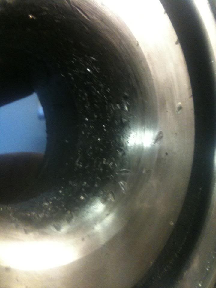

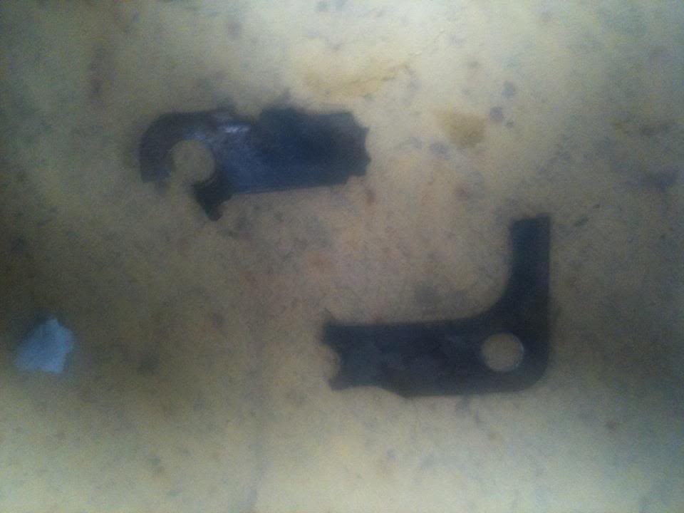

Gotta give the turbo credit, it was still producing 5-6psi lol
Luckily my chargecooler intercepted the debris and no damage internally was done :)
Chip what do you make of going from a rolling bearing to a non roller out of interest

I dont think at a relatively modest power level like yours there is much gain from a roller TBH mate.
