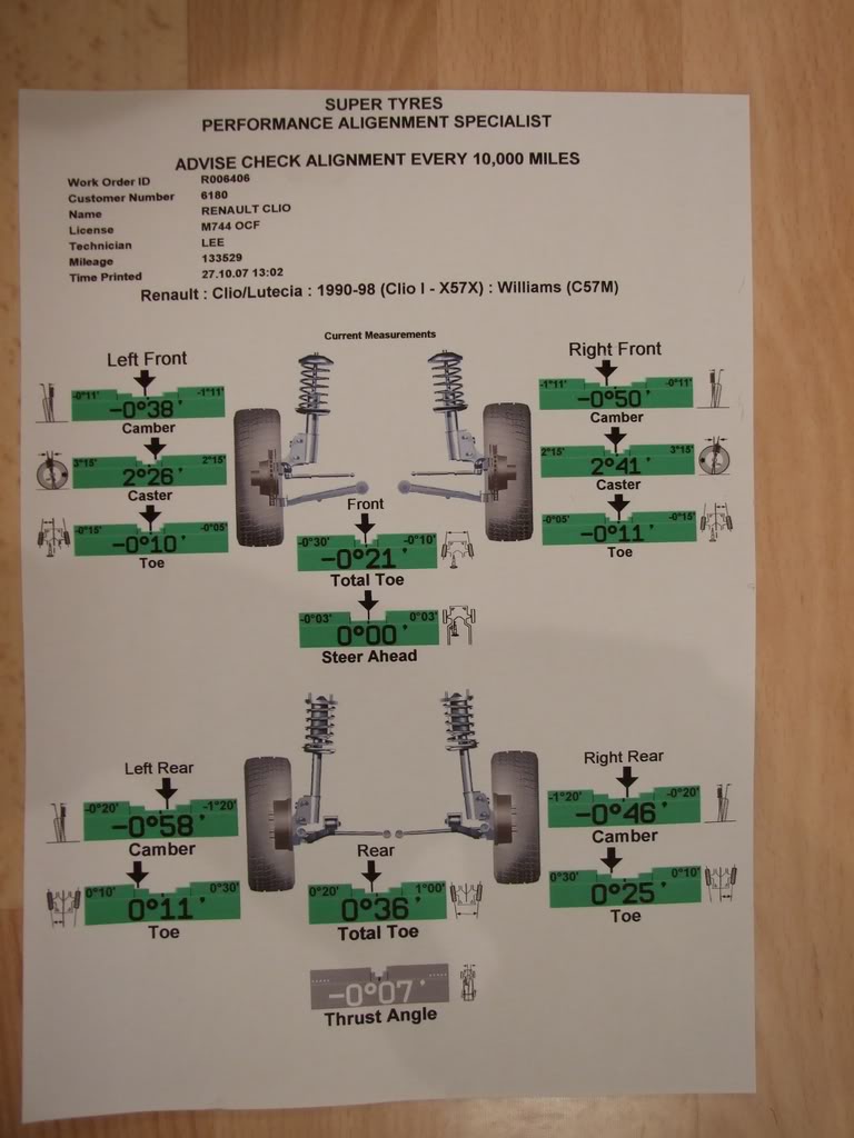

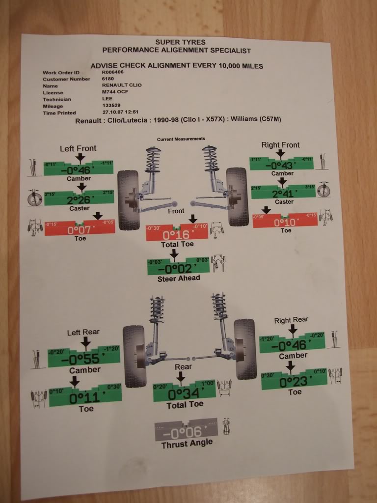

It's one of these Hunter 4-wheel laser setups that I've used before - last time it came out great but they seem to have used different settings this time :S
Last time (apologies for the tiny pic):
This time:
One appears to be toeing in and one appears to be toeing out? I think the different model names at the top might be a bad sign...

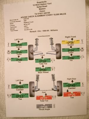

The thing is that this time round, before it was set up, it looked like this:
which is very similar to when it was set up last time, but it was handling possibly worse than it is now as it *really* didn't want to turn in and was following cambers etc shockingly badly. It's not tyre pressures as I keep them topped up regularly, so I think it might be steering rack, as suggested above and on WC :(
