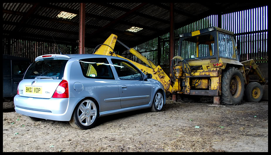

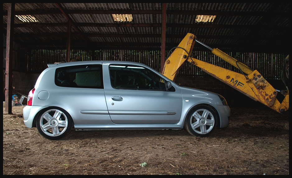

Here are two quick pics from how it stands today, bearing in mind the ground is far from flat, but it the same concept on perfectly flat ground, you can clearly see the front is higher.
They are v-maxx's as stated. They state 60 back 70 front i think,however the back is fully down, closer to 65mm, and front i have no idea but can go at least 120 as they have a threaded strut all the down to the hub bolts.
Im a slammed who-re sadly. So definally want to lower the front more, i just want someone to tell me i dont have to spend 150quid on setting up to take the front down literally a touch.
cant imagine it changing much tbh. may need tracking redone at most but thats it i would imagine. think about dropping your car on springs. hardly anyone gets a full geo after a 40mm drop on springs since the difference isnt noticable so i think a 10mm drop wont change much but thats just my opinion.
That's definitely nose down already. look at the angle of the sill. Remember the front arches are bigger because of the wheels having to turn ;) A good example, I fitted bilsteins to a ph1, then checked the toe. it was toeing out a lot and the steering was far too light, with no feeling
with a 10mm drop, the furthur you drop it from where it is now, the more toe out you will get. You'll see gradually more camber too. You can get the setup very good without a full alignment as long as you have a flat floor and some gauges. We dont offer it commercially, but can do a basic setup when we fit suspension.
