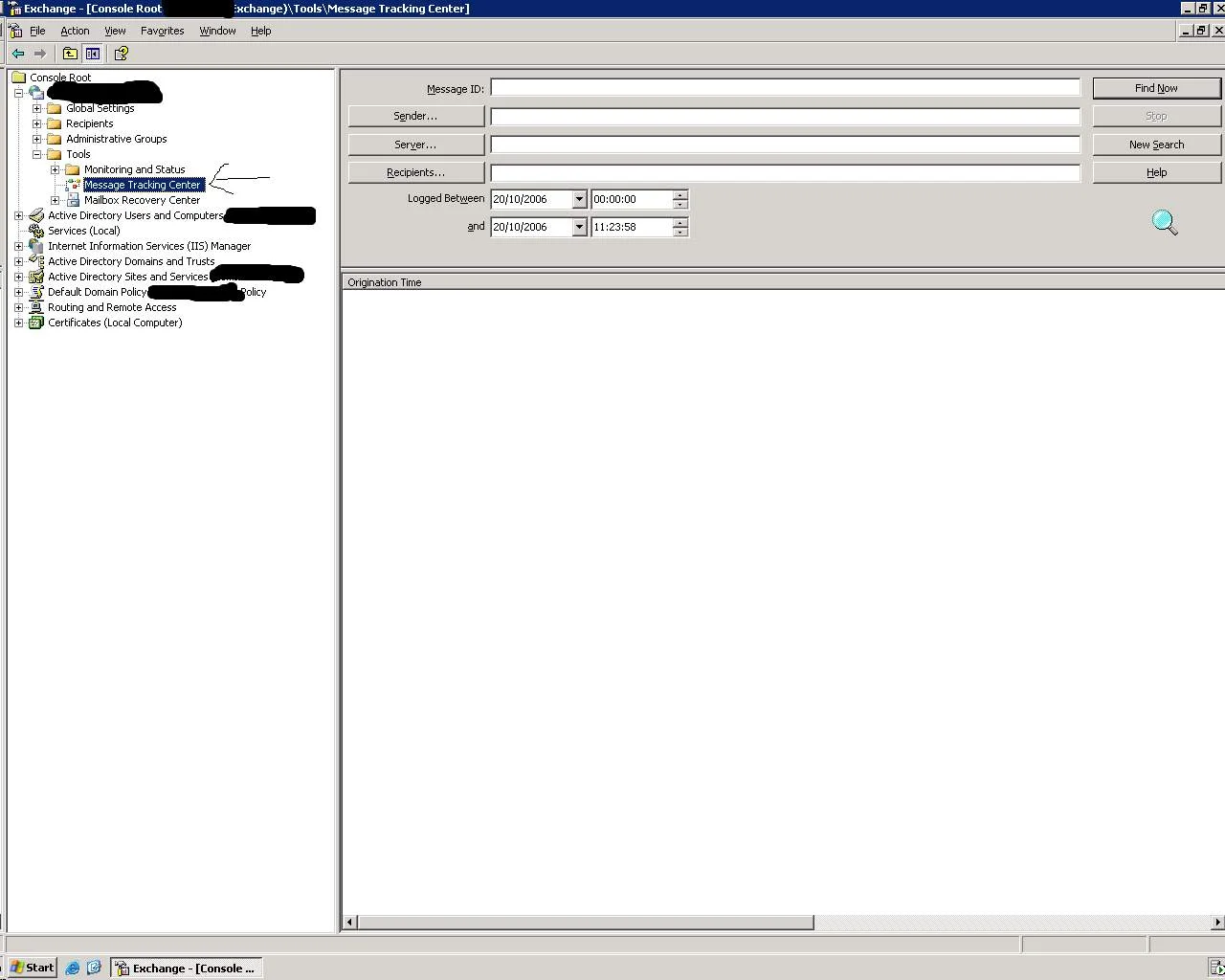

With regard to emails. You can track mail only if you have message tracking enabled, which we don't have... and i'm not sure how to turn on to be honest.
You can find the search thing in Exchange Manager (see screenshot)
Sorry if this all isn't what you need or technically at the right level for you.

As for message tracking - its not switched on either. Balls.

Message tracking centre is your friend, not the most slick thing out there but it should do the job.
