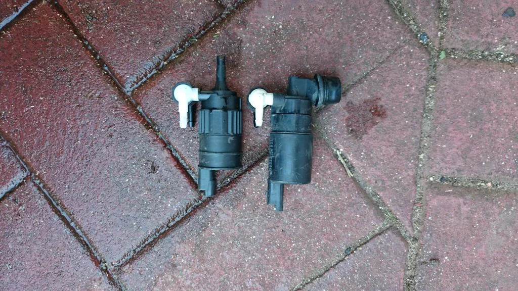

how come there are two pumps on the bottle, two water pipes on each?
and how come the replacement pump I got looks nothing like the one in there?
  CursedTitanium 182FF
You have bought the wrong one. New on the left old on the right I take it?
See my post above.
1 pump does the front and rear screens and the other does the headlights.
davo172
  TCR'd 172
One on the right is correct from what i remember both pumps are same on 172 bottles thou

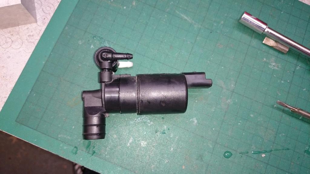

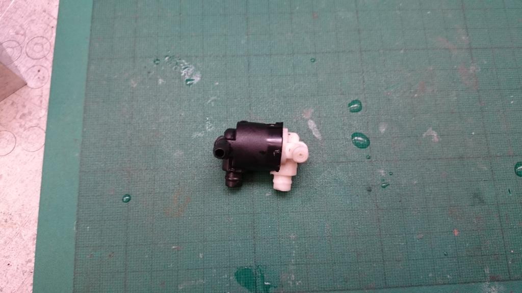

so the pump in question
applied 12v to it and it worked fine
but put it in water and turn it on, no water out put
after removing a few parts it came down to this being not allowing the water through

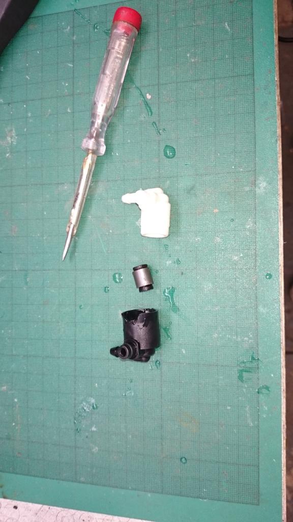

took it to bits
something is up with that little bit of plastic in the middle, I couldn't work out what. removed it and the pump worked perfect, water output, although I was aware not having that part in may cause other problems.
put the car back together and the only issue is when I turn either washer jet on back or front they both turn on at the same time. so that bit of plastic must be some form or value.

The washer motor runs one way for the front wipers and reverses for the rear.
Headlamp pumps is the same, cleans one headlamp, reverses and cleans the other.
White bit is the valve between the two outlets.
Sounds like your pipe or jets are blocked??
