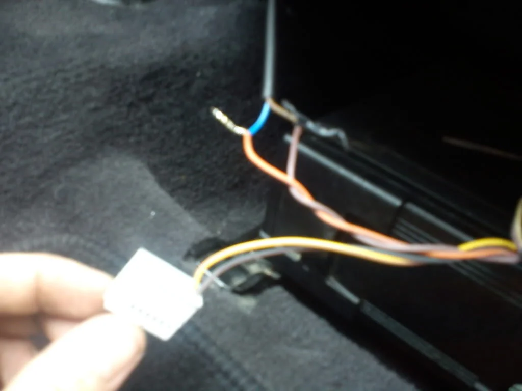

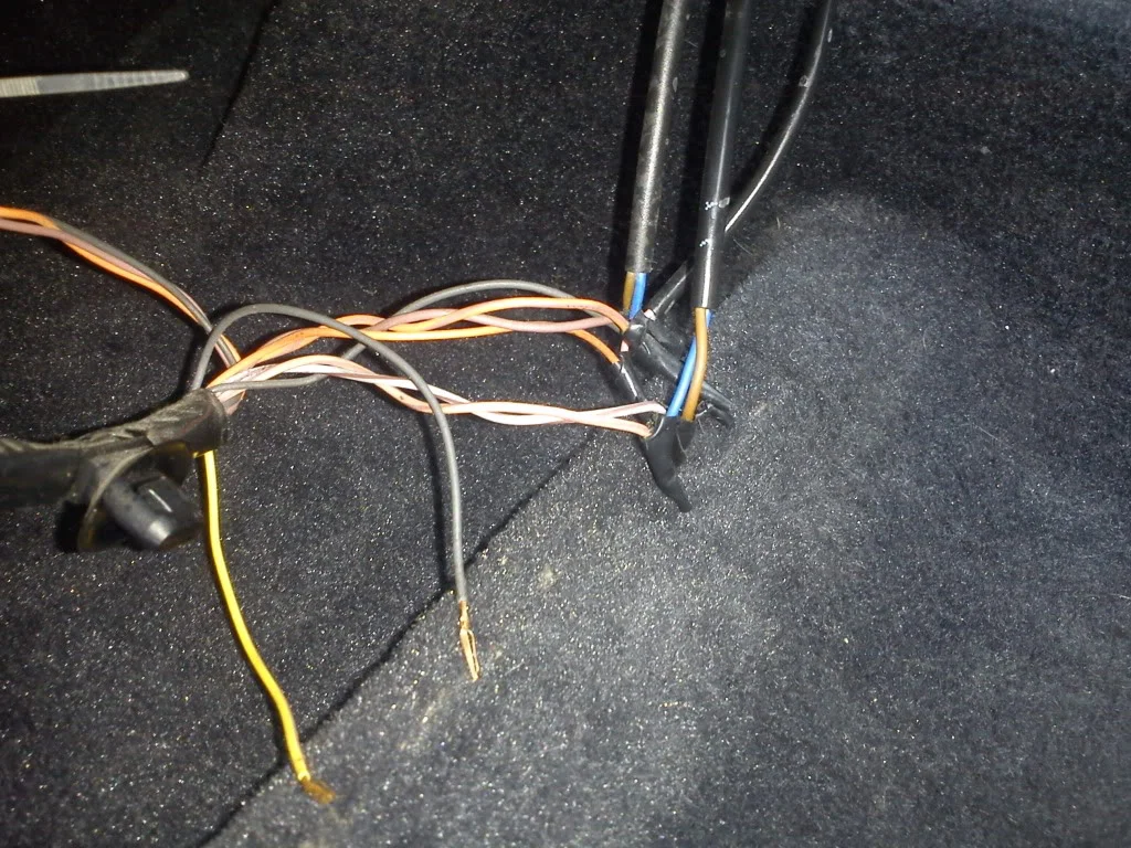

hi all im looking for a wiring diagram for the cables under both seats in mk2 ph2 172. some are taped up and some are loose. if someone could point me in the right direction id be very greatful.
DRIVERS SIDE
PASSENGER SIDE

basically its the wiring for all the pretensioners and side airbags in the seats.
passenger side - i believe that the wires soldered together are for the side air bag (blue to orange, brown to pink) check and follow the wires back if it goes under the seat and round then you find it! dont quote me on this tho! check some other threads!
