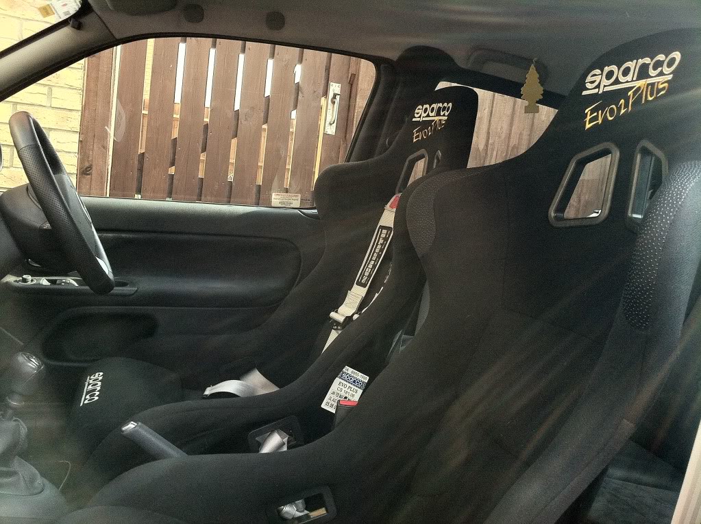

If anyone has a 1*2 drivers seat I could borrow for a couple of weeks let me know. The recaros are going...
  Mazda 3 MPS Mk1
Re: Dave.'s Trumpeted Engine Spec, Cammed Up Gunit, 2118'd Carbon obsession
A few updates!
I met up with Jenic off here the other day and we sorted a little deal for my recaro's for his fixed buckets, met at Donny services and swapped them over. Will miss the luxury of the recaro's but the way the new seats hold you in place is brilliant, have so much more confidence in the cornering abilities of the car now! :D
Not a great Pic but you get the idea!

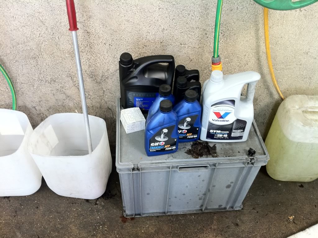

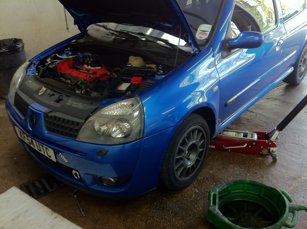

Also today i spent the afternoon giving the old girl a bit of a service, it has full service history up to now, but to be honest i doubt ill ever sell it so im happy with servicing and just making a note. Its only been 8k since the last service but with three track days and the ITB's since the last service i thought i may as well.
So i got the following:
5l Valvoline SYNpower 5w40 Engine oil
Genuine Renault oil filter & sump washer
3l of elf 75w80 NFP Gearbox oil
New Gearbox sump plug washer
7l of Renault Type D coolant
All sorted fairly easily draining etc, until it came to removing the old oil filter, what a b*****d!! because the trumpets are right over the top i had to go in from the gearbox side underneath and was v difficult to get it undone, managed it in the end though!
The oil that came out of the gearbox smelt wrank and was like treacle, the new oil has spruced the gearbox up quite nicely! It literally took exactly 3l before it trickled so i must have emptied it well. Also im not sure if its the placebo effect, but car sounds a little quieter on tick over now, maybe ive cheered the dephaser up with some good quality oil!
All sorted!

Fixed subframes? I sold them to Mike lol
Looking good
  Mazda 3 MPS Mk1
Yeah thankfully were the same height, would have been a PITA otherwise!
  Mazda 3 MPS Mk1
Dave i did fit in yours! but these are a bit more friendly everyday, plus i didnt have to breathe in lol :eek:
jenic
lol, he tried to swop those for my Recaro's as well, but umm, how do i say this .... the 'Plus' ones were a little too plus sized for me ;)
:dapprove:
You know the 2 plus is smaller than the 2? Its not much bigger than an evo at all, but a lot roomier than a rev.

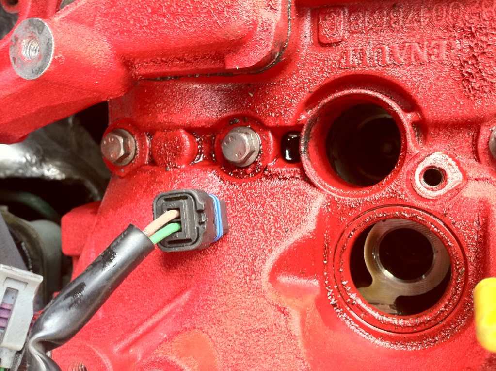

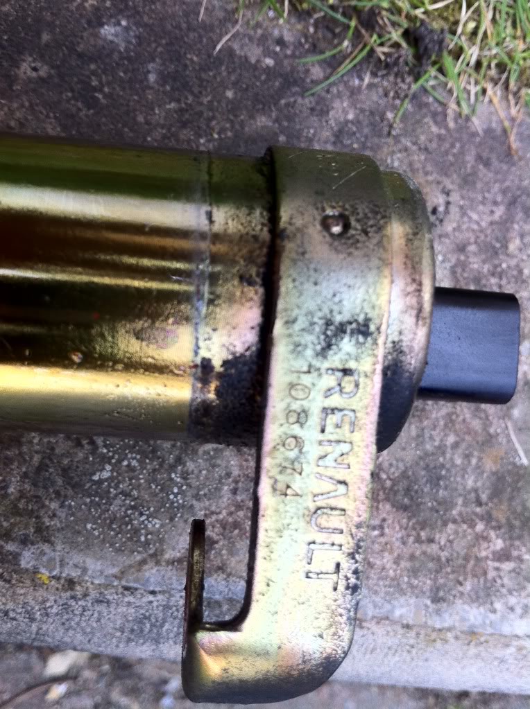

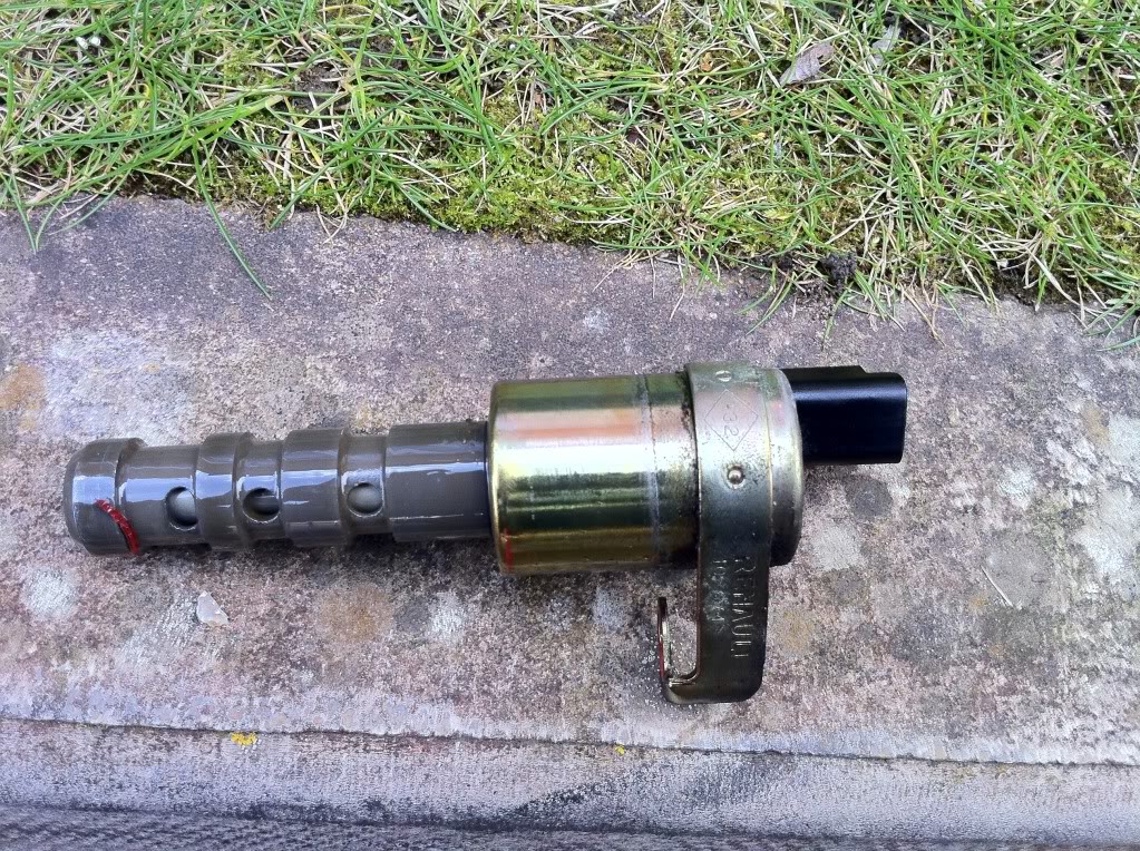

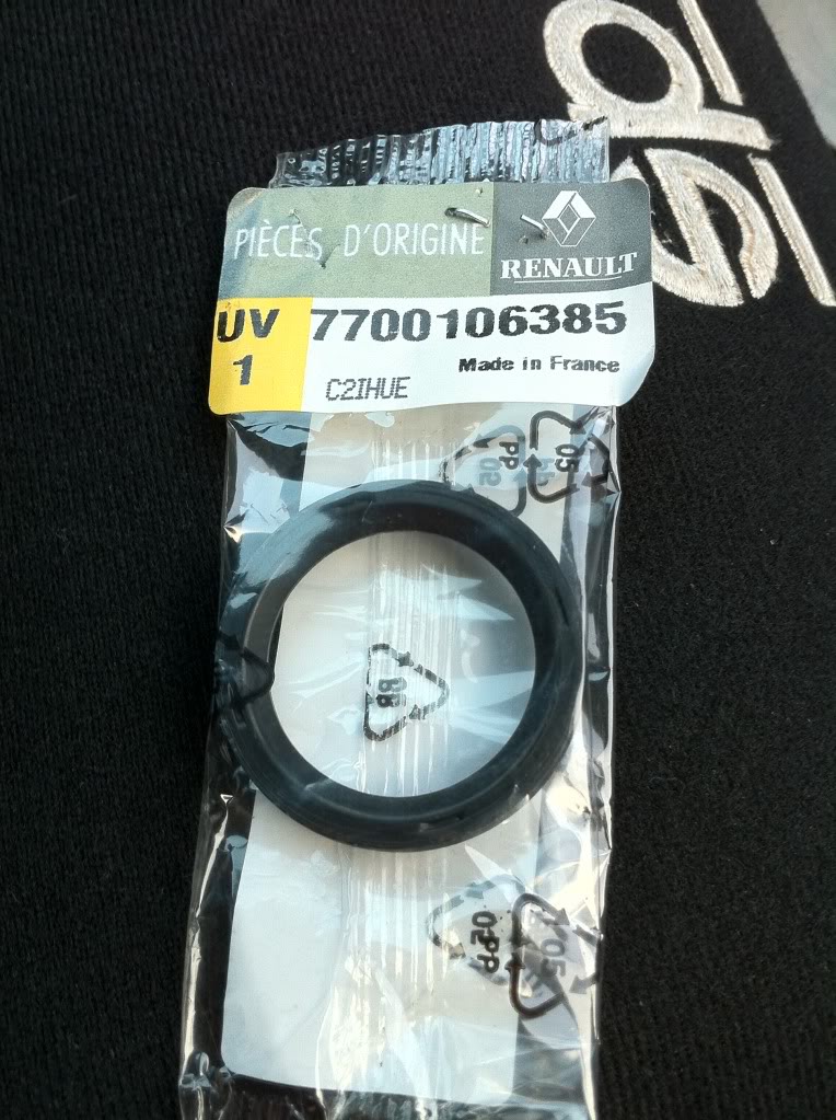

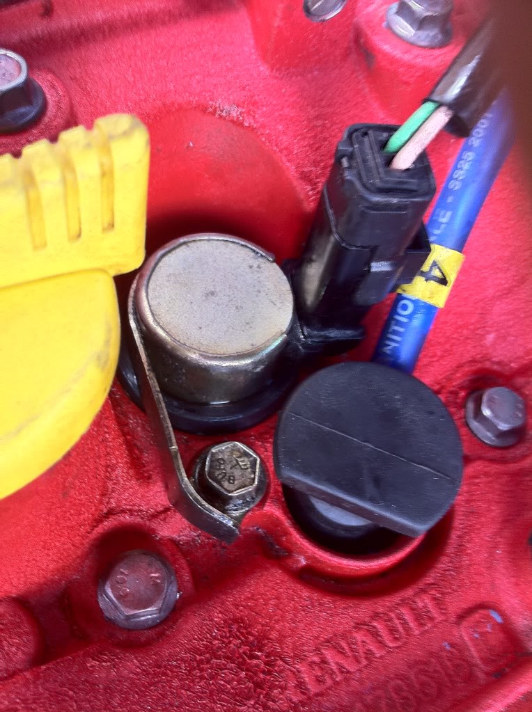

Since the car has had the cams in i have noticed a leak coming from near the VVT solenoid, and this eventually pools and then drips on to the exhaust manifold. its not enough over the past 6k to have noticed the oil level drop, but annoying all the same so i bought a new VVT solenoid seal from Renault.
I removed the solenoid and it didnt even have the bloody seal on it! You can see where the seal has been removed, and not replaced by the ring of gunk at the top of it
And hes where the oil was pooling
you can see where it was draining off to!
So i fitted the new seal and gave it a little mop up, hopefully that will solve it. Not particularly happy about the seal being missing though :dapprove:

dave you dickhead. you can see the seal in this picture
you painted over it
