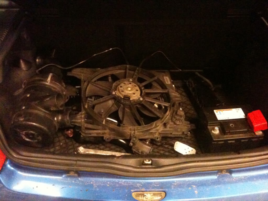

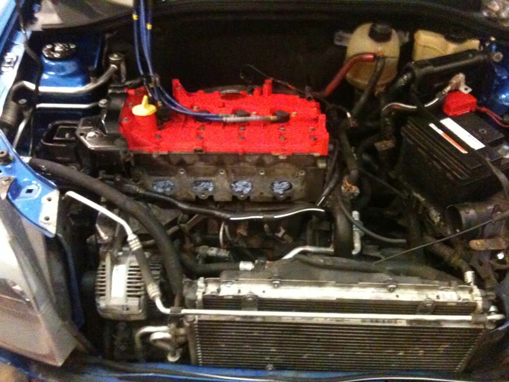

Had an email from matt, it's in bits!
Roll on Thursday!!
