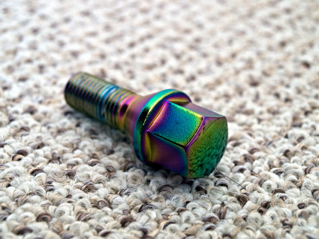

Since having the salty roads the wheel bolts are looking shocking! So given them a going over with some black engine lacquer. I doubt it will stay on well when doing them up, but gotta be better than rusty shite!!

In regards to the above comment, is it fine to get bolts chemically blacked?

No none on the threads mate!! Just the heads of the bolts, I'm a numpty but not that much of one

Yes I is numpty :p
I'll get the sand paper out! I guess they won't tighten properly if there is paint there

I think the paint gives over time and they can come lose. You can buy them plastic caps if you want to tart them up, or get them chemically blacked like I'm going to do.

I brought some caps of ebay and tbh they looked pretty good, but a nightmare when changing wheels. blahh

Sand them well...I learned this the hard way at Goodwood.
Freshly painted wheels including where the bolts seat, a few sessions/heat cycles and no re-torqueing of the wheel bolts meant I had to limp back to the pits with a very loose wheel. Was lucky I didn't lose it completely at 100mph+. All four bolts could be undone with fingers!!!

arse i was conscious to not get any on the threads, rookie mistake!
I have the bolt caps, have to prize them out with a screwdriver or pliers, them removal tool that they suplly doesn't fit! :( lol
