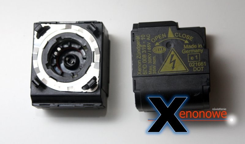

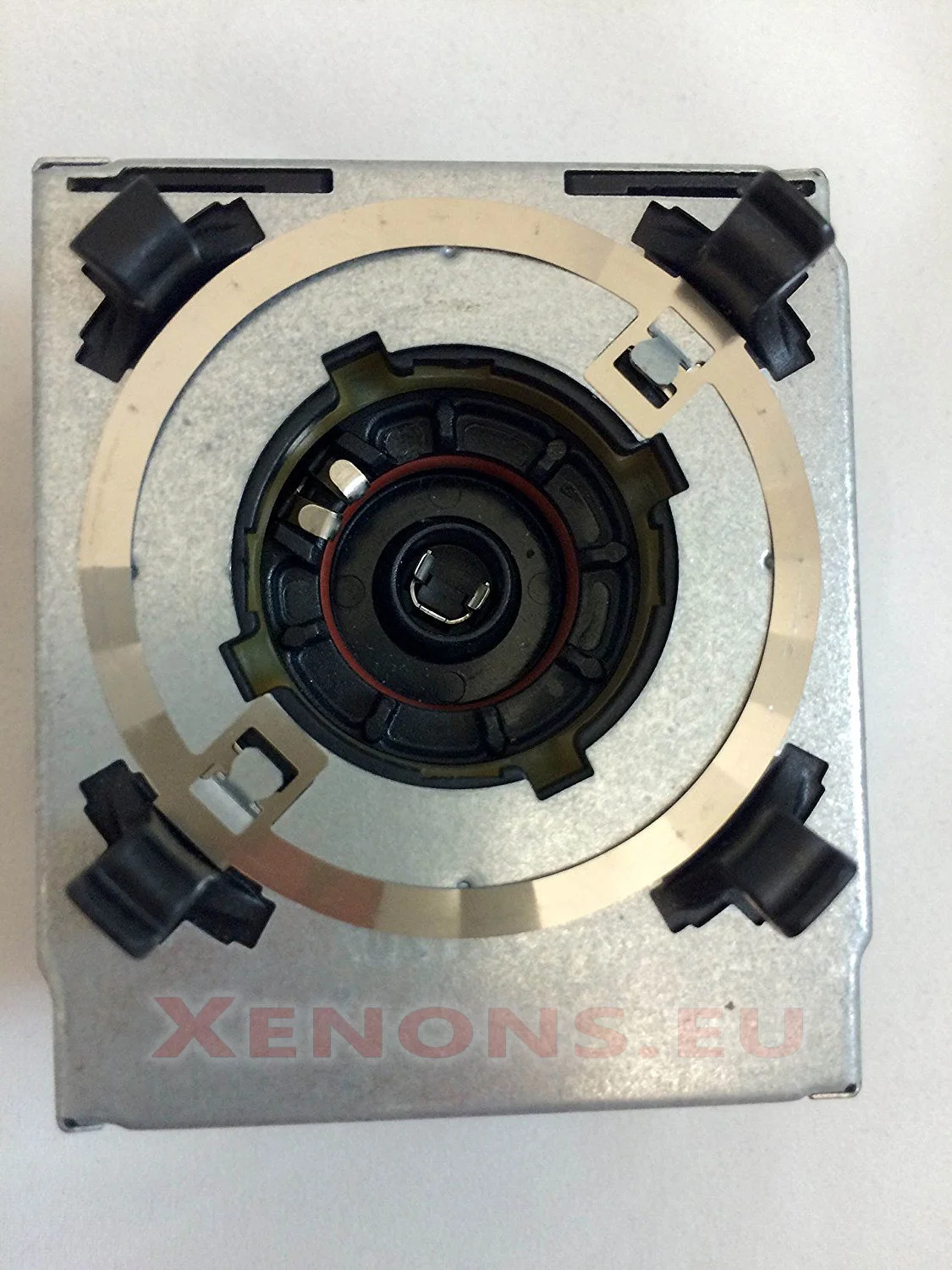

The plastic type is used on my 182 FF. In the first link the part numbers are different with the plastic reading 5DD 008 319 10 and the metal type 5DD 008 319 50 so just cross reference what you have now and order the same part No.

You are correct that the 172 has wire spring clips, and the 182 has the round plastic dip bulb holder, but having had a selection of both, they all have had the black igniter 5DD 008 319 10.
The only difference I have noticed is that not all have the wavy spring washer, though that may be because they have been lost or broken.

The wavy washer I referred to is between the igniter and the headlamp unit, though looking at these 2 pictures it`s configuration has been changed between the 10 & 50.
