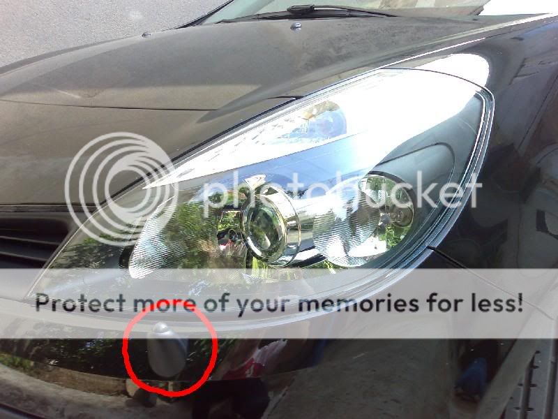

in italy was illegal because original xenon must have automatic height adjustment and headlamp water sprayers...sorry i can't translate...
a pics of that..of a phase III whit original xenon kit!
http://i712.photobucket.com/albums/ww128/MOTORSPORT1979/farixenolavafarifarivisibilitlatera.jpg
mine was a Clio II phase B....
