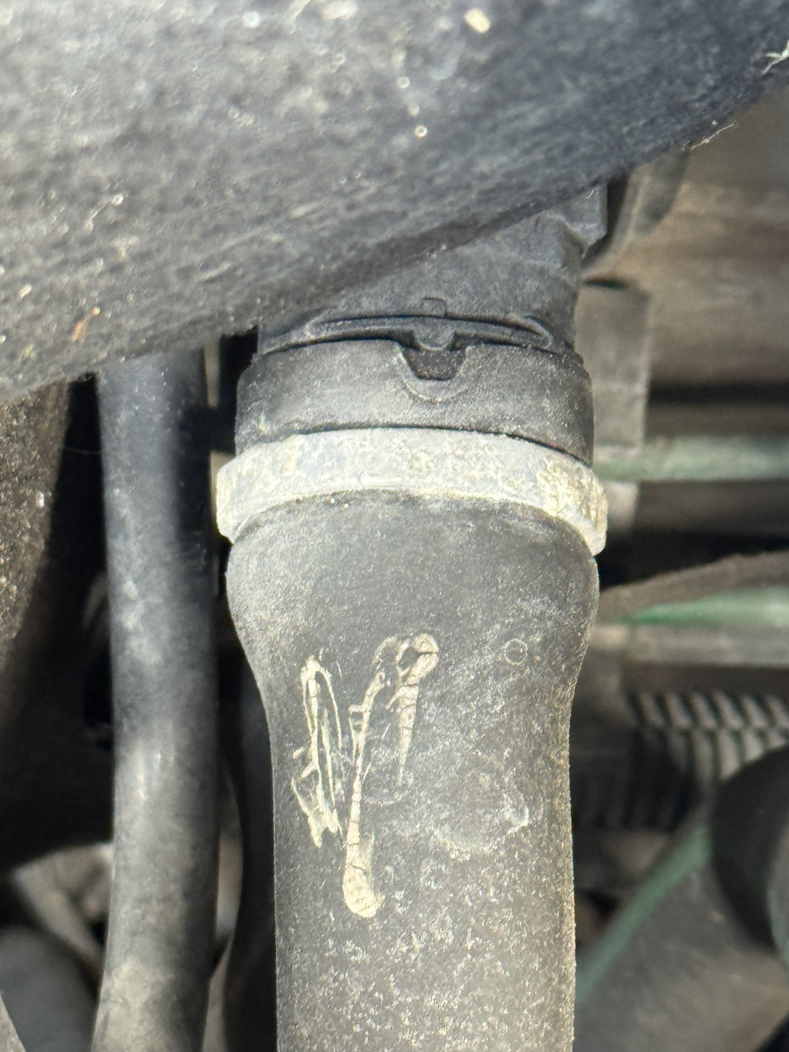

Went to get my tyre replaced this morning.
Got home and noticed water pouring out of the car and steaming from the bay.
Just about to jack it up and take a look.
Thoughts ?
  • IMG_4854.mov
    17 MB
NorthloopCup
That’s a lot of water coming out mate! No coolant pipes at the back of the engine except for heater matrix. Can’t distinguish which side it’s coming from, but could stat housing, heater pipes or water pump.

Its a gusher so should be pretty easy to find. If not fill with water and pressure it up

Has anything sharp been rubbing on that? or even if it was a small hole would the pressure then make it look so much worse?
Good luck getting it fixed in time.
Advikaz
Nothing in the vicinity mate.
I would guess it’s just fatigue (20 odd year old hoses)

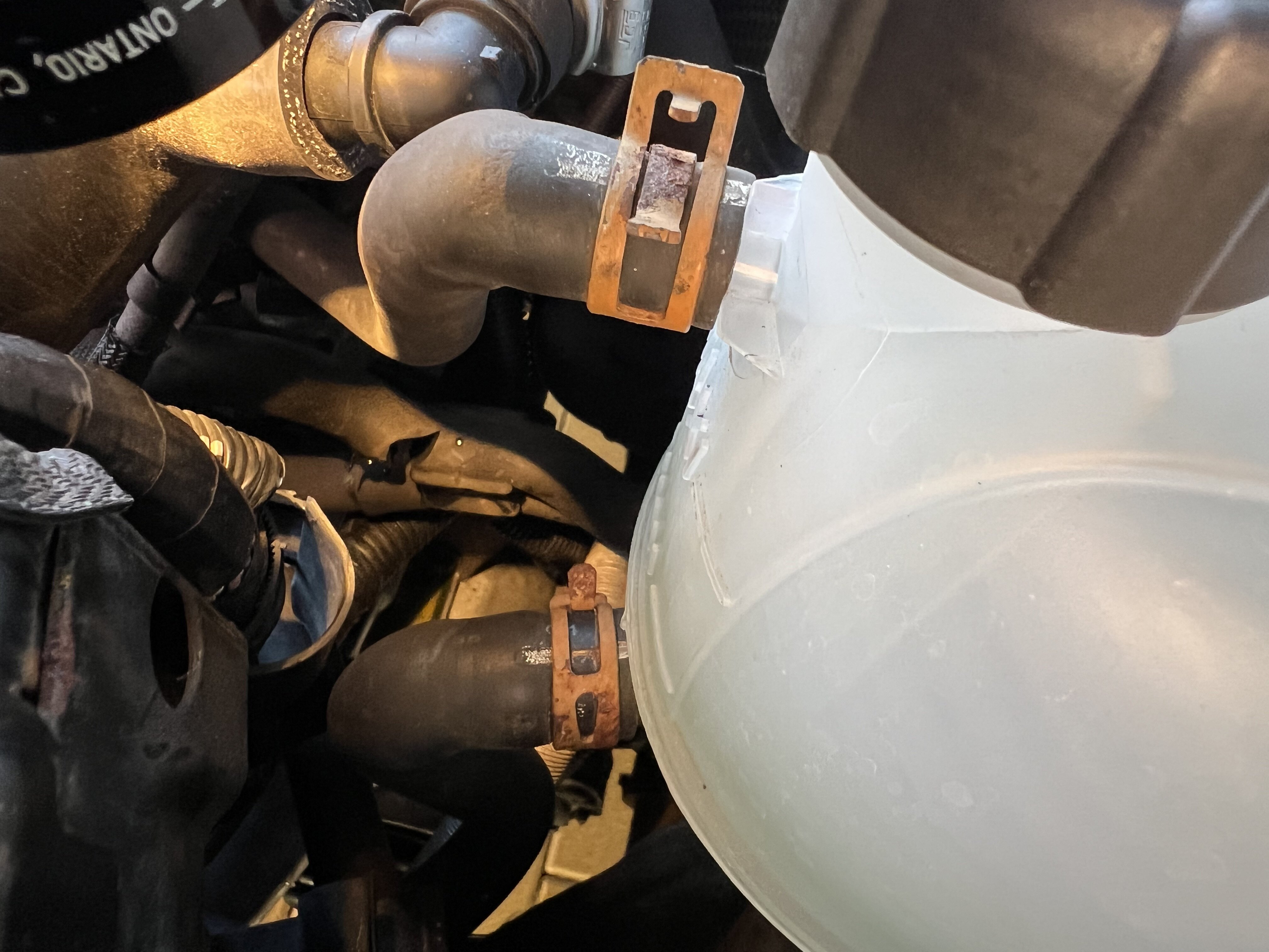

How do you get these clips off the heater matrix pipes? Is this the PITA aspect of it?
Brigsy
  T.Turbo
How do you get these clips off the heater matrix pipes? Is this the PITA aspect of it?View attachment 1742347
Set of snips or careful cut with a dremel.
Id not disturb the fittings off the heater as the o rings are most likely shagged with age. If the fittings need moving or weep after a bit of movement, new set of 4x 20mm x 2.5mm o rings sorts them out.

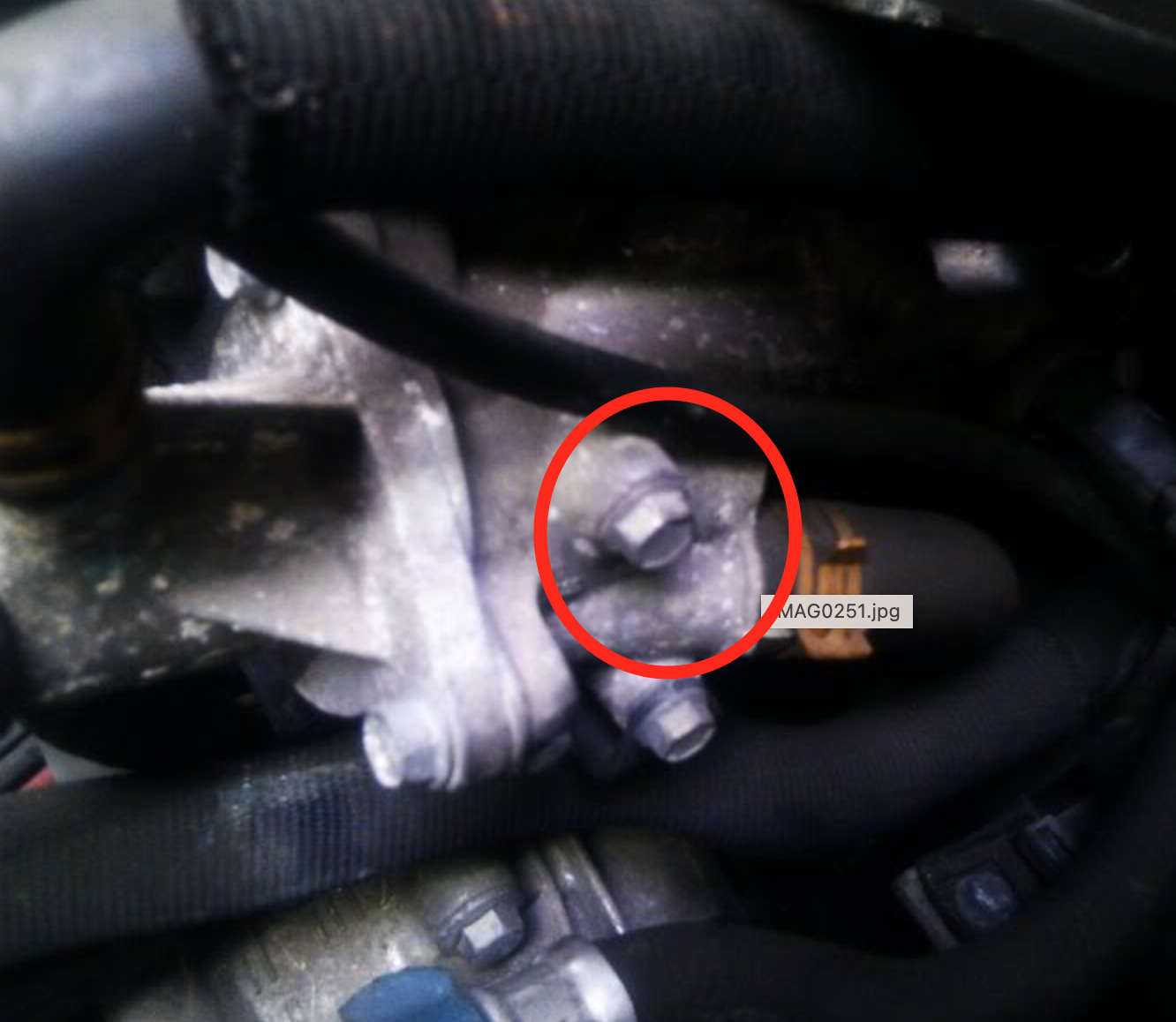

Here's the bleed port on the thermostat housing,
When you have the new pipes on, remove the 10mm bolt fill with coolant and then start and run it until coolant flows out, bolt back in and test drive up to temp and re check level.

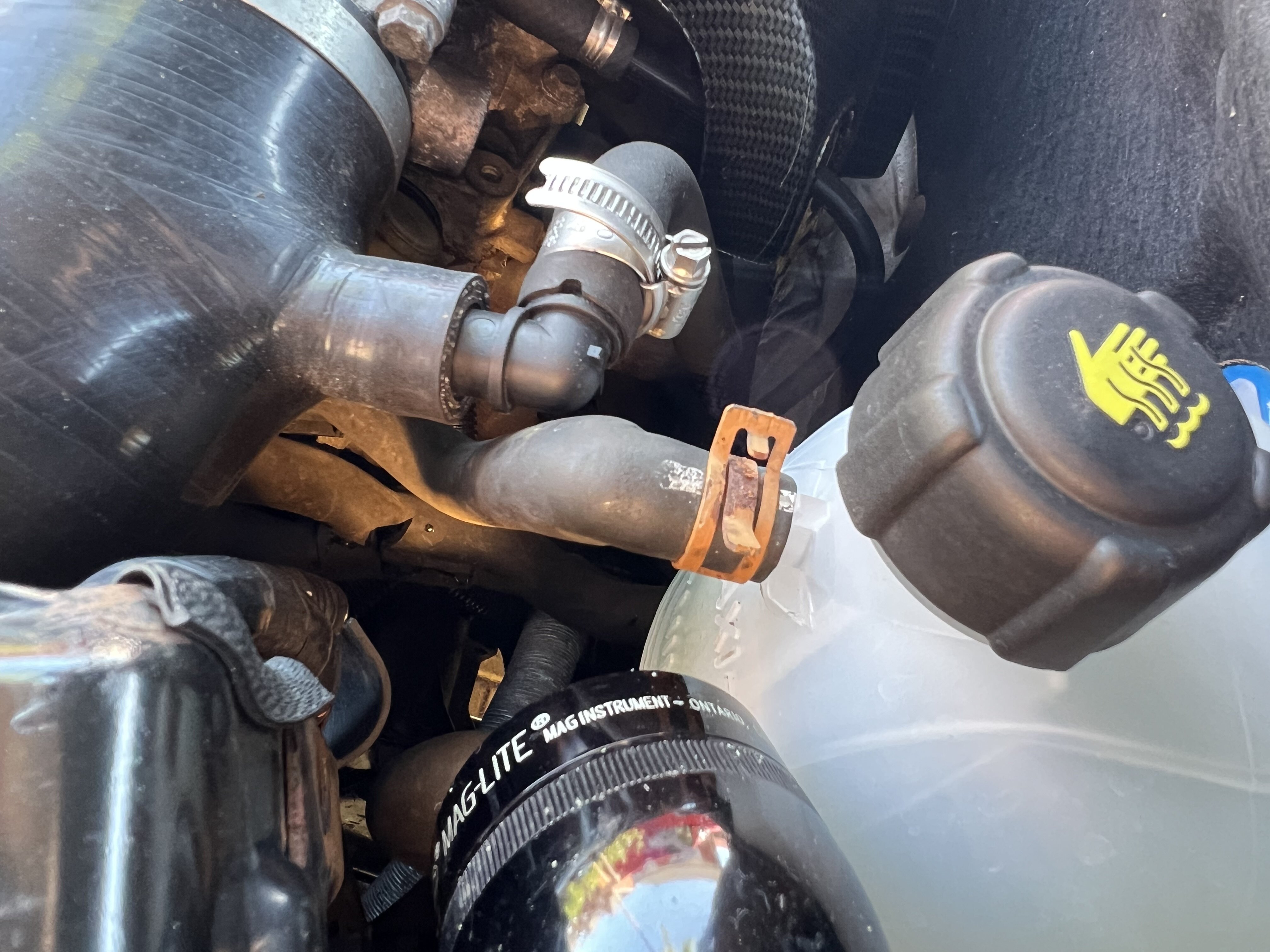

Hi Matt having the same issue with Florence so I'm considering whipping the heater out which does not fill me with happiness given the heat outside. I got the top hose off with brutality and tried the same route with the bottom hose but to no avail.
Advikaz
I just snipped the metal clips and pulled it off from memory
Sorry pal I haven’t even made a start on mine but there is some good advice already in here 👍
  Clio2 1.2 8valve
Got the lower hose off now, once again with brutality. Sized up the hose on the coupler and it looks like it could okay. Thanks for your help, Florence is just an awkward customer but at least the heater can stay in situ. Result!!
