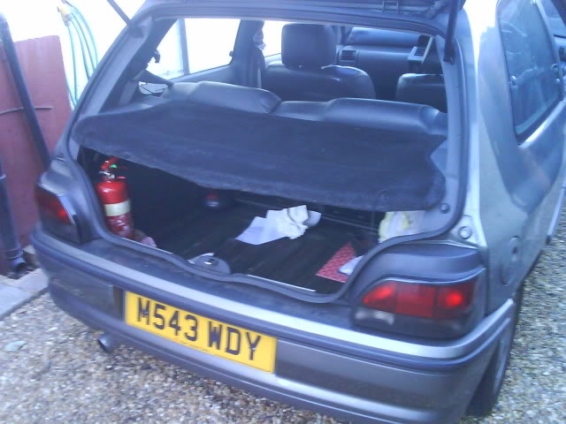

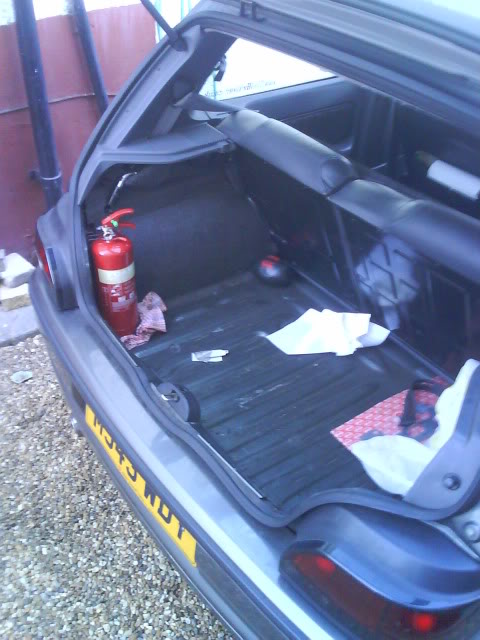

New addition to the boot today:
Paddy_g46

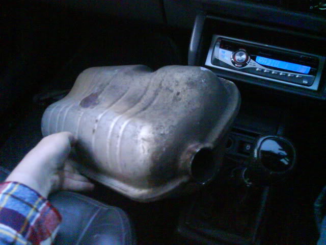

Bad weekend, on the way to Birmingham on the M40 my backbox decided to crack at the weld and drop off, this couple with a straight through exhaust made for a VERY loud trip back today and my ears are no very sore :(
