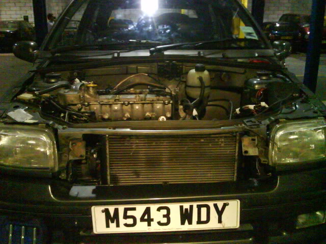

patrick you need to move the header tank, the bonnet wont close were it is now;)
Lol cheers ill have a look for a lower place to mount it, have you got any pics of the underside of the bonnet?
Also I have raise the left and right engine mounts by 5mm with washers (so the engine now sits 5mm higher than it would have done), is this going to cause problems?
it may do but no way of testing till you have a go, why did you raise it
ill take a pic of my bonnet tomorrow for you, mine clears everything just needs abit more work to make sure its perfect

I did it to make the flange on the exhaust manifold sit in a slightly better position, although once I sort my downpipe I might realise I can remove them.
I am thinking I may have to raise the bonnet mounts to allow it to close without touching!

good idea with the washers i could so with mine being higher so the downpipe clears the arb easier.
there is a little play in the bonnet hinges you should be ok

You will need to modify the battery tray if you want to do it, the 2 washers go flat under it but then the 2 vertical bol holes need elongating and large washers used, very easy though, took me 10 mins!
Then on the other side you just need 1 washer and put it on the stud before you drop the engine onto it. Simples.
