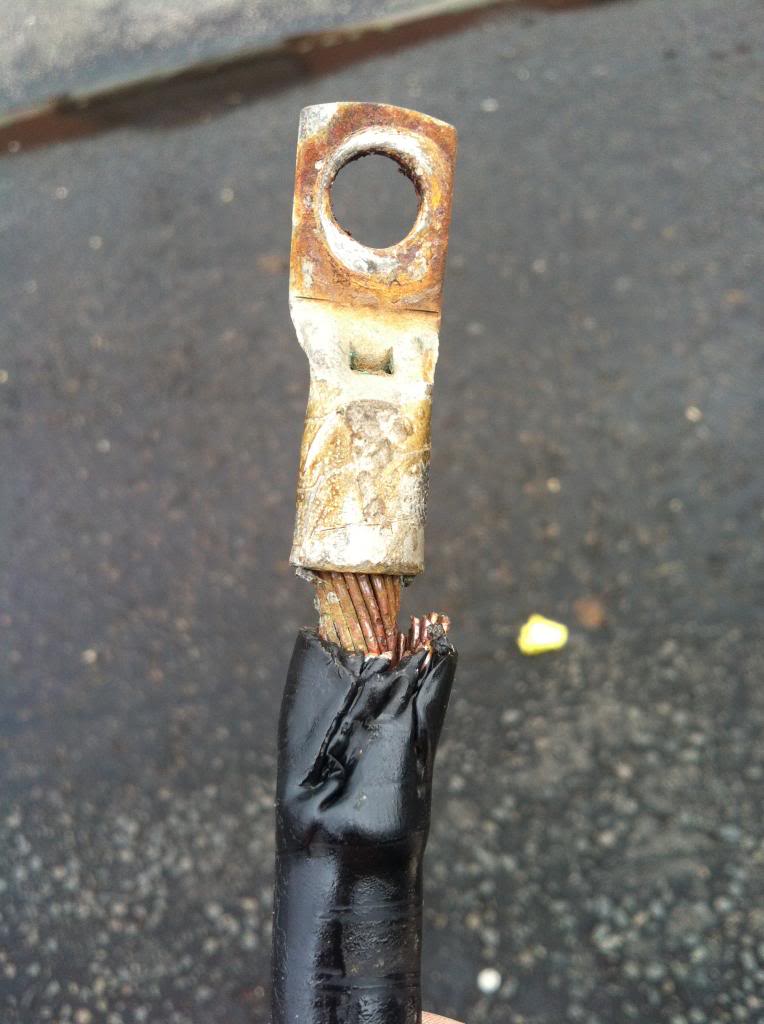

Check the earth strap from the gearbox to the chassis, my Exclusive was doing the exact same
thing for months along with other small issues, this is what i found on inspection;
