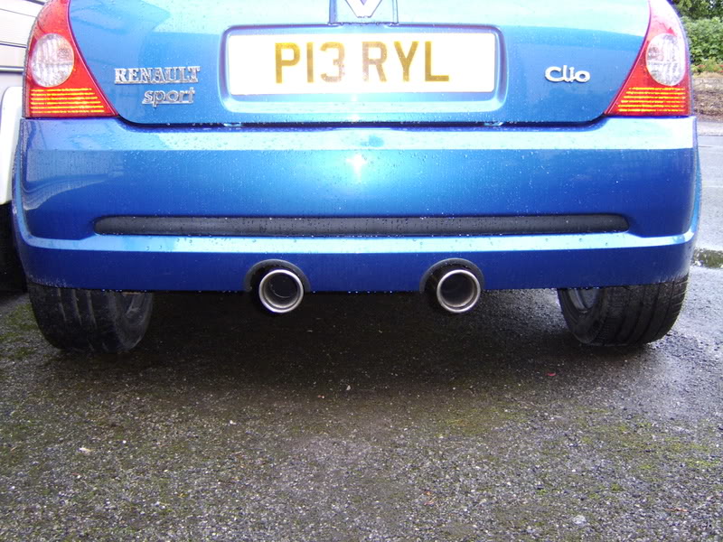

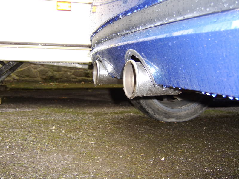

Hangs slightly to the right ATM, so im goona cut some pipe and fudge the Mounts so it sits right.
snap mate just had same fitted to mine today wot a noise , mine sits perfect through

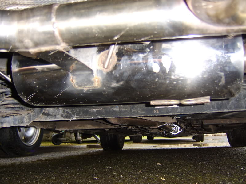

Fitted it at my mates garage earlier on today, dropped the rear beam to take the old one out in 1, now that was a pain to get back in. I had to drop the car to the floor to get the dampers back on.

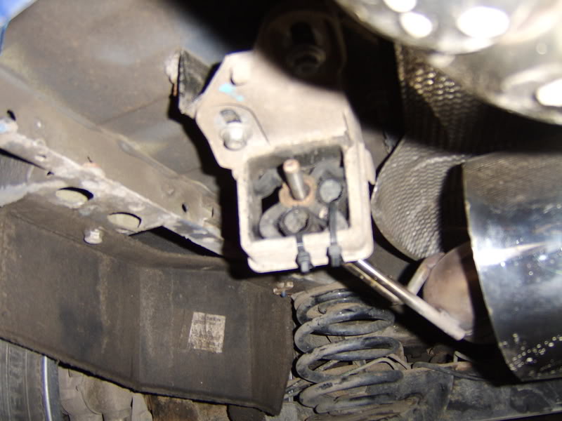

Only took bout 30mins to do the whole job, Fitted some Plastic pipe to the Exhaust mount to try and straighten it up. Worked ok i think.

if the scorpion decat doesn't have the correct bend (90% of the decats don't have the bend in them) then that will cause the tailpipes to sit off to one side
^^^ I noticed my blueflame decat has no bend in it and now the tail pipes look different.
Come to think about it now. i did put the de-cat in with it pointing slightly to the left, which now i think would push the tailpipes to the right.
DOH!!

My bodge at trying to get the exhaust more in the middle.
Think im gonna have to get it up on the ramps and undo the mounts to try and get it to sit right.
Another job for the weekend.
thats the decat pipe (non YS) causing that, seen it loads of times, try slackening off the spring bolts slightly
I'll gove it a go at the weekend, and post the results up.
Hope i can get it to sit right, just looks crap ATM.
mine sits a little further in than urs mate miye be u prob as mine sits very straight and i have not touched me mounts either
