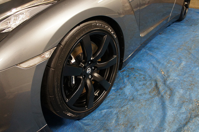

I dealt with the wheels, arches and tyres first.
Before - not too bad really!
DSC03022 by RussZS, on Flickr

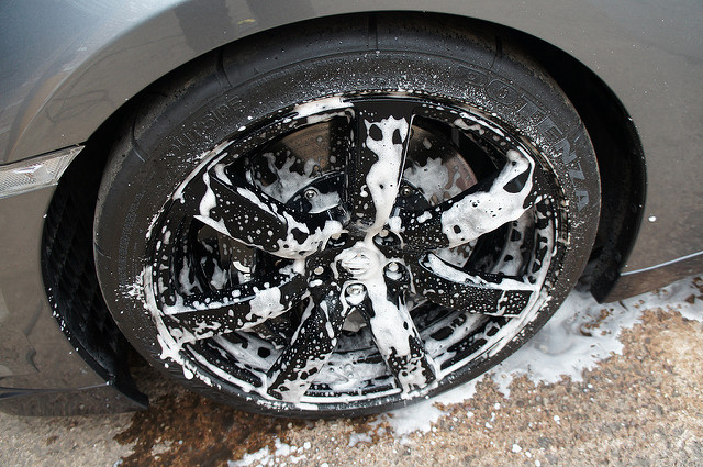

AutoSmart Smart Wheels used at 10:1 with various brushes:
DSC03023 by RussZS, on Flickr
DSC03024 by RussZS, on Flickr
DSC03025 by RussZS, on Flickr
AutoSmart G101 used on tyres and arches:
DSC03026 by RussZS, on Flickr
Vikan Arch brush:
DSC03027 by RussZS, on Flickr
and pressure rinsed:
DSC03028 by RussZS, on Flickr

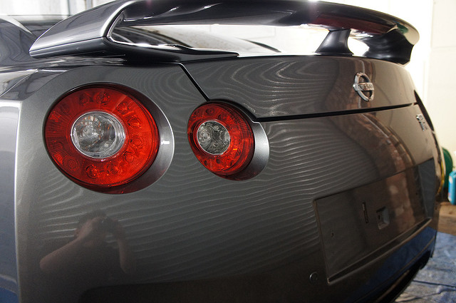

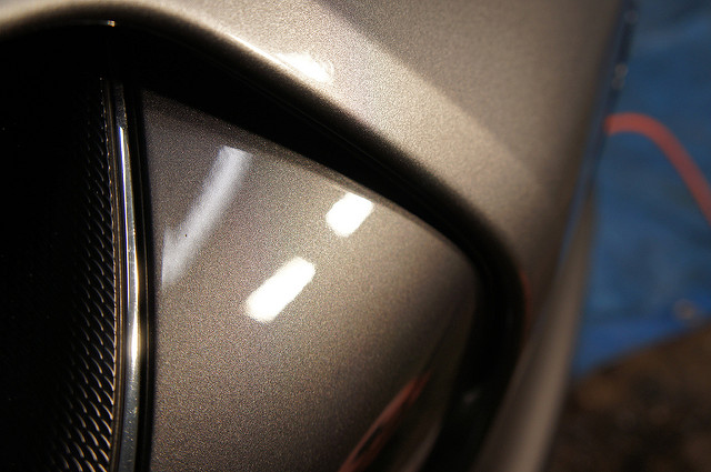

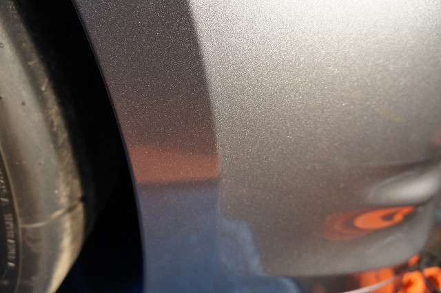

After drying the paint was assessed for thickness, then various combinations, starting with the 'lightest' were tested to see which would achieve a good level of correction within the single day timeframe I had the car.
Average paint readings were around the 170 mark:
DSC03044 by RussZS, on Flickr
Defect wise the car had very light swirling probably induced from a few poor washes during its life, and a few deeper scratches.
Correction wise I settled for Megs 205 on a 3M Polishing Pad, stepping up to 205 and a Megs Cutting pad on the deeper defects:
50/50:
DSC03039 by RussZS, on Flickr
DSC03041 by RussZS, on Flickr
DSC03046 by RussZS, on Flickr
Before:
DSC03048 by RussZS, on Flickr
After:
DSC03049 by RussZS, on Flickr
DSC03051 by RussZS, on Flickr
DSC03056 by RussZS, on Flickr
DSC03058 by RussZS, on Flickr
RDS:
DSC03064 by RussZS, on Flickr
After (still there but rounded off so not nearly as visible)
DSC03067 by RussZS, on Flickr

The wheels were protected with Auto Finesse Mint Rims, which leaves a superb finish on matte wheels:
DSC03074 by RussZS, on Flickr

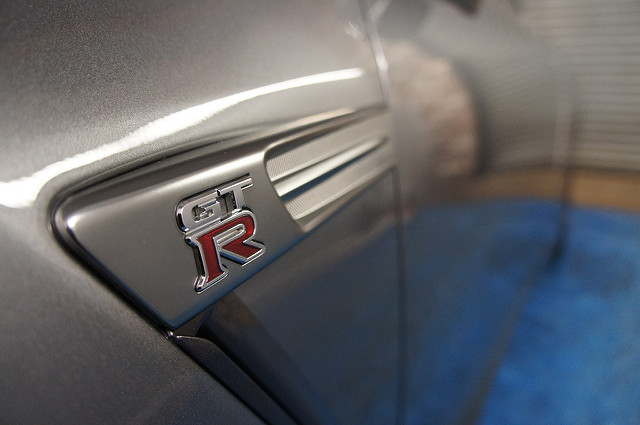

I finished with a layer of Z8...
DSC03079 by RussZS, on Flickr
DSC03080 by RussZS, on Flickr
