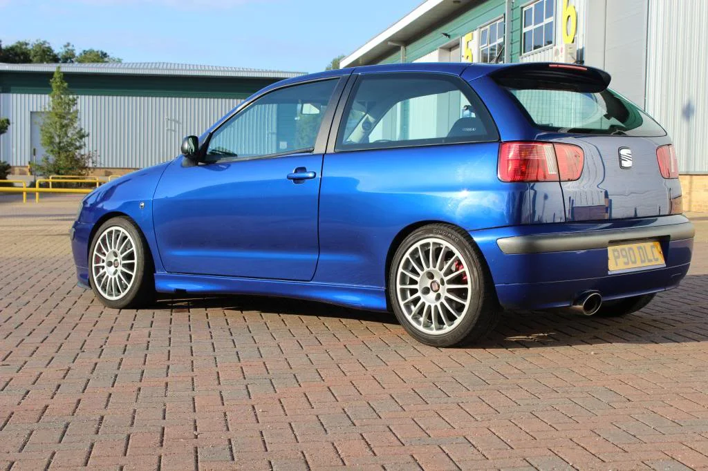

Few pics of my old track toy
quick spec - forged engine 300bhp 310ft, AP racing brakes, B16s, custom wide track, custom manual steering conversion, carbon bonnet, LSD fully stripped.

Cool love the Ibiza that was my second Ibiza running K04 :)

Yeah I must admit my mates had the legs in terms of speed/acceleration as the Ibiza 1.8t is a lot more tuneable as we all know but on the twisties they'd all happily admit my 172 at the time won hands down.
A mate of mine still has one the same colour as your old one, Dave Martin from Birmingham don't know if you know him?
What setup were you running on the Ibiza exactly?

Too much to list lol
rough spec
Rebuilt Forged conrod engine, BAM k04 turbo, 5 bar fuel pump, 4 bar injectors and FPR, 3inch turbo intake, 63mm intercooler piping, massive intercooler, mocal oil cooler, 3inch decat exhaust. Stealth racing track based map
suspension wise, mk3 golf wide track front end, mix of Vibra technic and solid bushes and mountings, Neuspeed arbs front and back, Bilstein B16 coilies, mk2 golf non pas rack, corrado G60 AP racing 4 pots bells and rotors kit.
LSD was the best mod I did :)
