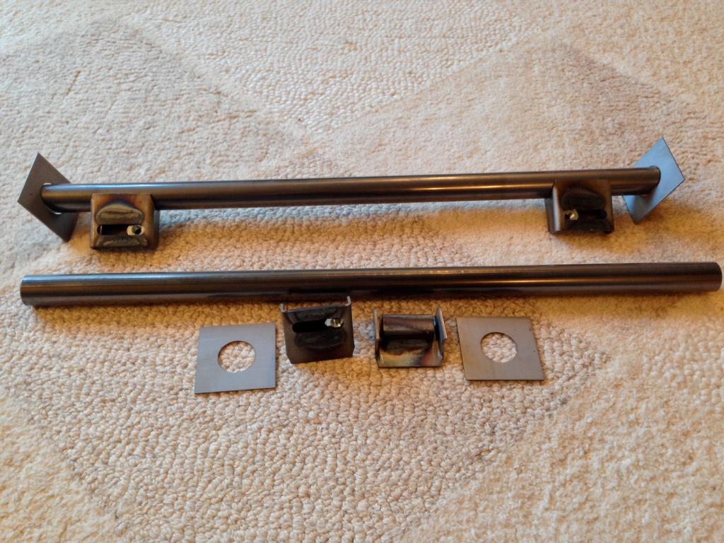

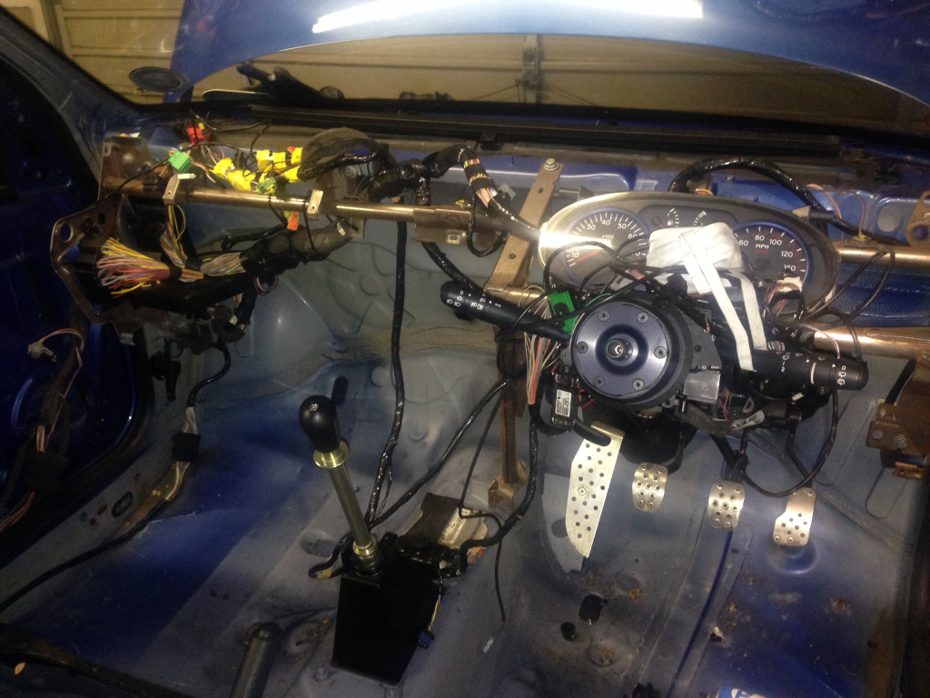

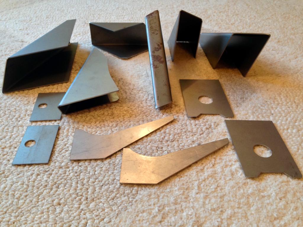

As far as I'm aware they all do aswell! As you can see the door bars are still duck taped to the diagonal bar so I'd guess they won't give much protection being there. When I get round to actually fitting the cage I might weld them in the right place and use the platform plates I got in nicely packaged box that's not pictured. :rasp:
Did you get spreader plates or platforms? There doesn't look much room for platforms.

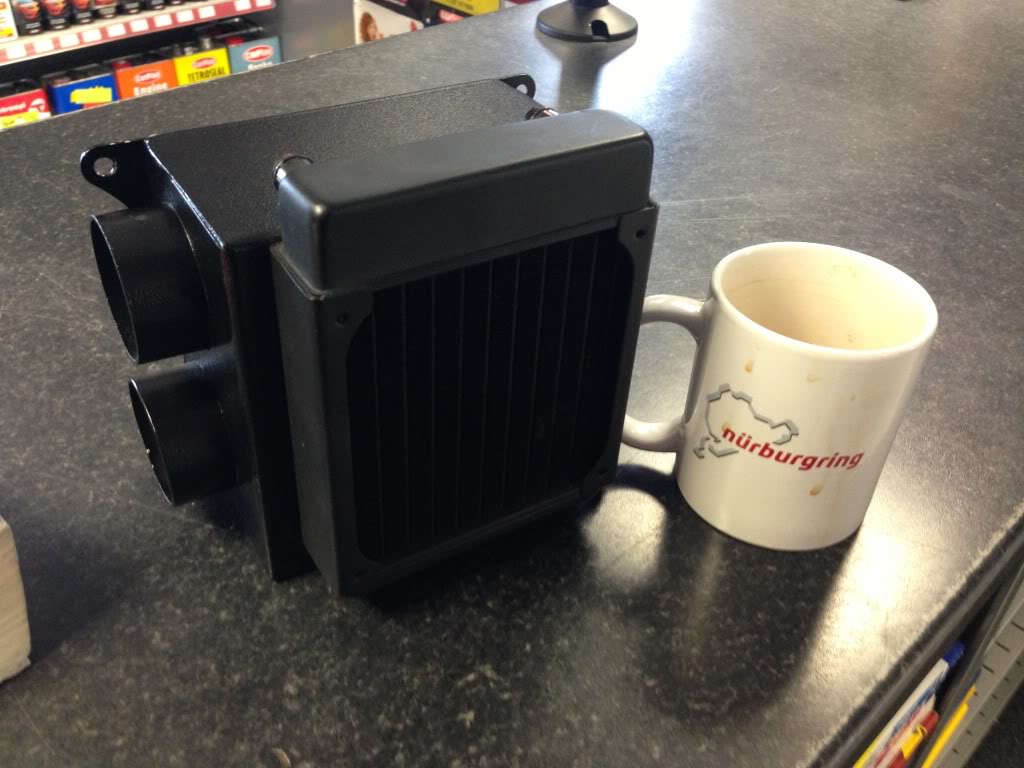

Ordered another one of these to keep me warm

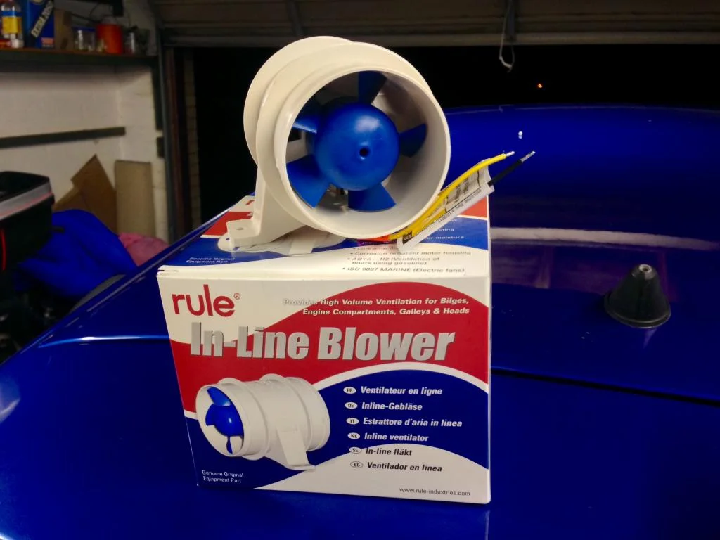

One of these to keep me cool :smile:
Standard heater system weighs far to much.

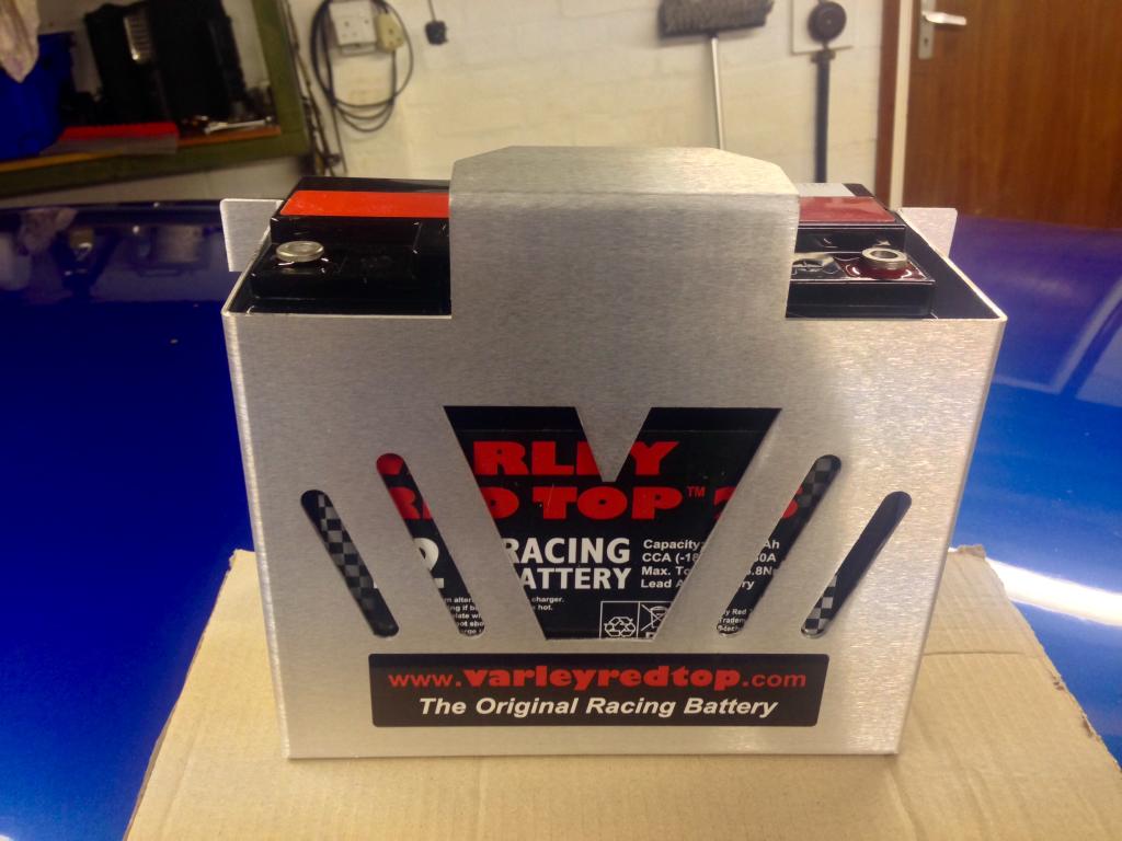

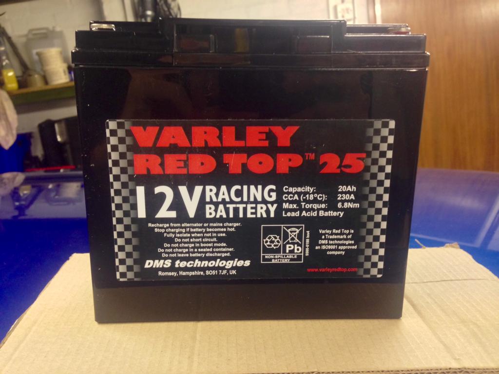

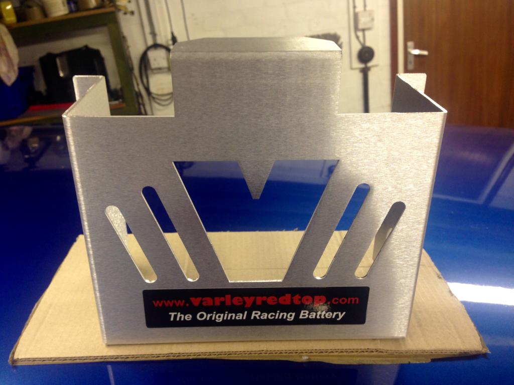

So does the battery so ordered a Varley Redtop 25 and mounting cage

Got this to from tweaks to help relocate the battery

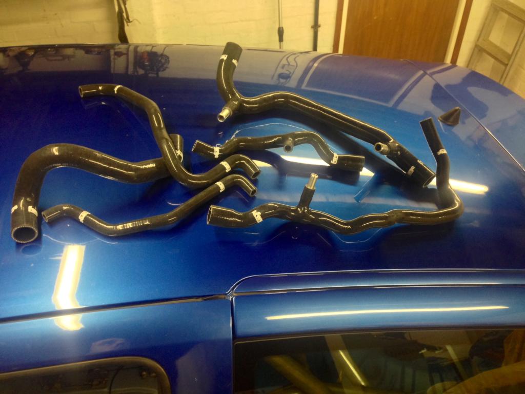

Hoses are looking worse for wear too. Turns out forge make a nice set for the little Frenchy

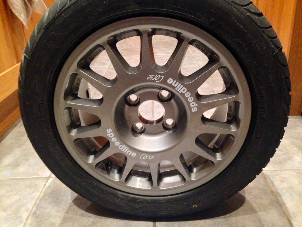

Will probably put the orgrinal CUP wheels up for sale. Are they worth anything tho? I have no idea lol
They have decent uni royal rainsport 2 tyres on iirc

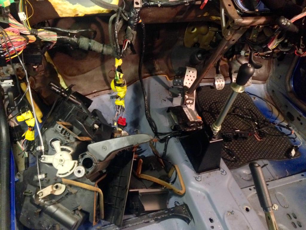

Little bit of work from Saturday night. Sorry for the poor pics lol
took the back half of the cage back out

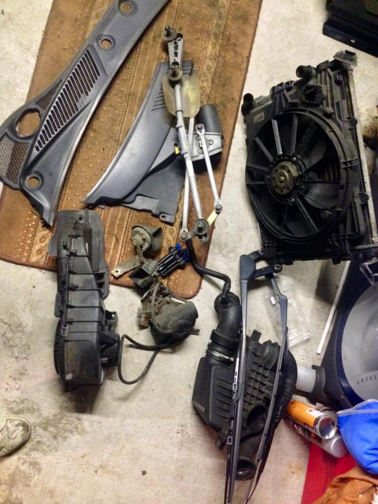

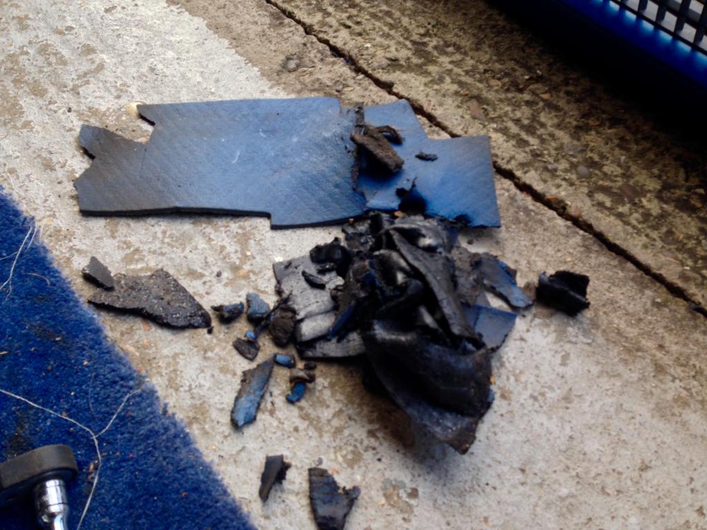

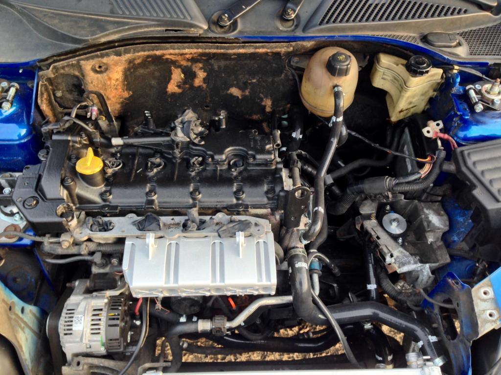

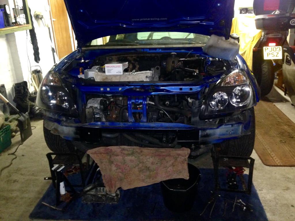

Then removed everything under the scuttle panel along with the radiator, horns and the intake valve thingy

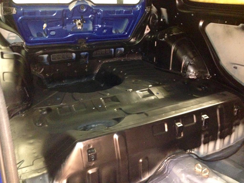

Found aload more sound Deading so removed all that
Destroyed the heater box getting that out. Was feeling the effect of alcohol by this point tho lol
All so removed all the brown sound proofing aswell.
Hoping to get the loom tidied up and get some of the new bits fitted :smile:

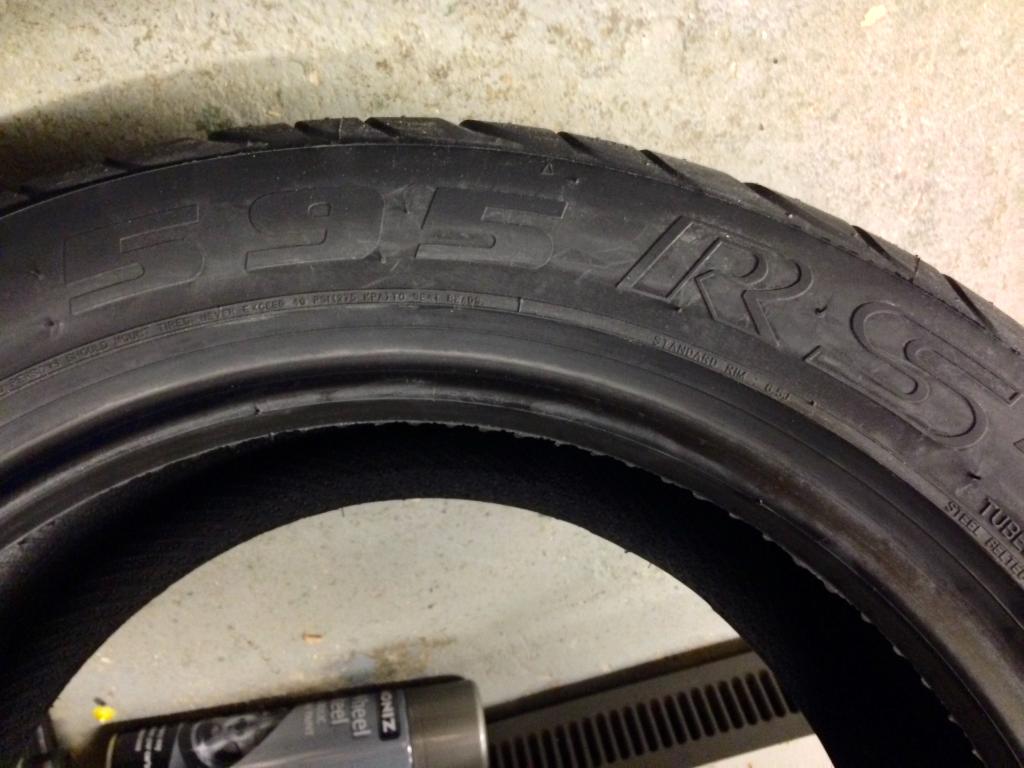

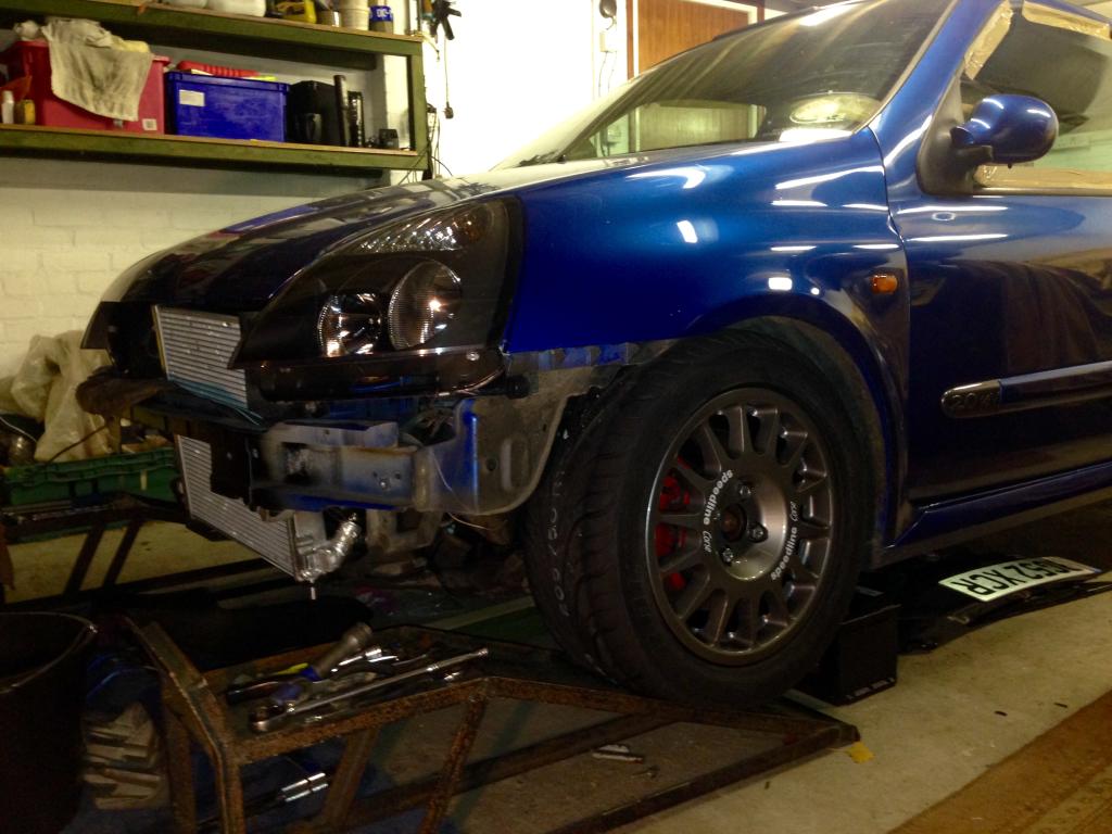

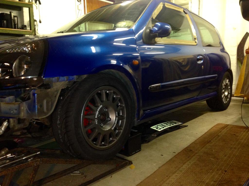

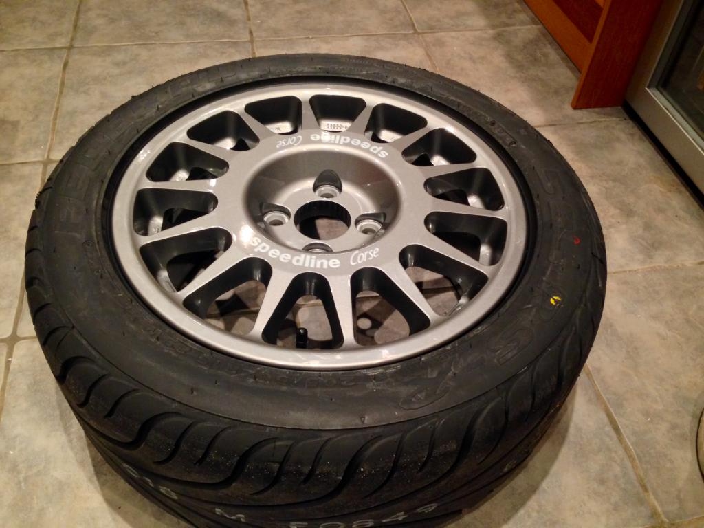

Fitted the wheels tonight :) only to find the front tyres are resting on the Coilovers :( can't even turn the wheels :( spacers are required lol
But I have a set of Turinis to get rid of now with 4 decent uniroyal rainsport2

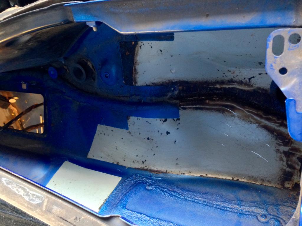

Paint inside abit. Only to tidy it up abit.

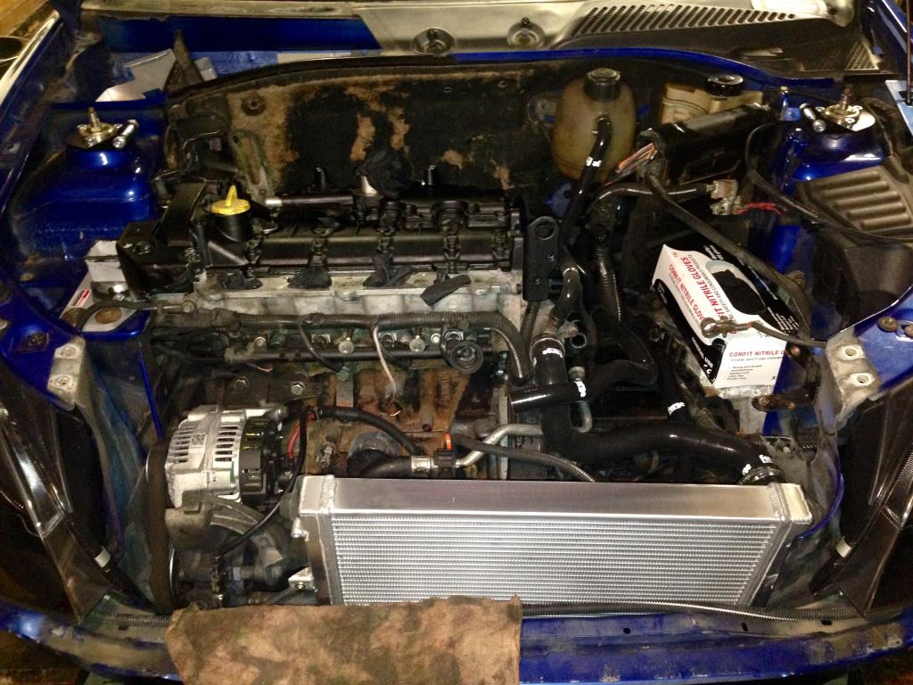

Also started putting the coolant hoses on and I dropped the rad into place.

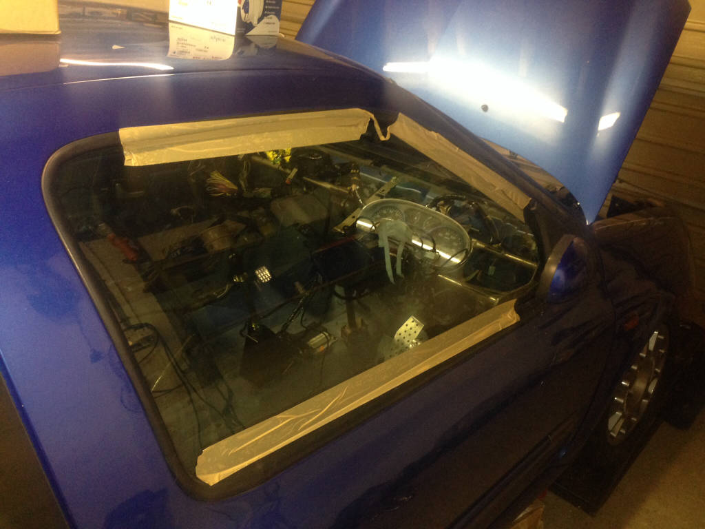

Did a small amount tonight

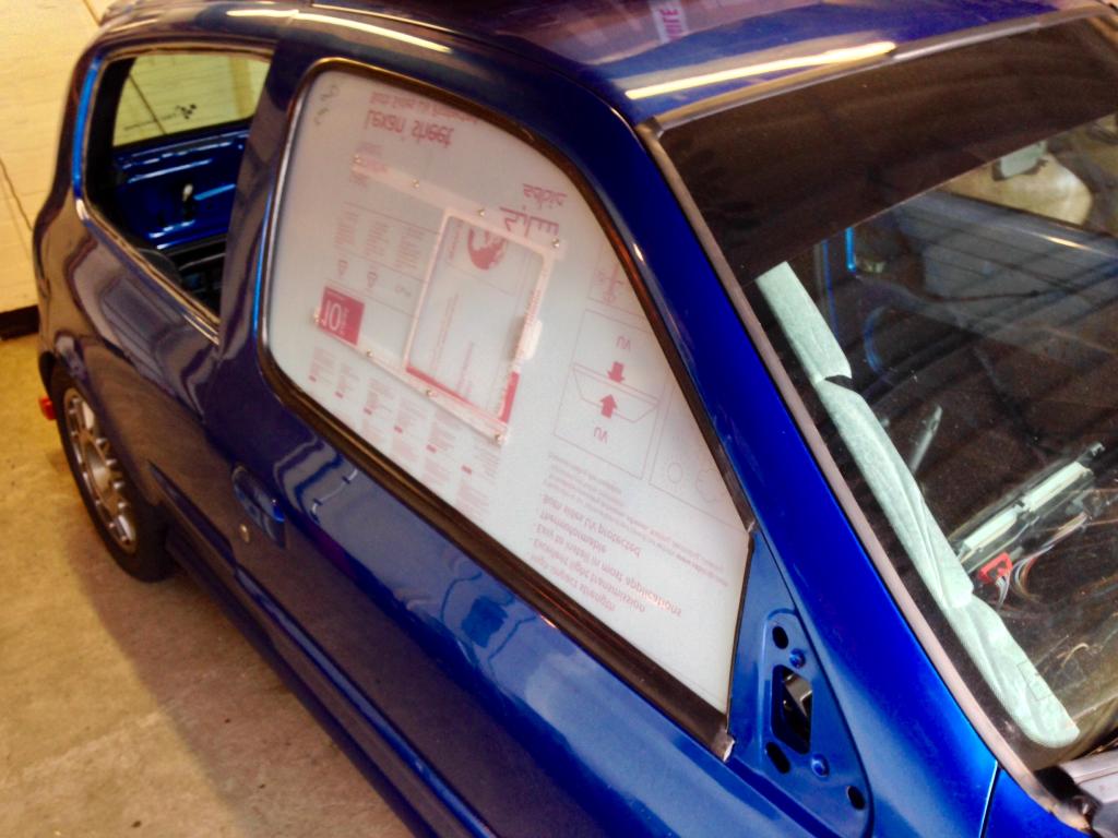

Taped the windows up so I can paint the front of the cabin.
Started making the coolant lines to the heater
And started moving the loom out the way. Have decided what to do with all the excess wire, wanna go standalone ecu with a custom bare essentials loom.

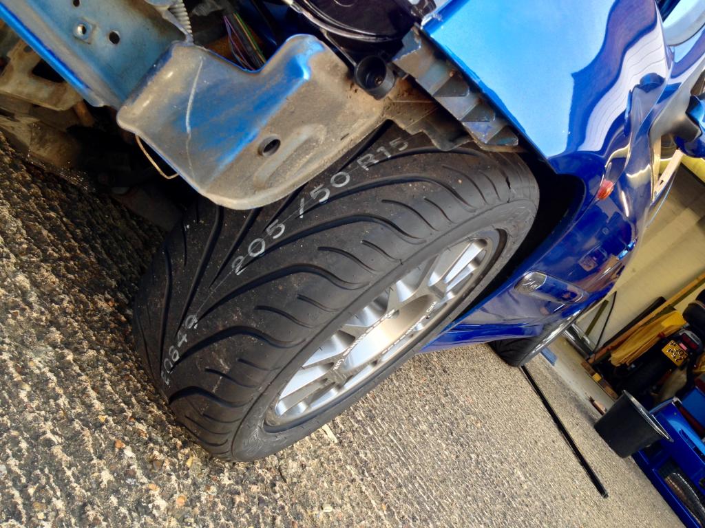

Reduce some of the camber mate, are the tyres 195s?
Defo need to reduce some camber. There 205 tyres :(

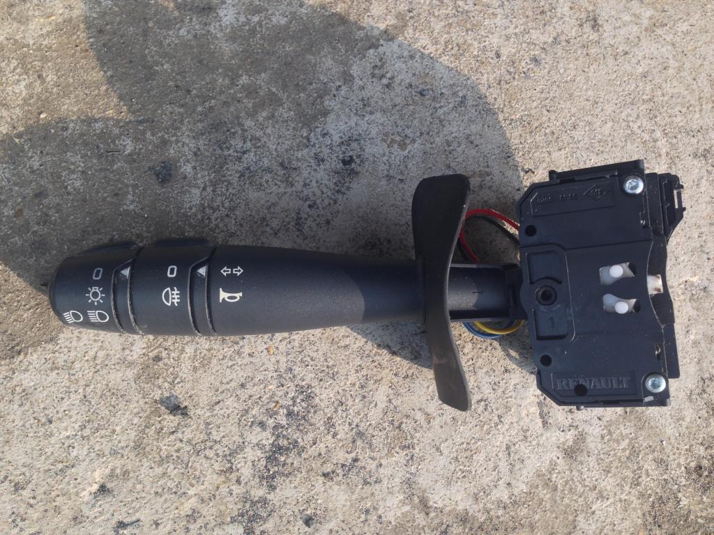

First is a ph1 clio indicator stalk to use the horn switch
Is this a straight swop and will the horn work straight off from plugging it in lol

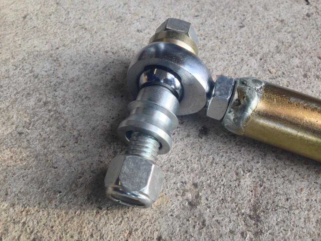

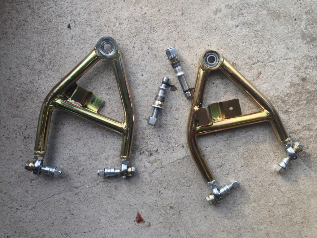

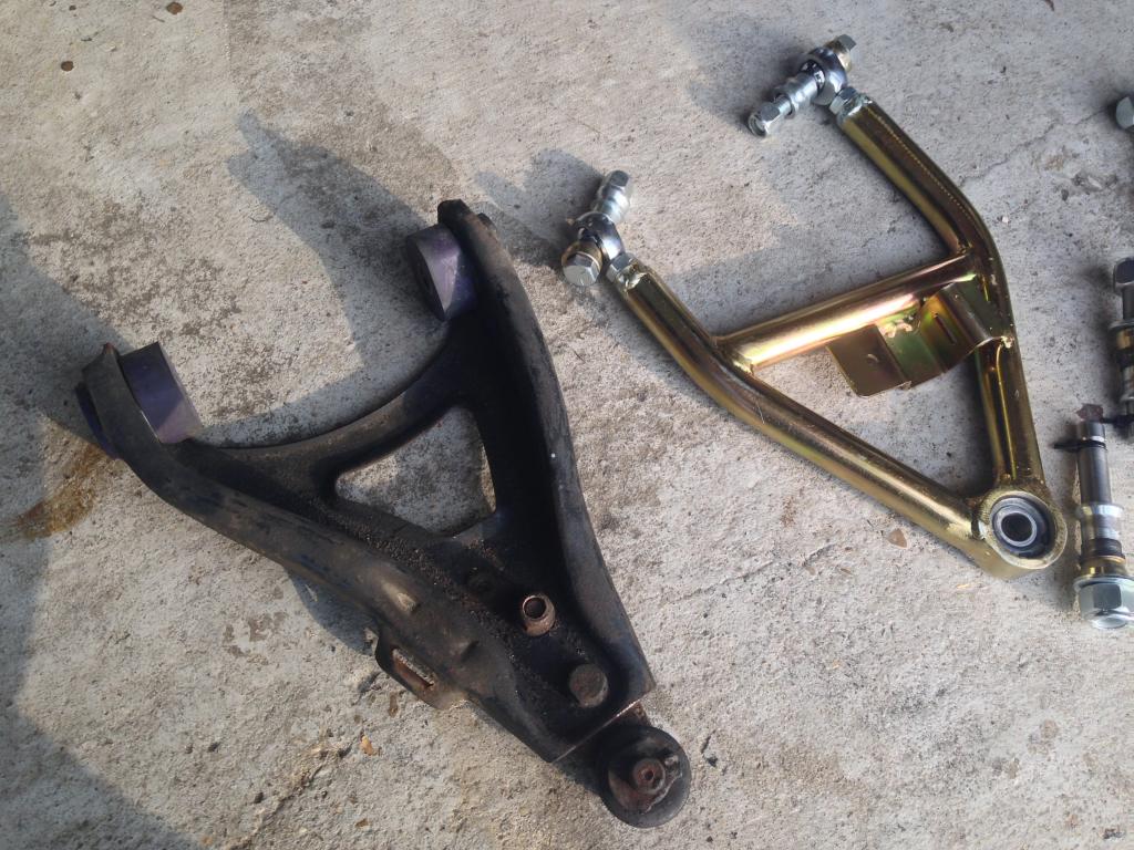

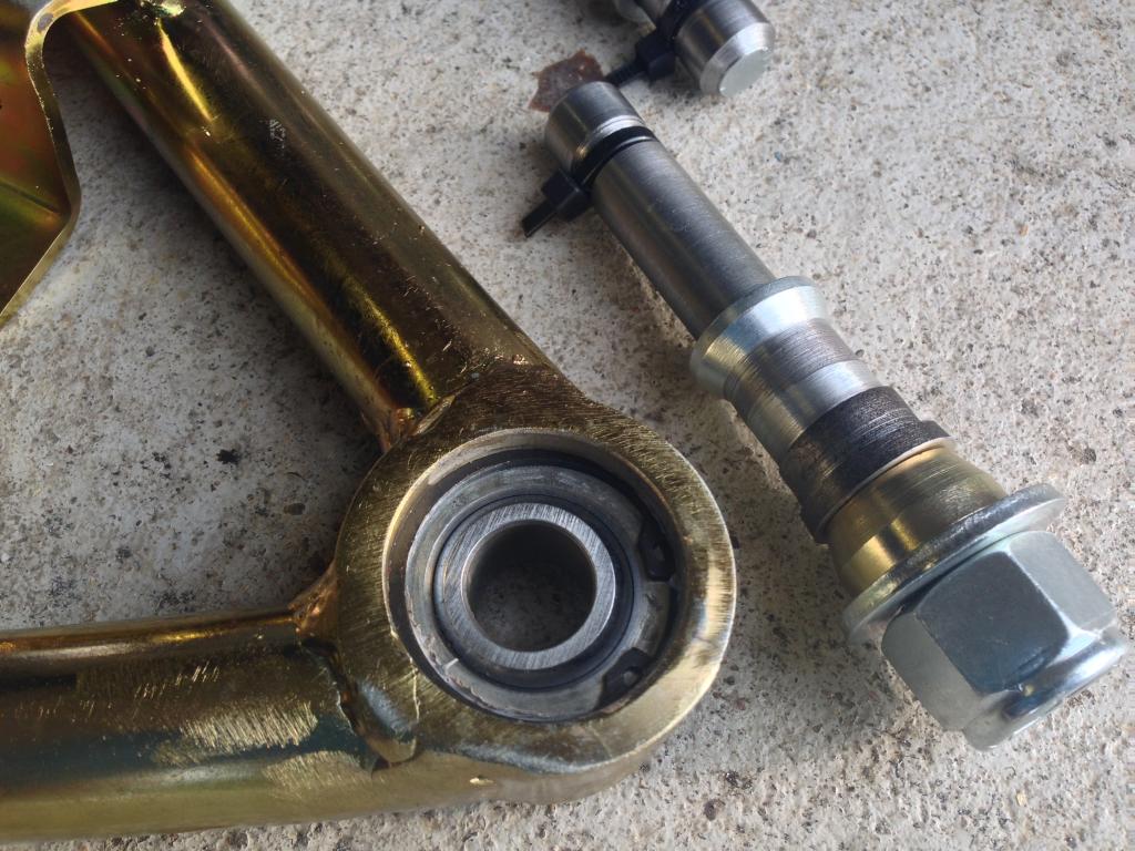

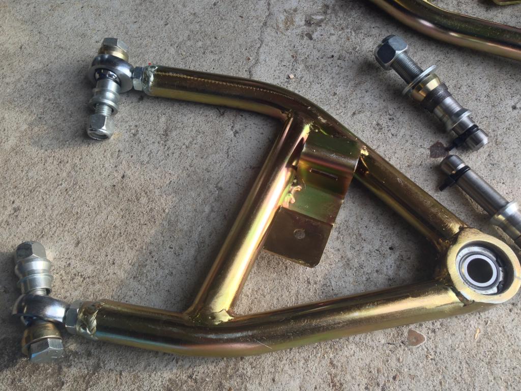

and thought I'd try these arms
Anyone got any experience with them?
Ive found the 2 bolts that go through the subframe are slightly too big so will need to drill or file the bolt holes in the subframe to take the new bolt.
This bolt
Who makes these and where did you get them. Have they performed well?.

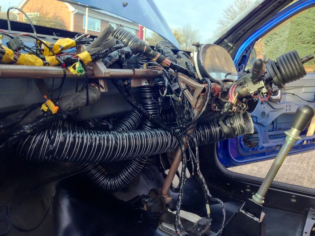

Pulled the little cup out the garage over the weekend to take few pics and do a bit of work.
I started by losing abut of camber so the tyres cleared the shocks nicely.

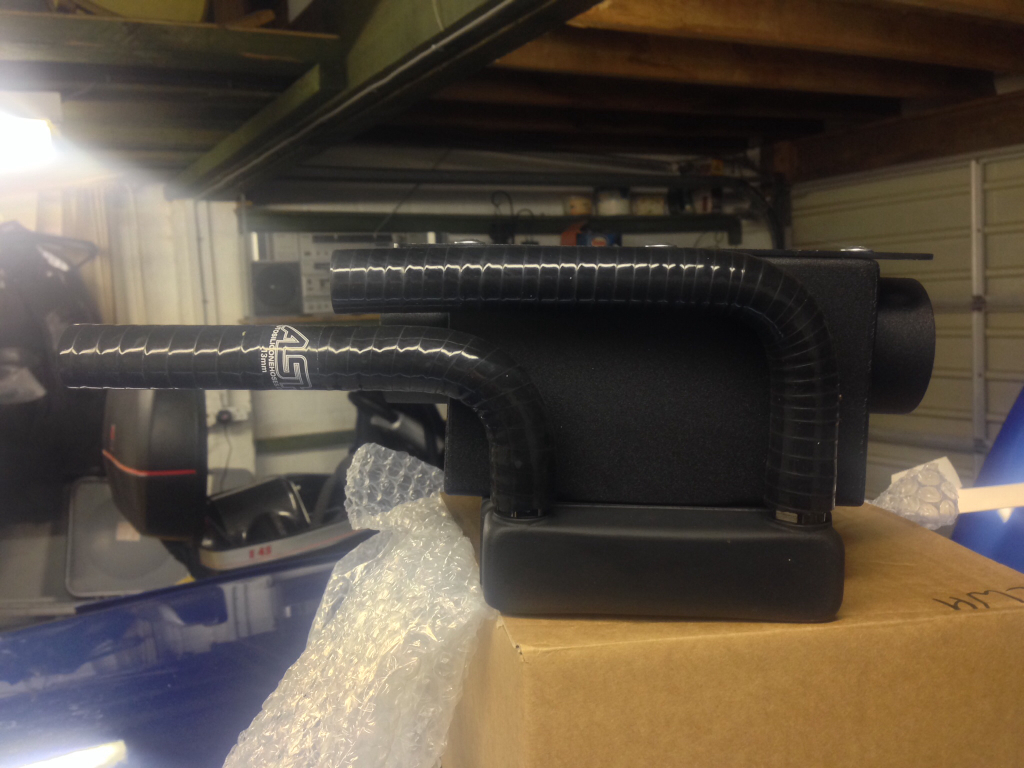

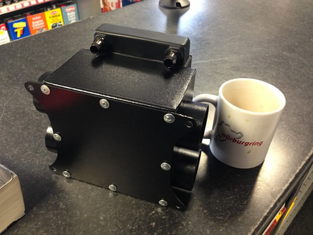

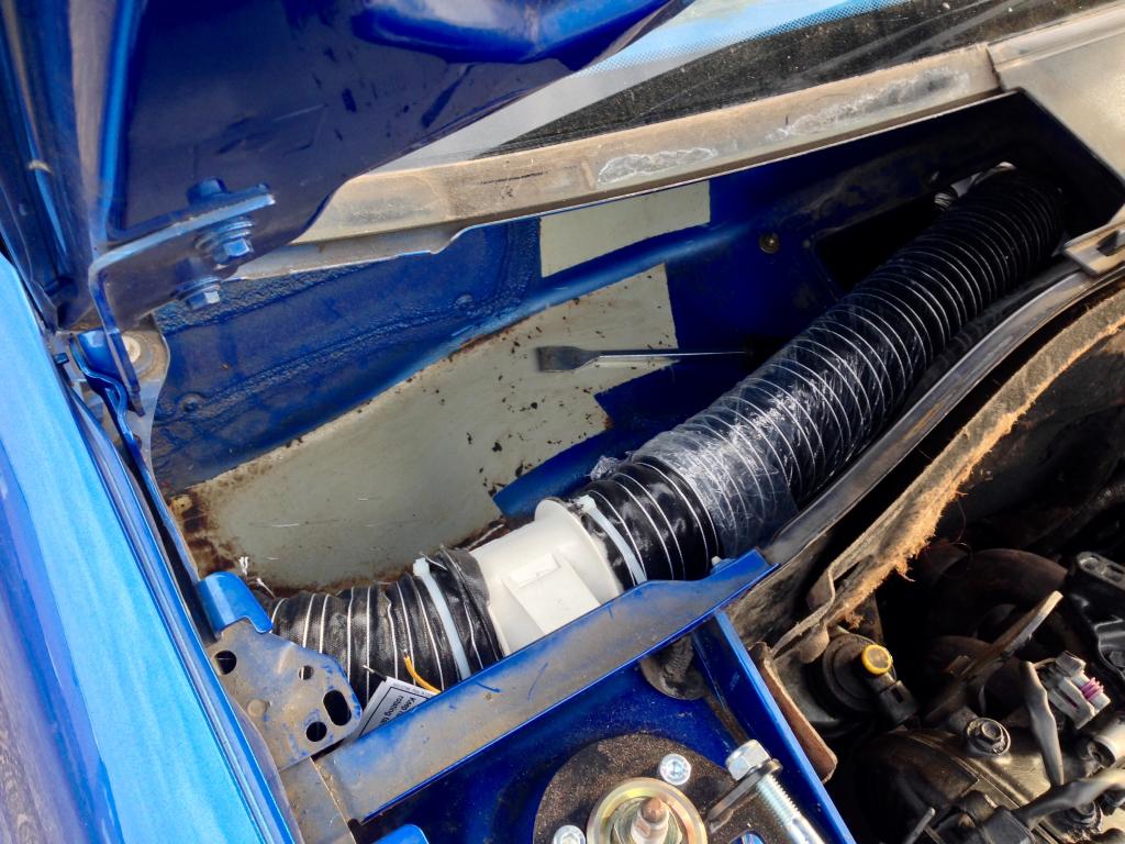

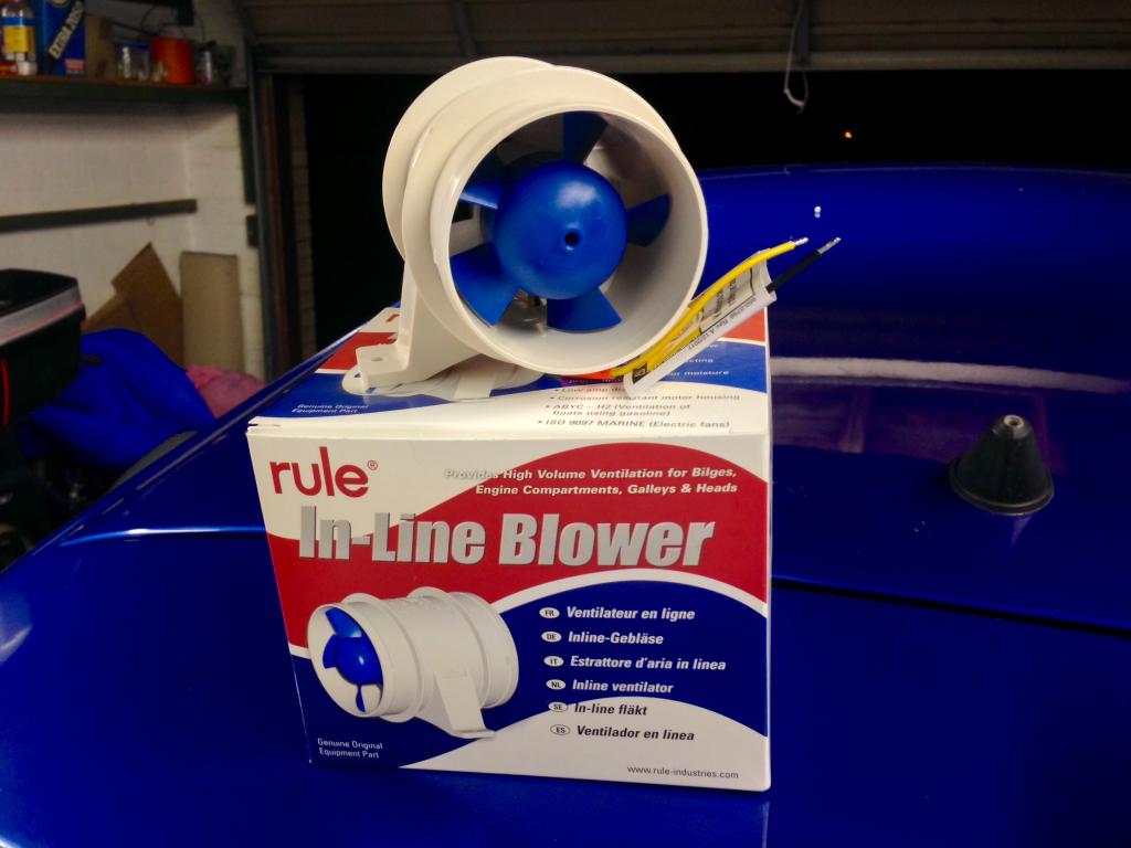

I then fitted my blower fan under the scuttle pan and fitted the T7 heater and ran all the ducting.
Also secured the clocks in place

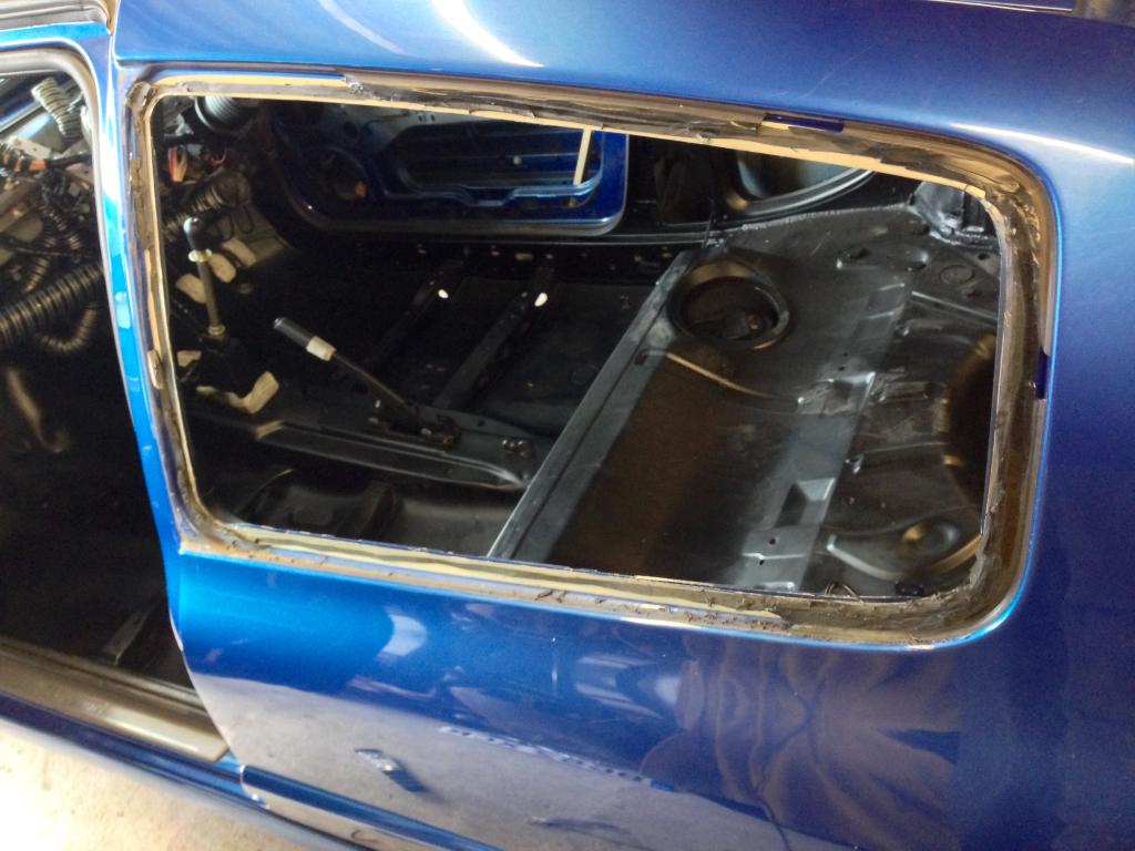

The moved on to removing the windows and I trail fitted one of the fronts.

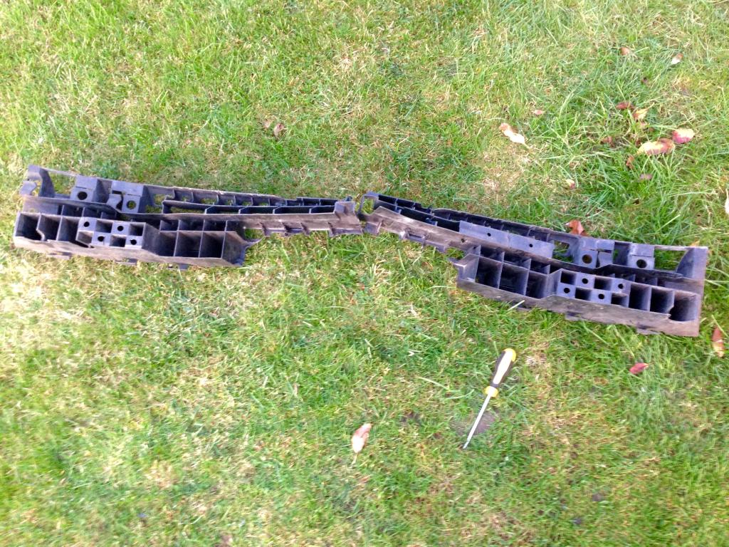

Removed some plastic rubbish from the front bumper in between times
Still got lots to do, just had to tax the thing as well.

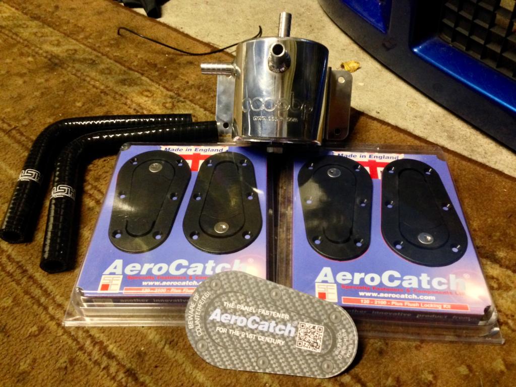

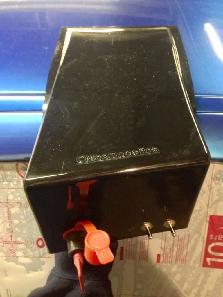

Few more parts I've got.

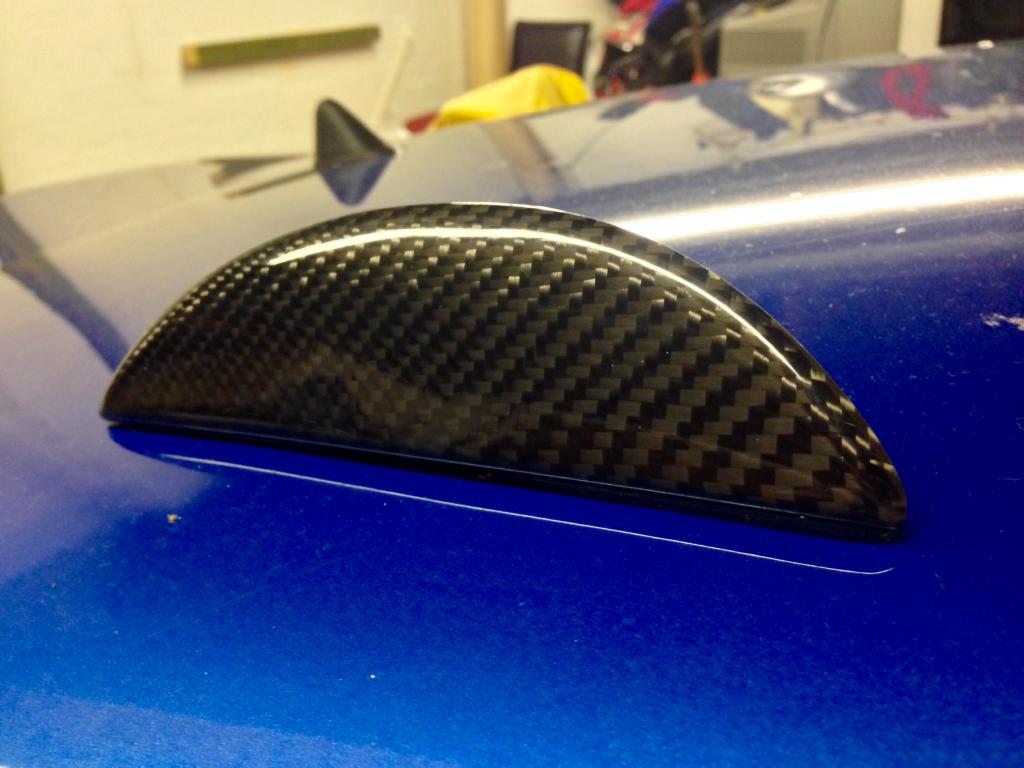

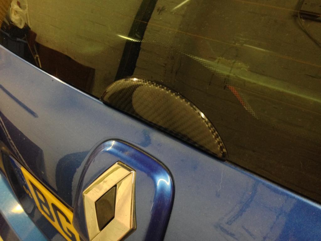

Carbon wiper blank

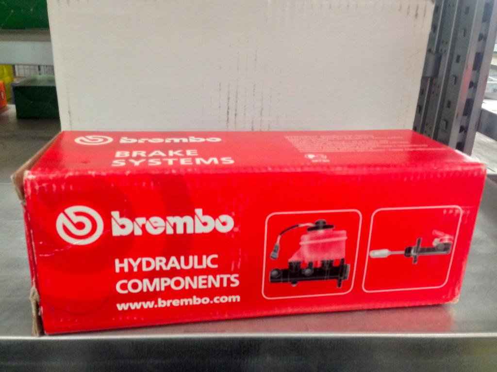

Also have a a 406 V6Coupe brembo master Cylinder that I may have to replace mine with ;)

I managed to sort the wiring on the drivers side but still have the passenger side to tackle! Any tips??
I just feed it through the inner wing, think I used a bit of copper brake pipe to feed it right through as it was a tighter space
My earth points for the rear lights only just reach.
I can take pics tomoz night if I'm in the garage if that will help bud.
My issues was the passenger side loom splits into 3 so I would need to unplug the loom in the boot lid, bumper light and light cluster. The only issue I have with that is feeding it back round the boot after re-routing but hopefully will manage this if I pull a cable through when pulling it out. I think that's the better option rather than cutting anything.
Any photos of the entry and exit points would be good though to give me some ideas. Thanks.

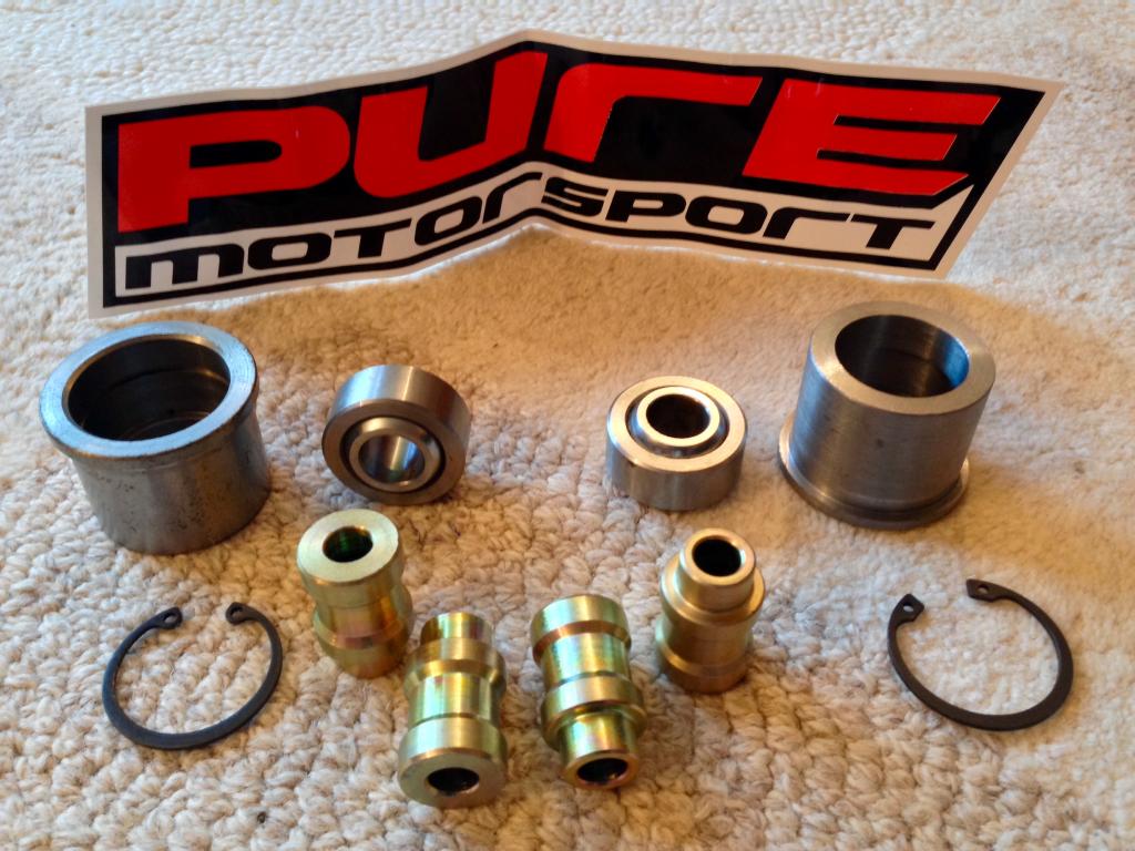

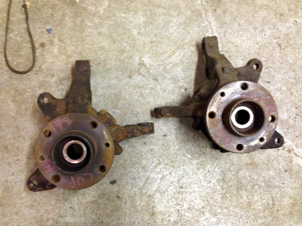

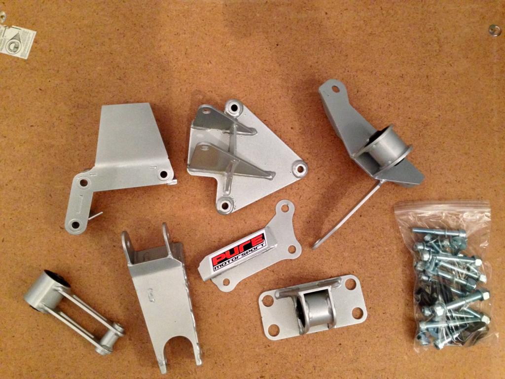

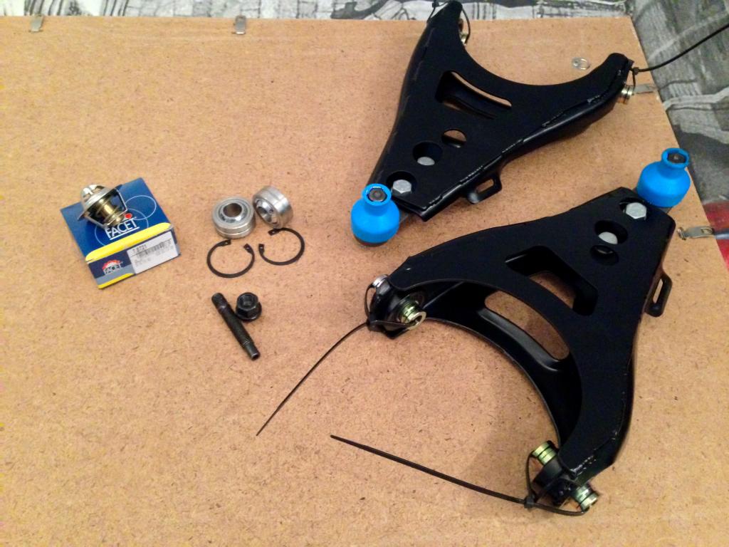

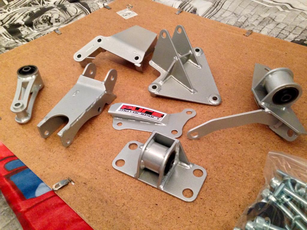

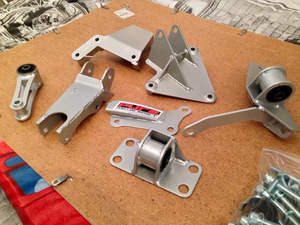

Haven't seen the clio for little while, but a had a delivery from PMS.
So we have the Comp engine mounts, strengthened wishbones with bearing conversion and weather seals, low temp stat, stud n nut conversion and the preloaded top mount bearings :)
Should make a nice addition and work well with the roll centre hubs from the group buy. Can't wait to get them so I can get it rolling :)
Will update as the parts go on.
